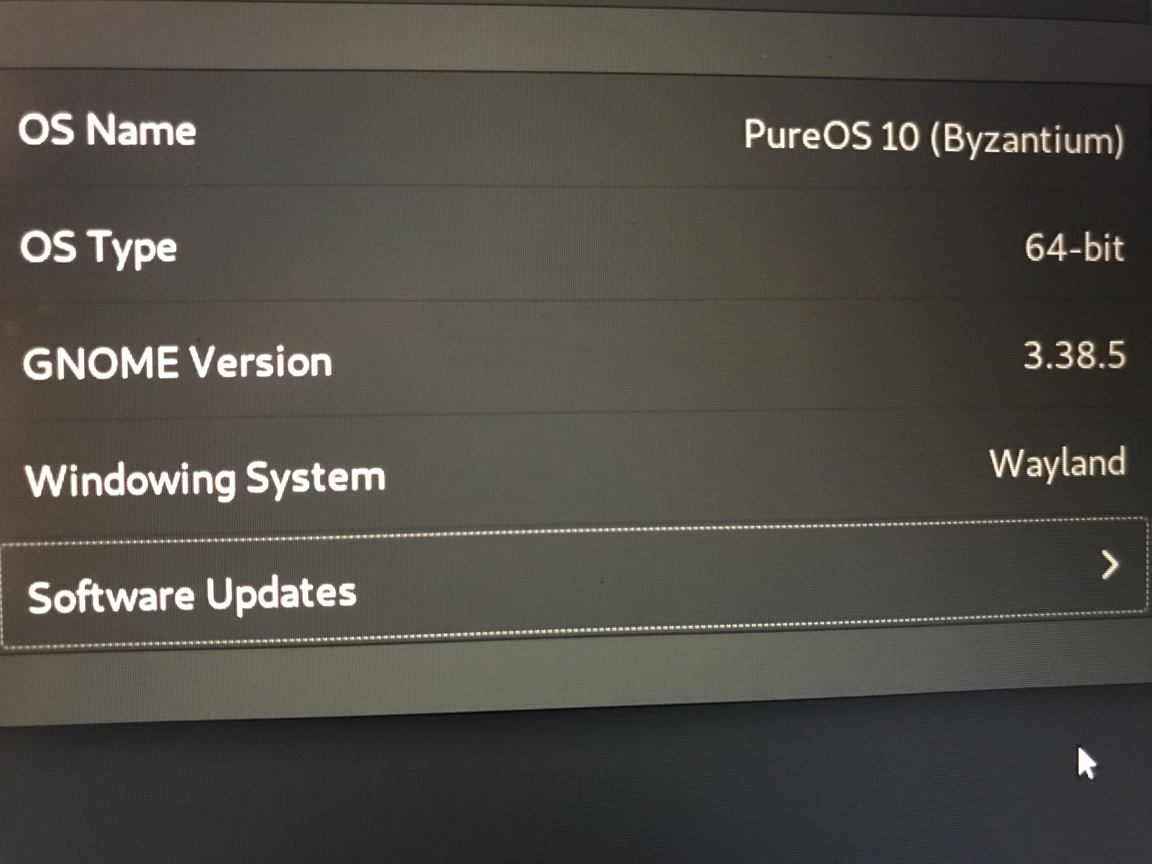

Librem 14 2022 PureOS 10 (Byzantium) just like that without update or any physical damage or even moving it, stopped connecting to the internet!!! It connects to the wifi and the icon shows the bars but i can’t actually access the internet. After restarting and resetting my router, i realized that my cell phone and another laptop are online just fine. What happened to my laptop?? Any ideas?
I restarted it several times and was able to update and upgrade in terminal. Also installed an update that required restart in an attempt to fix the issue but to no avail. Seems it downloads updates but web sites, Thunderbird and Telegram - user side apps don’t get internet.
