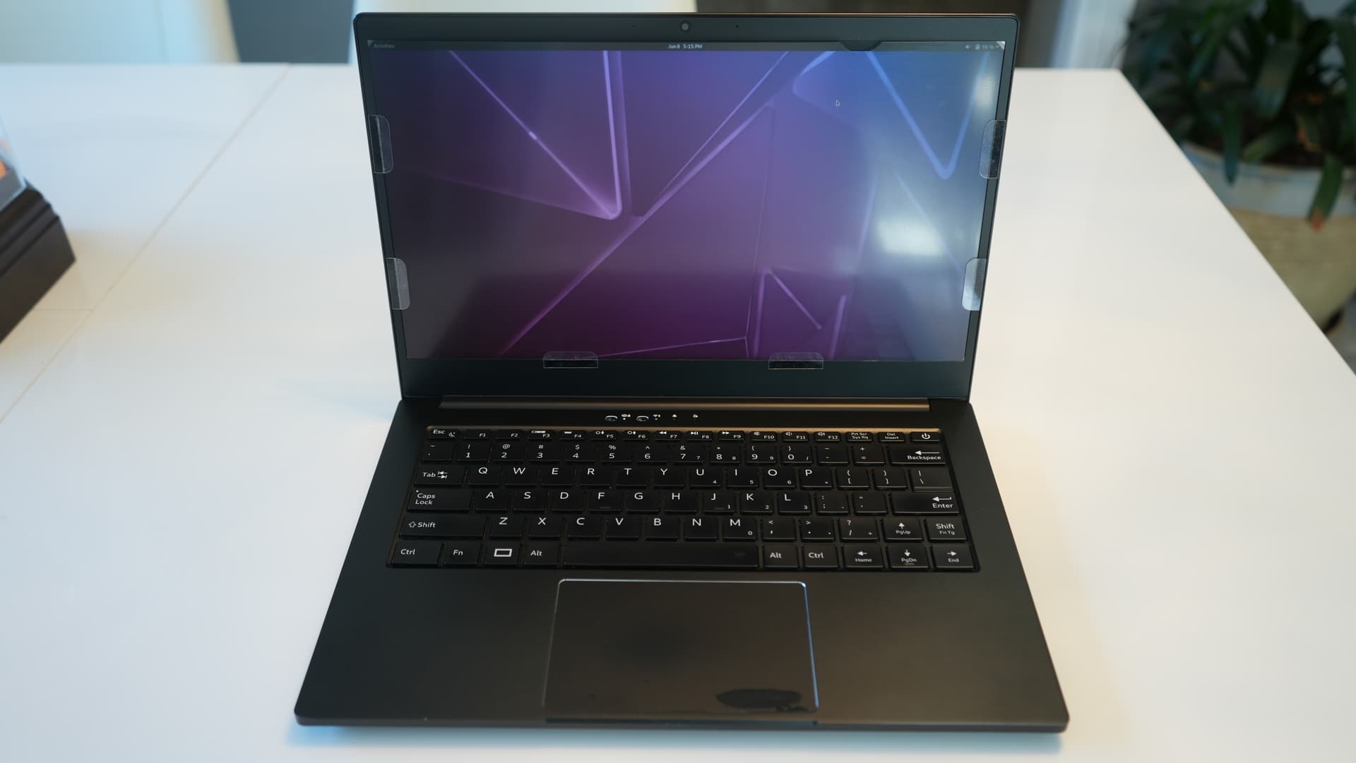

I have a similar issue with my Librem 14v1-01:
I simply ignore it.

The bird that sharpens its beak once every thousand years on your trackpad finally wore it down!
Yep my 15v4 also is like this, but way worse than the 14 in the photo. I’m gonna get a trackpad sticker too. Dimensions look like 105x74mm, and the corners have about the same curvature as a credit card. Someone on Amazon called BoxWave sells a clear protector in case anyone is worried about their trackpads flaking.
