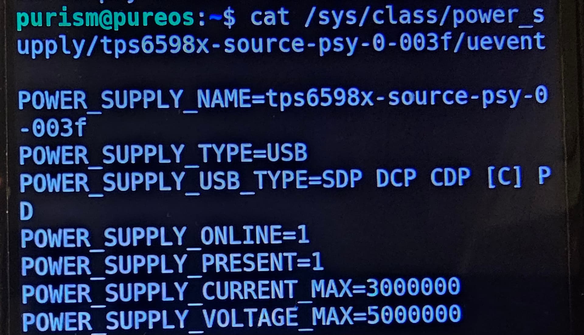

You can check what charging was negotiated by using:
cat /sys/class/power_supply/tps6598x-source-psy-0-003f/uevent

Here is the output.

And uevent:

The screenshot looks odd but, OK, I will leave it and you can take it up with Purism Support.
Nothing on the screenshot looks odd, it’s configured to source up to 3A from a USB-C port based on its CC resistor configuration. Unless it wasn’t connected to a USB-C port with such capabilities, it an expected result.
FWIW there are no changes in firmware config between 0.2.0 and 0.2.2 that could be relevant to charging; the application code was however updated between 0.2.0 and 0.2.1 and this could have some relevance.
To be fair, we have no idea what the phone was connected to when it produced that output.
I think though, whatever it was connected to, it should be charging satisfactorily and the OP at least has some kind of workaround. Right?
It was kind of my intention that the OP posts that particular output when charging is not working - but maybe that wasn’t what has been posted here.
