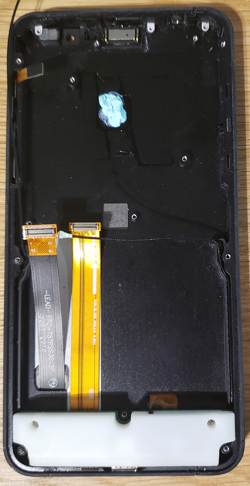

I’m under the impression that the heatsink for the Librem 5 is aluminum. Are there STL files for the Evergreen for the use in a CNC milling service

I’d want to use an STL to make the CP& VPU heatsink
Though, I couldn’t find an STL in the 3D Print section of source.purism
@nerd7473, I recommend that you file an new issue report at https://source.puri.sm/Librem5/3D_designs/-/issues, asking for the STL file for the aluminum sheet behind the PCB and explain why you want it.
I assume that you want to replace this piece with the thermal paste:
The heatsink on top of the L5’s CPU would probably lead the phone to be cooler if it was made of copper
i just hope that the copper heatsink won’t interfere with the antenna signal …
yes copper is a better conductor than aluminum however for such a low volume heatsink it remains to be seen how effective it would be in practice … have you discovered a next-gen technique to maximize fin stack area for optimal dissipation in such a reduced enclosure ?
