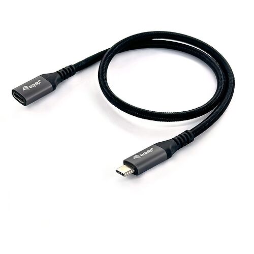

just found a 50 cm USB-C extension that worked PROPER in any respect: Video, Charging, key and mouse, ethernet and so on:
0.50m Equip USB Kabel 3.2 C → C Verl. St/St 0.50m 5A sw
as displayed by a vendor here:
I did not find limitations posed by using this extension. That does not mean there aren’t any.
And tremendously cheap! Good things still happen.
