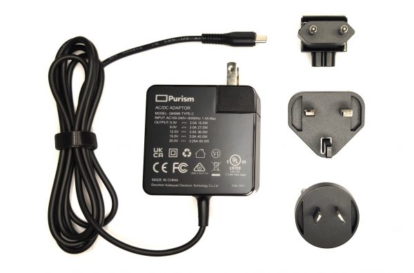

This official purism charger, looks very nice and is only $40. Problem is the shipping cost more than the charger making it $90. Is that b/c of some battery regulation or something? That charger wouldn’t need a voltage converter right?

You can see in the image on the Purism shoop page that input is AC120- 240V~50/60Hz, so no transformer is required. (This is true of probably all modern computers’ and phones’ chargers, as well as many other electronic devices.)
