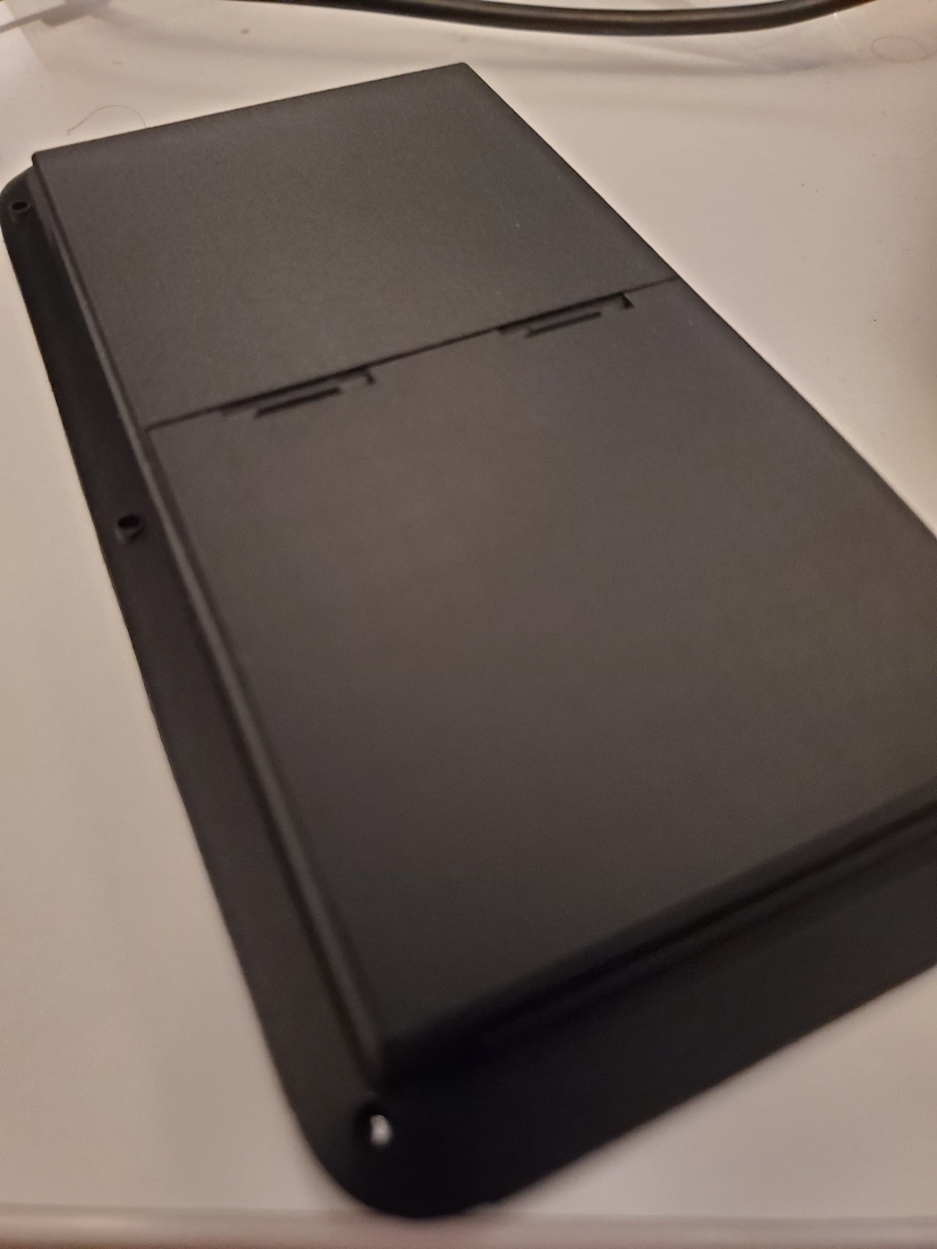

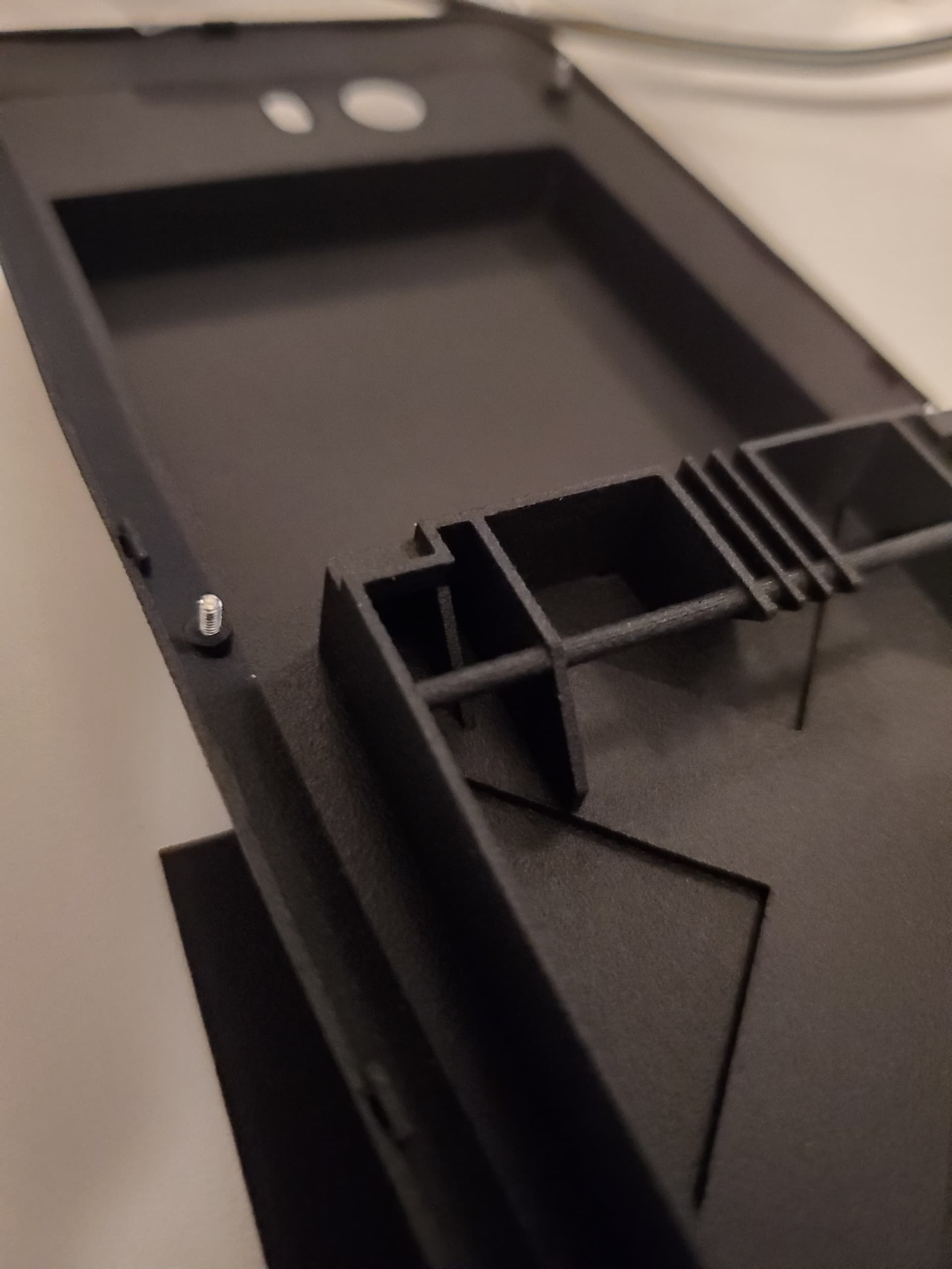

The screws used originally to hold the Librem 5 back frame on were repurposed here to attach the big battery house over top. For the most part the Librem 5 screws have become stuck in the 3d print which is fine when it is in use but if I wanted to go back to a single battery configuration, that is very difficult because I have not managed to remove the screws from the 3D print to put them back. I also lost one of these 6 screws while interacting with this.
