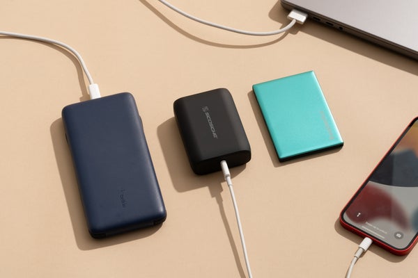

I’m still interested in 10AH and larger power banks that are not junk and I guess I should also ask for a list of ones to avoid and why to avoid them. Again, the ability to function as a sort of mini UPS would be a bonus and not a requirement.
Sure, then you may want to start off with a Wirecutter article:

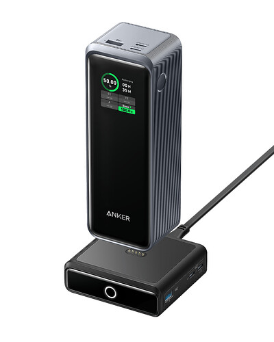

I am still juggling power banks at the moment, but I am thinking about acquiring something more substantial like the Anker Prime B1340:
To give you some understanding of my thought process, I want exactly one power bank to handle any task I throw at it, while not requiring airline/carrier approval. This one is 99.54 Wh @ 3.6 V, which is just barely under the 100 Wh permitted on passenger aircraft:
https://www.faa.gov/hazmat/packsafe/lithium-batteriesPower Delivery 3.1 is also a requirement to efficiently charge other demanding devices such as laptops.
I suggest avoiding power banks with built-in cables since they cannot be replaced. For usability, I would also suggest avoiding products where all charging ports cannot be used simultaneously.
