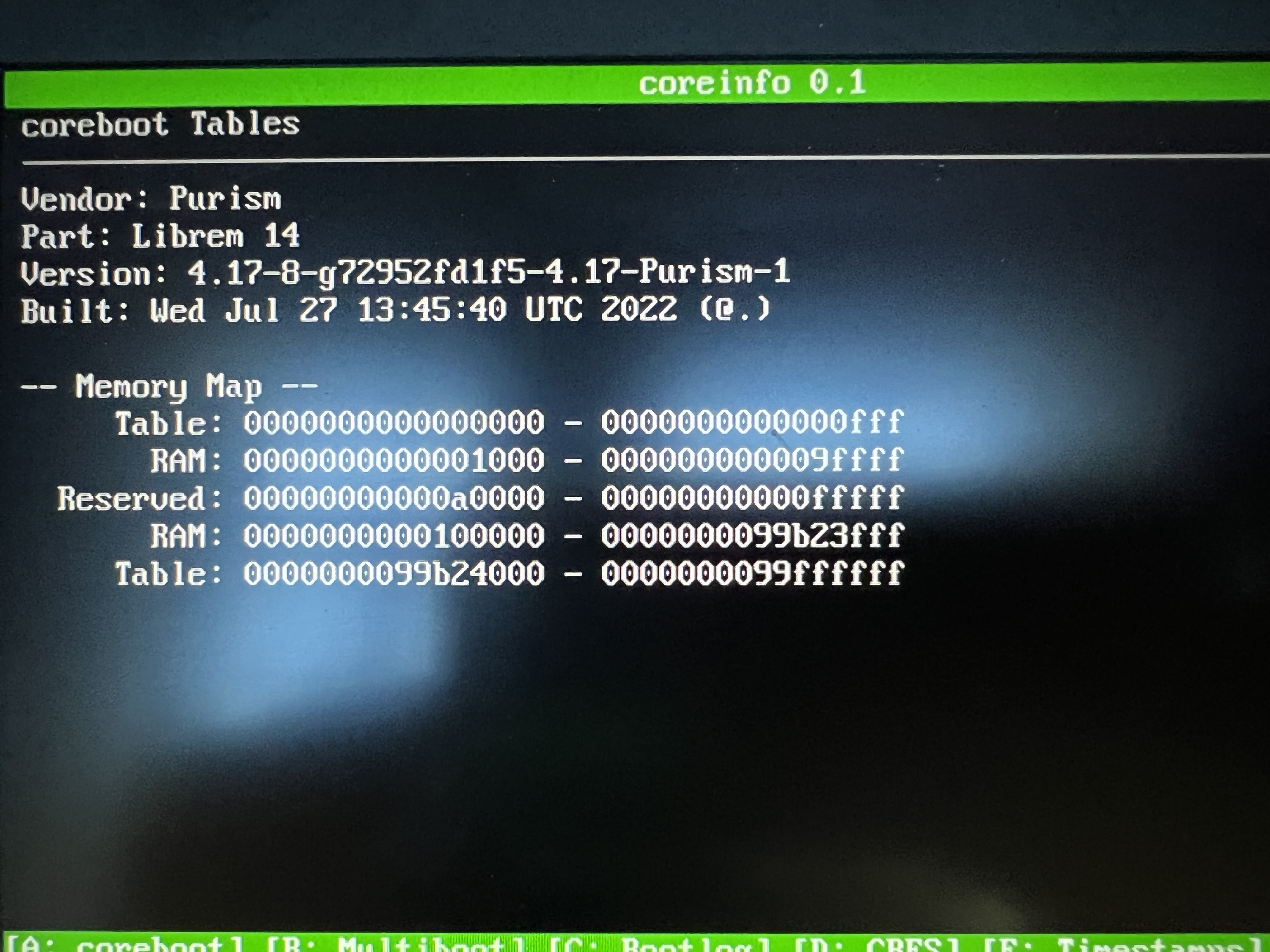

Thanks for the input. I updated the Coreboot firmware this morning. It’s already froze a few times since the reboot. :frowning:

Thanks for that…I see a couple of firmware fails from the output. Realtek and Atherton are the only things in red. I’m not knowledgeable enough to flag anything else. Question. Since I now have the later firmware, (7/27 build) if I reload the OS will it keep the latest build? My next step is Purism support.
