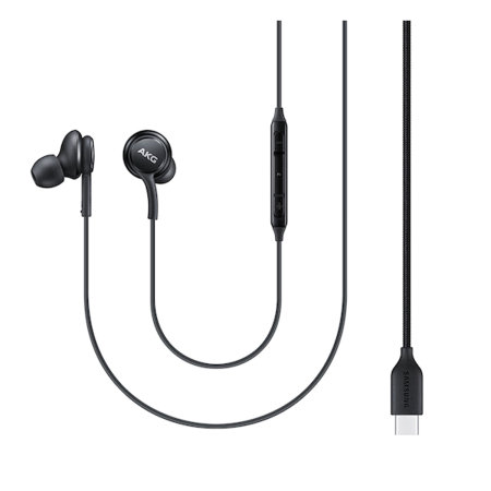

I think it would be better to either make better use of the space internally or slim down the phone. Especially because, most basic head phones these days come with a usb c connector with a built in dac. And any headphones that are good enough to warrant using an analog connector to interchange DACs across devices, probably should just use an external dac anyway that’s from a 3rd party manufacturer whether that’s a basic/cheap but conveniently sized DAC that fits in the usb connector or a bit larger but premium mobile DAC.

I understand that you are proposing not wireless but USB. I haven’t spent any time seeing whether USB audio works well in terms of the software. That would be something to test. (I think I can rustle up a basic USB-A headphone (i.e. built-in DAC), and can definitely rustle up a USB-A DAC with analog output. Neither of these is a “premium” device.

The probable result is that the Librem 5 should no longer be supplied with a set of earbuds; and, if required, the customer would have to provide headphones (or a headset) of some type that contained a built-in DAC and used a USB connector - and the connector may need a small adapter from USB-A F to USB mini connector M.
