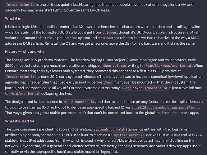

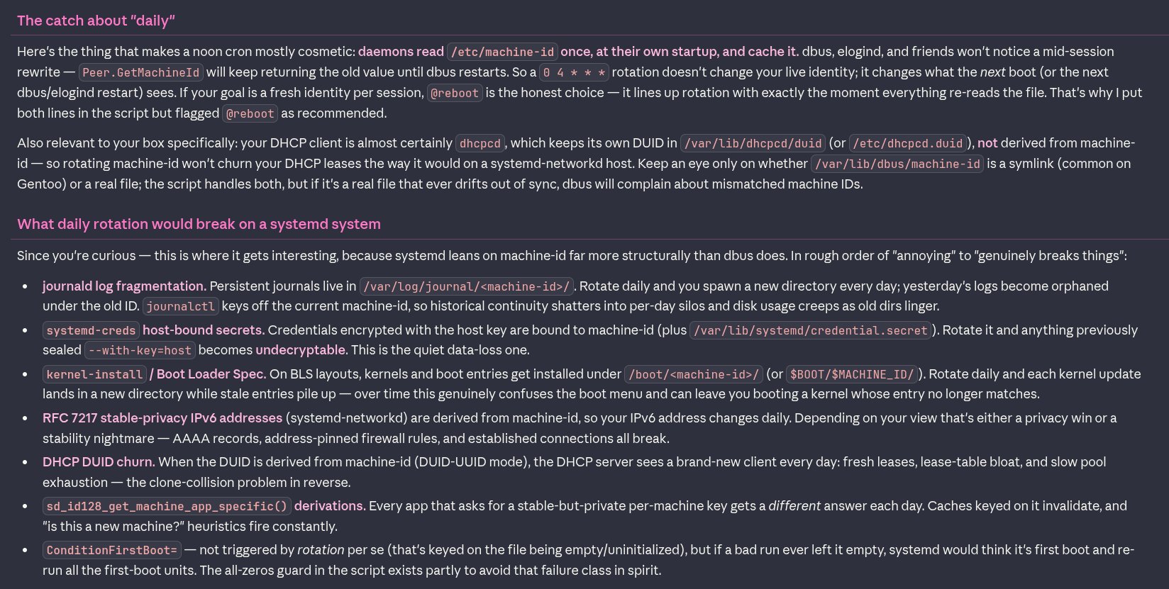

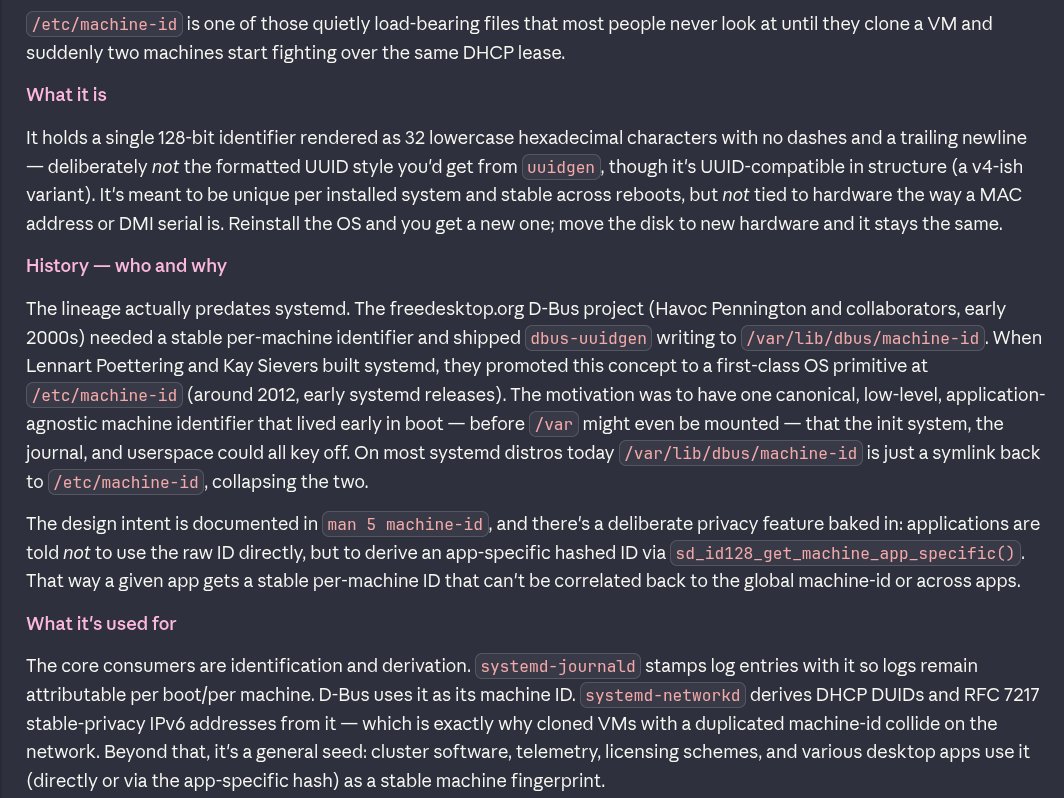

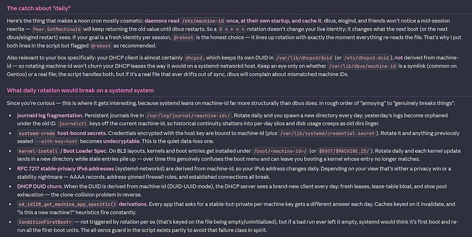

Just learned about this the other day. Alarming in light of recent news about the Peter Stokes bust with help from the Microsoft GDID.
Corollary therefore … if you are using IPv6 and, within that, you are using stable-privacy then don’t do what I am suggesting (re-randomise on each boot).
Huh, well crappy thing about systemd is that apparently if you change the machine-id, you have to reboot. It’s tied into too many things.
Between this and Debian replacing GNU Coreutils with uutils enrustification garbage, I really need to figure out a way to get PureBoot working with a non systemd distro.

The statement there does not appear to match either my experience or the documentation.
If the file exists and is empty then it does not trigger the “first boot” logic. That’s why I did the commands shown above the way I did. An empty file triggers generation of a new machine-id but without triggering any other “first boot” logic.
That’s a worthwhile warning too. (Some people are messing around with renaming the journal directory to follow the change of machine-id, or similar, but I suspect that this doesn’t work very well.)
This highlights that this aspect of the design can make sense. A central computer can act as a store of journals for many different computers and they are cleanly separated with one directory for each remote computer (in addition to the computer’s own journal) and a remote computer will keep its journal unless its machine-id changes - and you can use journalctl --directory=... to select which computer’s journal to examine.
It just happens not to work well for a more common personal computer usage scenario if you want to rotate the machine-id.
