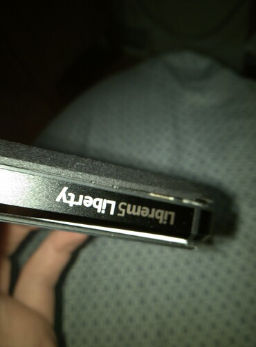

I dropped my L5 several times. Lately the screen seems loose as if I’m pressing against something spongey, but only if I’m looking up at the ceiling on my back holding the device - such that gravity pulls the screen down and away. It causes a ton of spurious taps to register on the onscreen keyboard and makes it hard to type. Other times if I look down at the device from above, such as standing or sitting instead of lying down, it’s totally fine. One of the most frustrating aspects of this is when it toggles the onscreen keyboard in the middle of typing, and changes a letter such as ‘i’ to have the F5 key in place of it. Then when I’m trying to write this post for example, the whole page refreshes. If I have a spare L5 thats not being used, can I take off its screen and affix it to this one instead of the problem screen??..

Not super familiar with the disassembly guide but screen is literally coming out here

That said, I just took it apart and then realized that I don’t even really need to take it apart. It just needs more glue, the glue on the screen must be dead. Giving the screen falling out, I could essentially add the tape or glue or whatever I go with to the screen without really doing much with the reverse side of the device.
Edit: Some carefully placed tape seemed to resolve my issues. I’m writing from the device with bad screen – having added some tape (and closed it up) the screen doesn’t seem to be flipping out, even when writing with the device facing downward!
