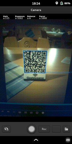

If one points with the camera to a QR-code (like the one in the picture below to get WPA credentials for a public Wifi), millipixel (with a bit luck) shows a flickering rectangle around the QR and it’s a PITA to get the ASCII content into the cut&paste buffer, hitting again and again the blue lines.
Is there some trick to hit the flickering rectangle? Why millipixel not just put the content into the buffer?

For the record that QR code reads as follows.
WIFI:S:Gastzugang Gasthof Trenner;T:WPA;P:p28p16m29j27;;

I expressed it wrong. When one finally manages to hit the blue flickering at the right place, a small dialog comes up showing the string from the QR code and with buttons to open it or to copy it (into the cut&paste). My question was: Why not just bring this dialog up, when to QR string is recognized by the cam?
The picture with the QR is in a small restaurant on any table so that the guests do no bother the service personal with this and afterwards use a wrong listened WPA key :slight_smile:
