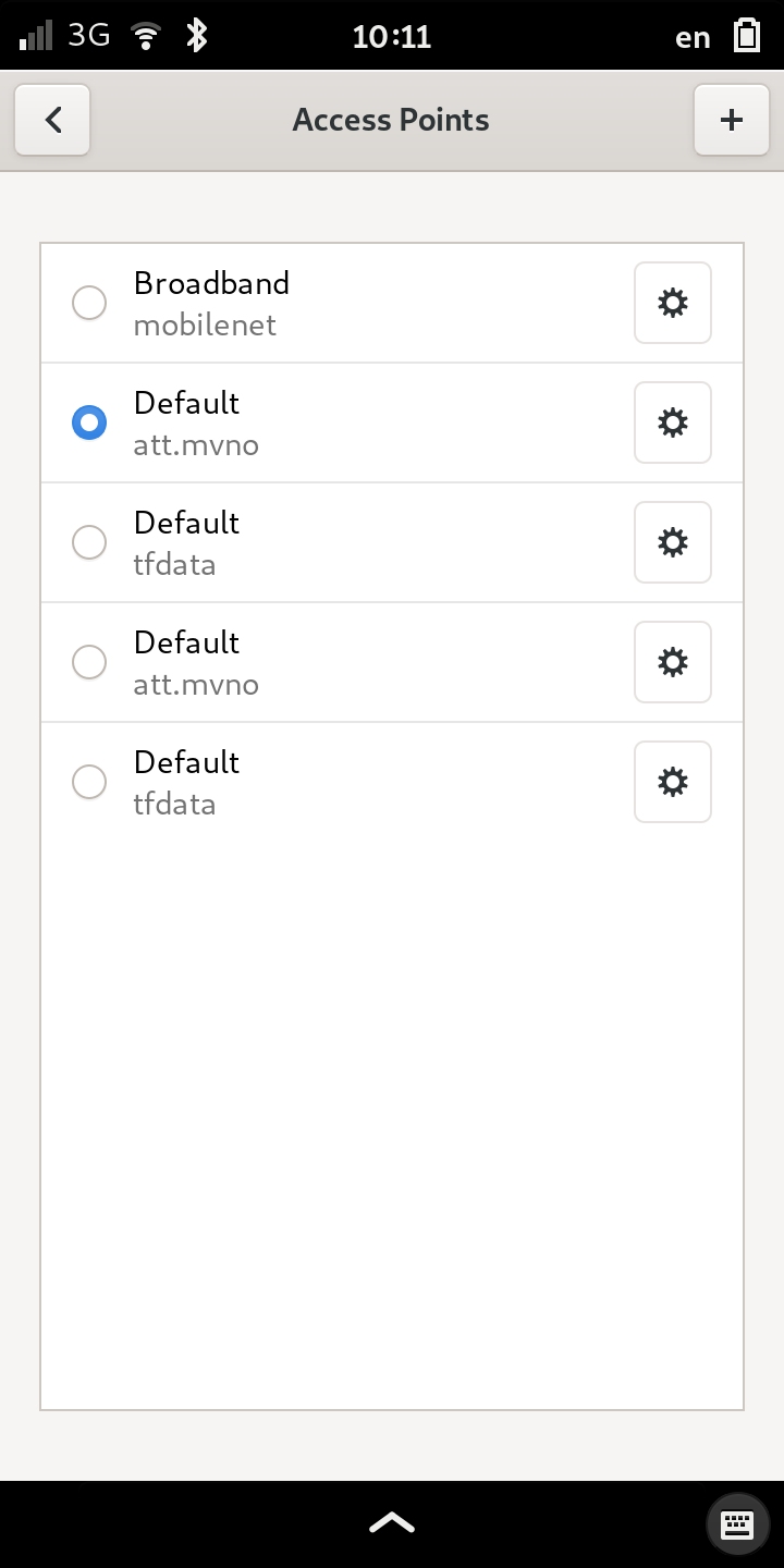

I’m using a Librem 5 with AweSIM, and I haven’t been able to get mobile data to work. Calls and texts do work. I’ve turned on Mobile Data in Settings, but I don’t know if more configuration is necessary. “Access Point Names” looks important, but I don’t know if or how that’s related to the problem.
Hello, can you send a picture of your current APN settings?
This screenshot looks different from usual. Usually, it just shows two options: No Broadband, and no duplicates.

:confused: It looks like there’s not much information there. Also, the Broadband option is now missing again from the list.
But did you turned on 2G, 3G, 4G (Preferred) :white_check_mark:, any other that is Preferred or just 3G Only (as 3G is what I see within screenshot of yours above) within Settings Network Mode? Why not 4G, is it reachable from the place where you use your phone? Perhaps not about helping much, just curious as your problem might be related to, but not sure, your 3G mobile data not working (why particular BM818-A1 4G band from B2/B3/B4/B5/B12/B13/B17/B25/B26/B66 isn’t reachable)?

I just found out (although living in Europe) that att.mvno and tfdata conflict each other and therefore might help you to find the way how to (re)solve this issue of yours. “If your APN is att.mvno you will be able to access the internet using your cellular data connection.” Also: “When your APN is tfdata your cellular data connection, MMS picture messages, and group texts work automatically.” Perhaps below (and other similar links) help further (but I don’t think that some changes will be needed under current Settings, other than switching your APN to tfdata):

I switched to tfdata a couple weeks ago, and there’s been no change.
The only fields I see when making a new APN are Name, APN, Username, and Password, so I can’t put in all that information that appears in those links.

For your carrier try these APN settings:
APN: Phone
Username:
Password:
Looks like that fixed it. Thank you. :grinning:
