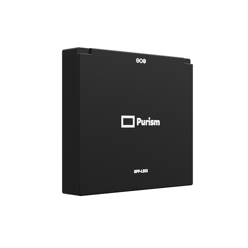

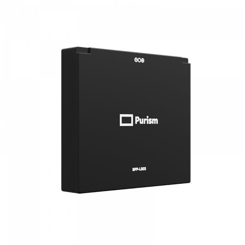

-I also bought a spare battery. Bottom line, is the L5 battery performance is still a big work in progress. Having a spare, charged and ready when you are on the road, or having one for when the one that ships with it dies, could be really handy. Again, not expensive (like the dock). And, you get shipping for free with these accessory purchases, so that is nice to take advantage of now while you have the free shipping.

@Sharon, be aware that adding accessories and peripherals to your order could delay shipment if, e.g., Purism doesn’t have an item on the shelf and ready to go. But then, if you order items separate from the initial shipment, you’ll have to pay for shipping.
Note also that shipping spare batteries can be problematic to impossible due to safety regulations, so best get one with the initial shipment if possible.
Quoting: “NOTE for customers outside US: We will not be able to ship any orders that contain ONLY batteries, without containing a laptop and/or phone, due to regulations. Any such order will be cancelled and refunded. If you already have an order for a laptop or a phone, order for the battery will be combined with that order.”
Depending on where you are. If air transport is involved, it can be particularly problematic. Otherwise it might be OK.
Generally though, yes, if you are going to get a spare battery at all then order it with the original Librem 5.
