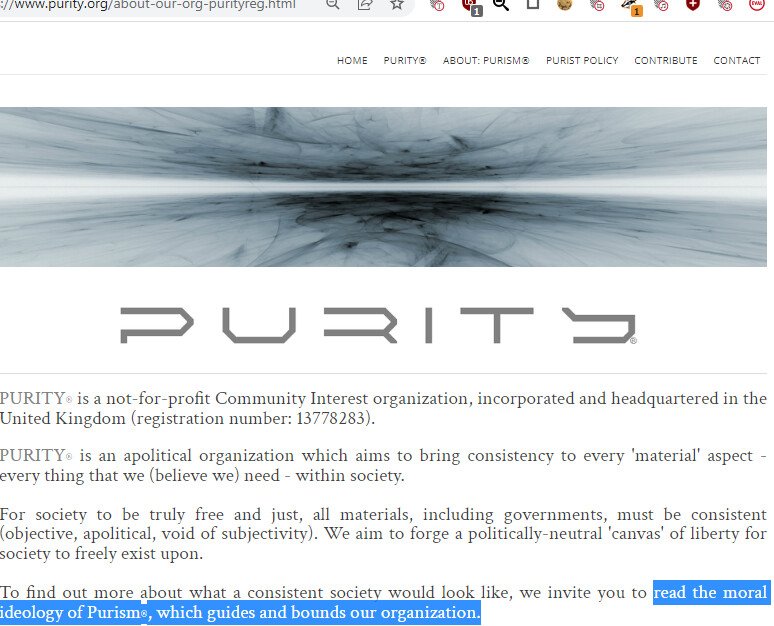

While replying, I wanted to look up something in Forums so I just one tab and logged in a again. I typoed the URL, no “s”, and got a blank black screen so I added the “s” and got …
Enlarge the pic and avoid the blur. I enlarged it and can confirm the name “Purism” ®" is allegedly trademarked by them.

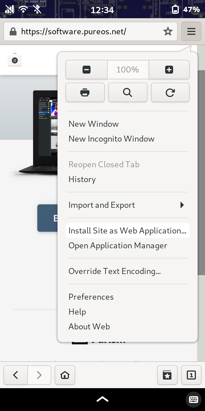

Launch Web, go to desired website.
Then Preferences “hamburger menu” dropdown > Install Site as Web Application:

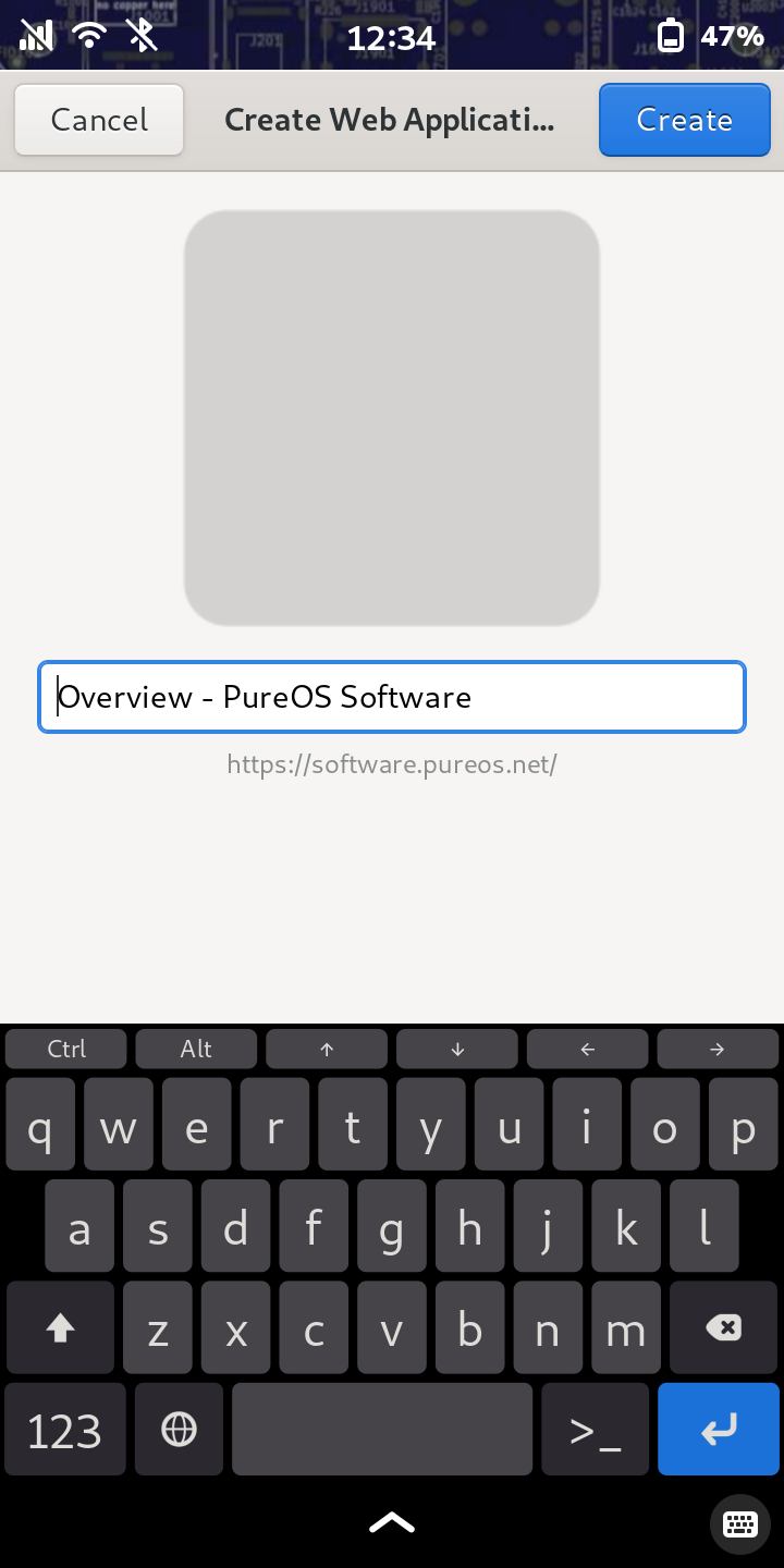

Then Create; change the name if you want to:

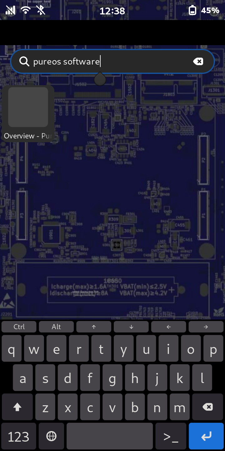

Then it appears in your app grid (alphabetized):
