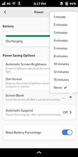

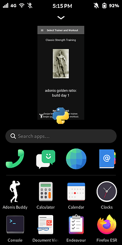

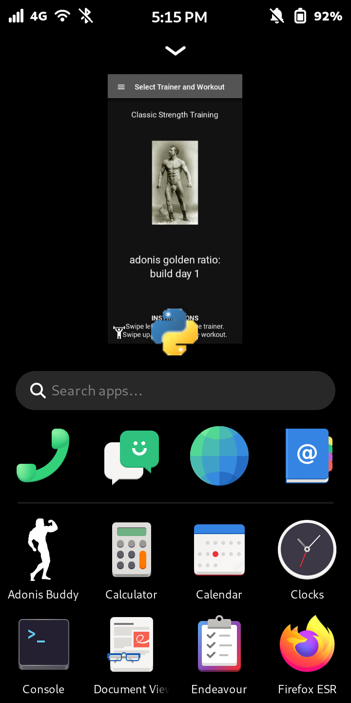

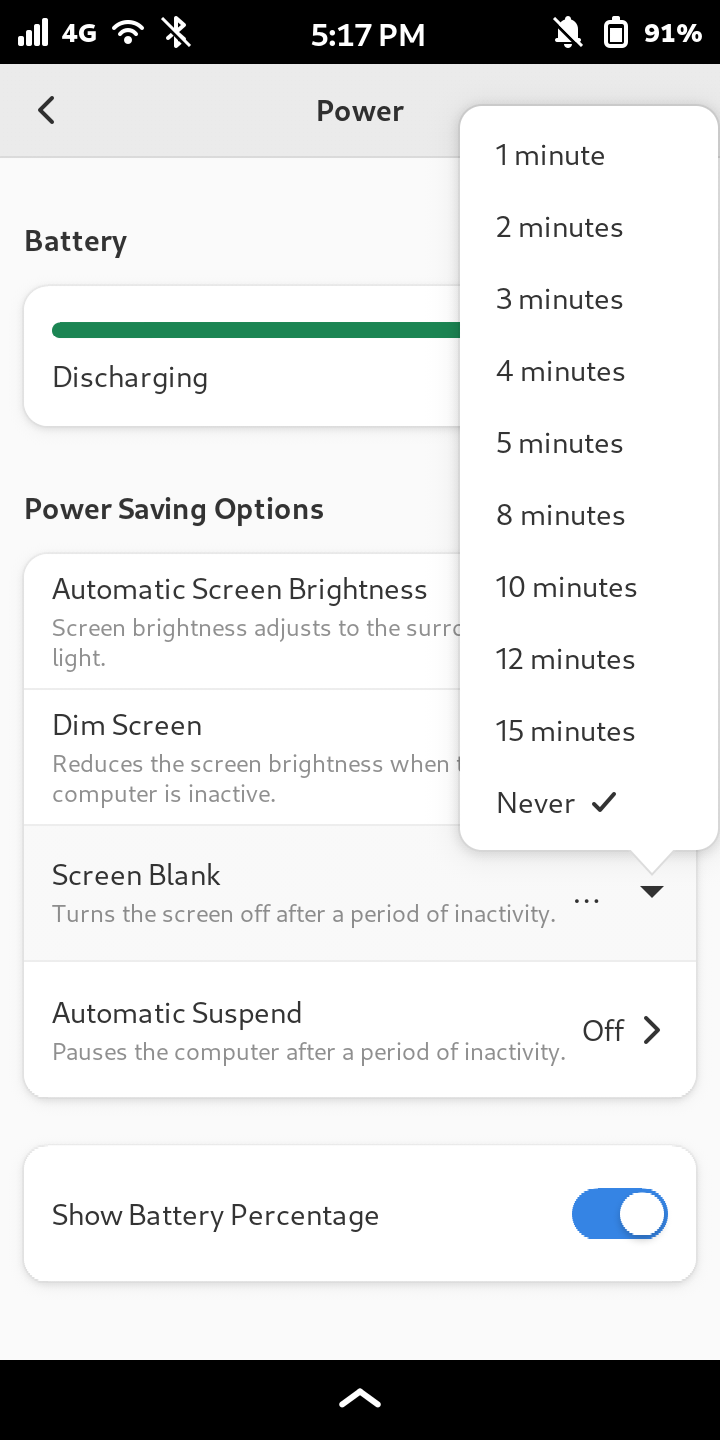

We are still in fullscreen mode and everything works correctly. But let say I forgot to turn off the screen saver and I don’t want the screen locking while I am using the app so I need to switch to the settings app.
Okay now we want to go back to the running app.
Here I returned to the app and opened the set recorder screen. The top and bottom panels are now no longer hidden and calibration is off. If you touch the 0 button too high it will register as a touch to the 5 button because Kivy thinks the 5 button is lower on the touch device than it really is.
