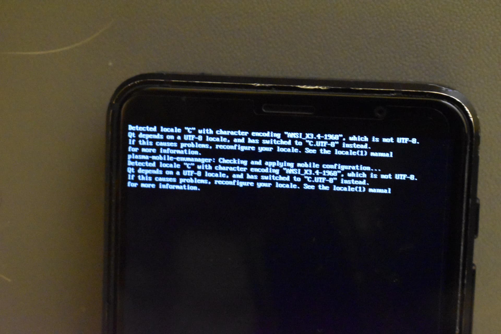

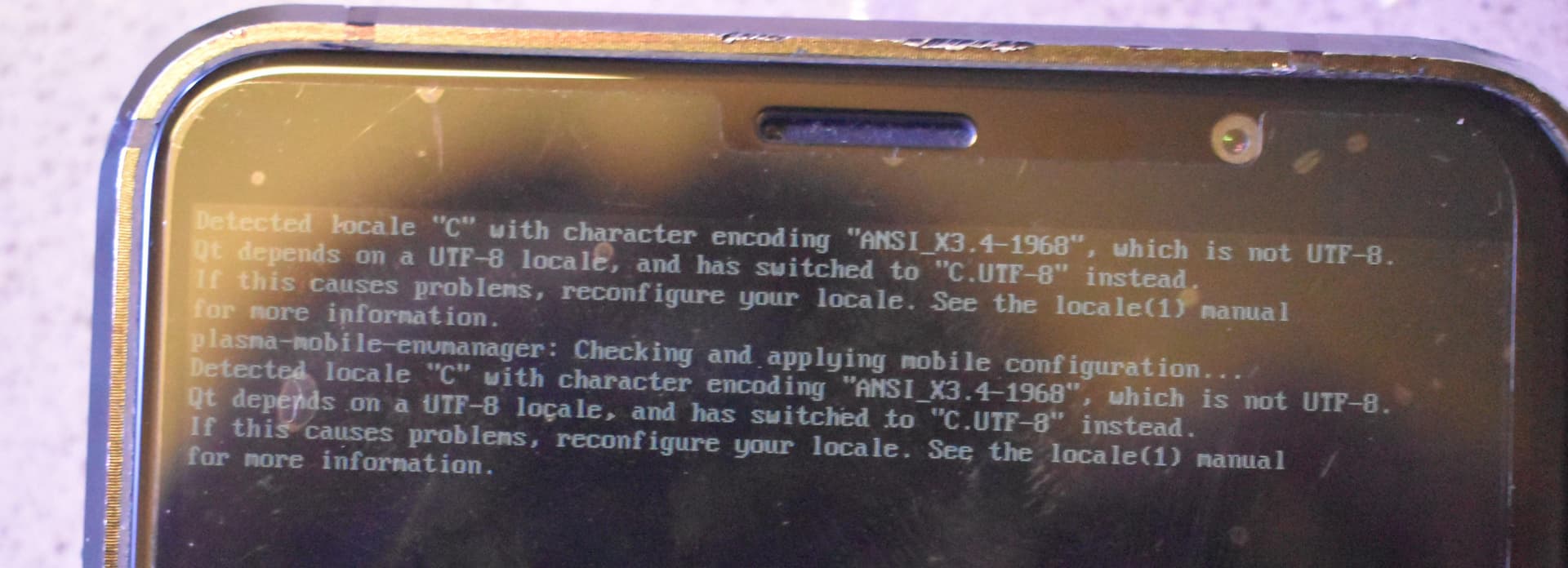

I believe this is an unrelated issue and I have requested support here:
These have also been submitted to the KDE Bug Tracker for further discussion:
Concerning the Power Button Unresponsiveness:
https://bugs.kde.org/show_bug.cgi?id=508625
Concerning the locale message:
https://bugs.kde.org/show_bug.cgi?id=508626
