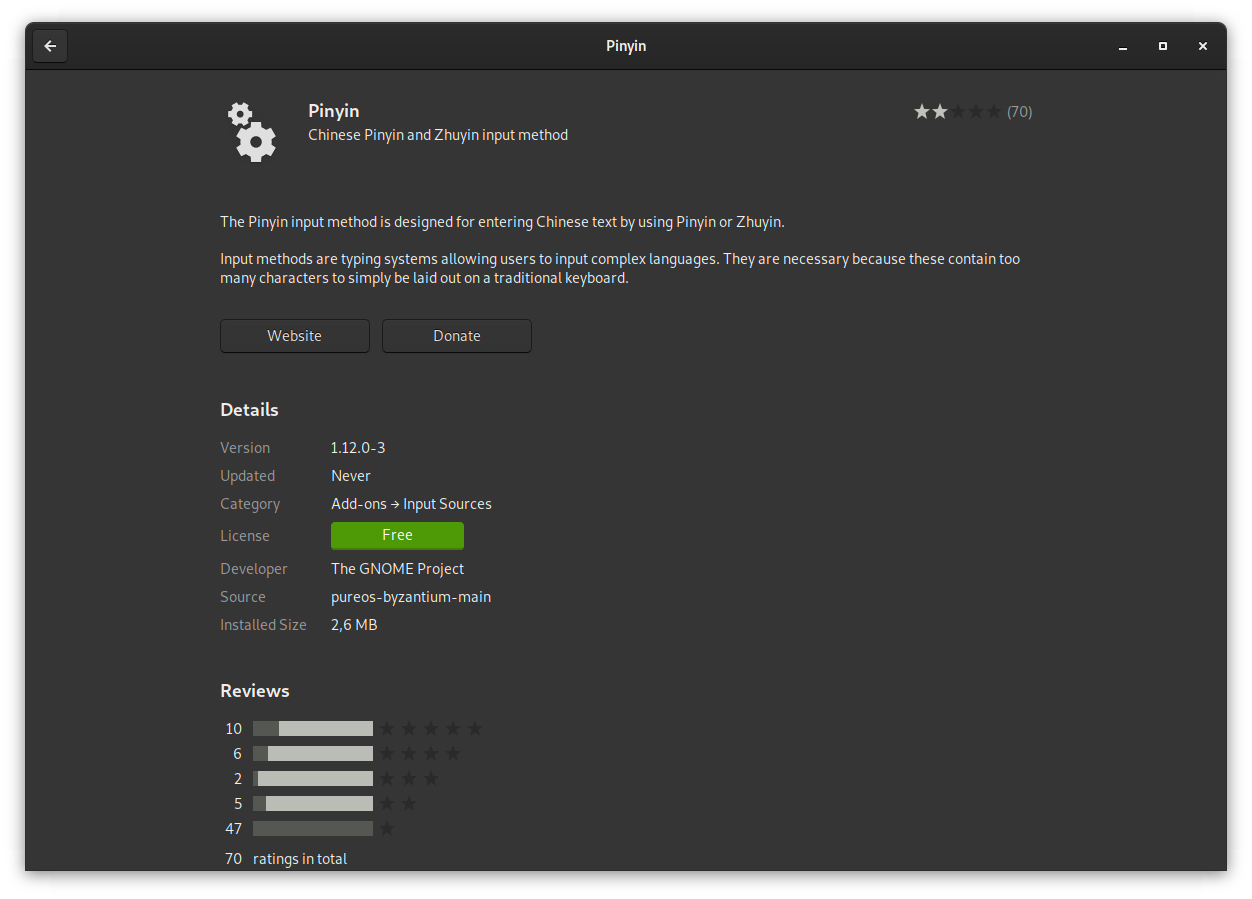

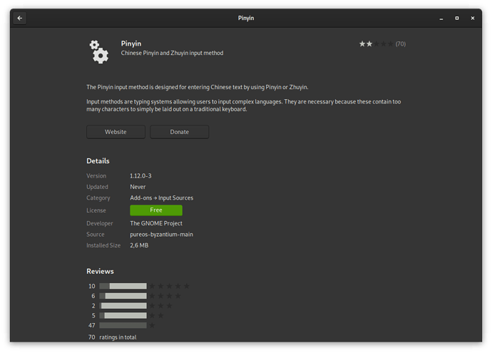

This looks like just a matter of incorrect license identification, since libpinyin is licensed under GNU GPLv3. Could you post some screenshots so we can see exactly the thing you are talking about?
I find this odd because in GNOME software on my machine is shows a free license:

It is the same package as posted by @joao.azevedo , but the licence appears differently.
