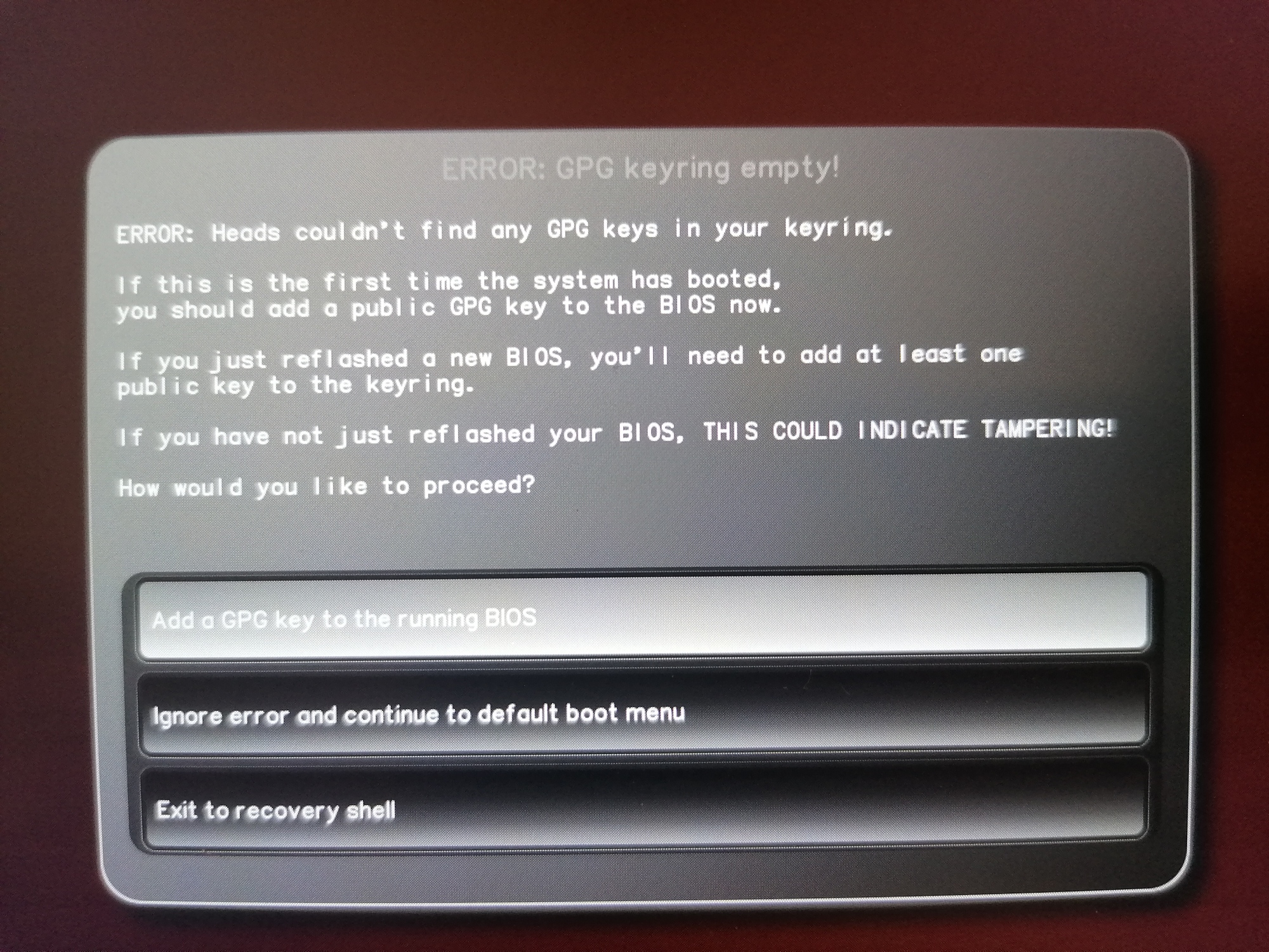

I’m experiencing bugs in the pureboot firmware now. I have the same PurismKey with the same privkeys for nearly a year now. I put the pubkeys on a usb, along with the Pureboot-15v4-13-beta, plugged it in, flashed, and then tried to add my GPG keys to the keyring. Again, and again, and again…

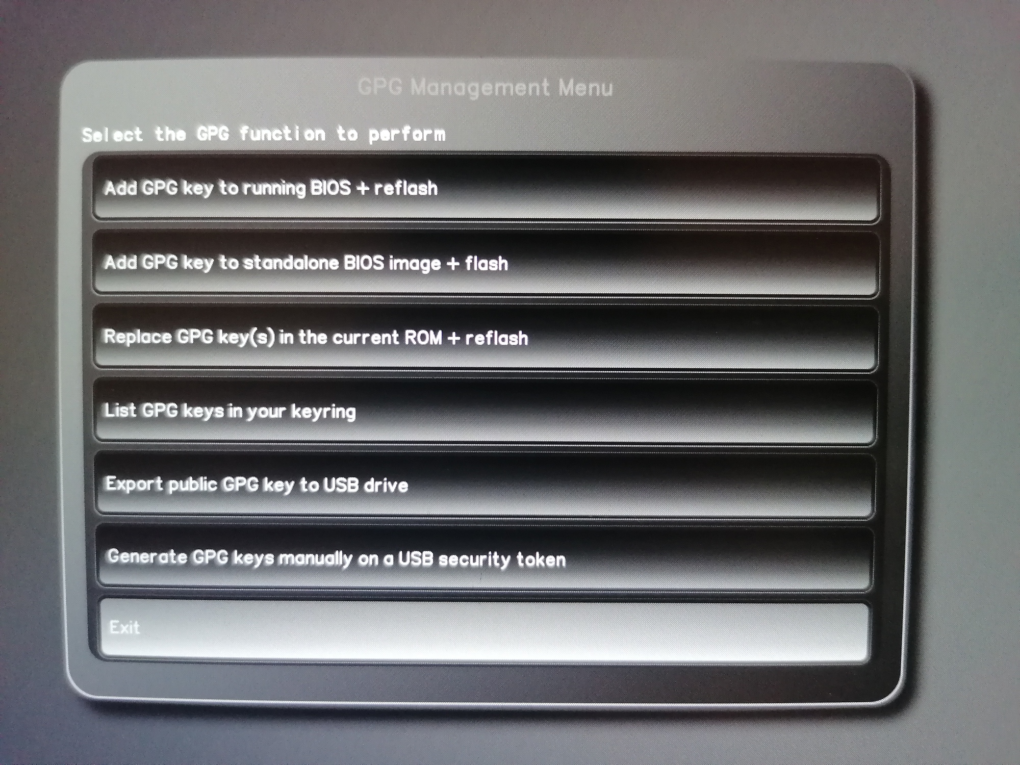

It doesnt matter if I add to the running or standalone bios, or replace + reflash. It never accepts them, and always sends me back to the same screen where HEADS fails to detect a keyring. I even tried a factory reset, wiping my key, generating new keys, and saving to usb. Nope. Only now at least it gave me an actual error page.

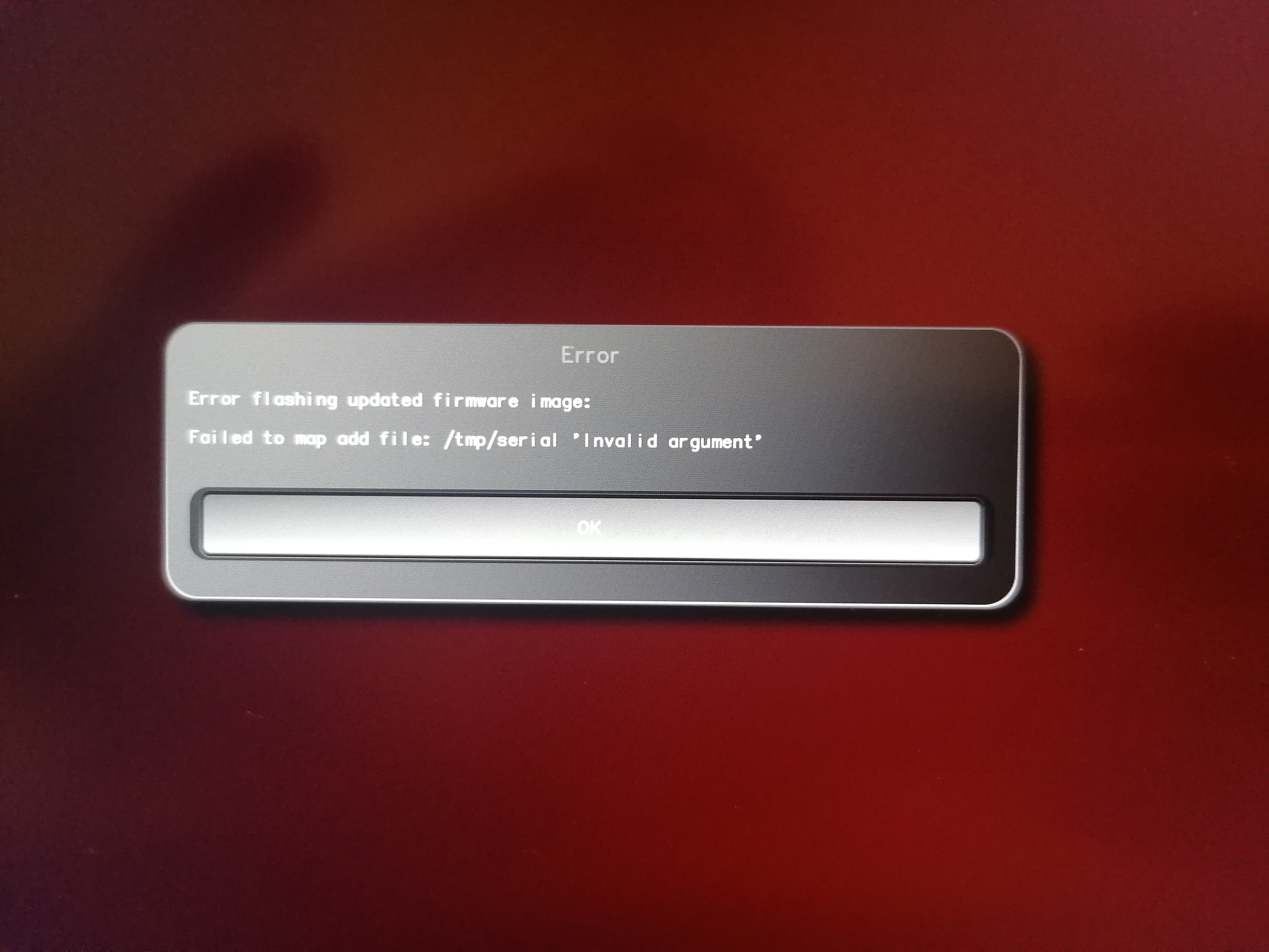

  3. After multiple failures to restore my keys, I did a factory reset, which generates new keys, and even that completely failed to set a new keyring on the ROM. See photo #1.
just to make sure there are no misunderstandings you need to place the public key to the ones stored on the librem key as a public.asc file onto the USB stick as explained here https://docs.puri.sm/PureBoot/GettingStarted.html#first-boot not a whole keyring
First of all… That’s 100% irrelevant in the face of my statement that I tried selecting the factory reset option in the ROM screen, which wipes the card and drops the new pubkey to your usb.
But yes. I went back to my original gpg private key, reset the card, added the private keys to the card, used gpg --export to generate a pubkey file and dropped that on the USB.

I get the errors as show above in the photos… Every time. No matter how I try it. I even just now tried the previous version 11-beta.rom, still no success.

don’t be silly, I test every single device/version before release. You’re running into a bug where a zero-size serial_number file is causing the propagation to fail. I’ve identified and fixed the root cause, just haven’t had a chance to spin a new release
So what do I do in the meantime? Do I need to put one of the older revs on? I received the laptop in August last year. Which version do you recommend?
you’ll run into the same issue with the older revision. The bug was triggered when you switched from Pureboot to coreboot and back without setting the device serial number when flashing coreboot.
I’ll build an update with the fix for the 15v4 in a few, and will have you flash manually to bypass the bug

there is no way around flashing something manually at this point because your current firmware is missing the serial number, and so the Pureboot built-in updater is going to fail.
SUCCESS!
Thank your for turning that around quickly for me. Just fyi, the mount_usb command didn’t work, and I couldn’t find it in /dev. So I selected the menu option to load GPG keys, which mounted the usb, and then I aborted to the shell.
