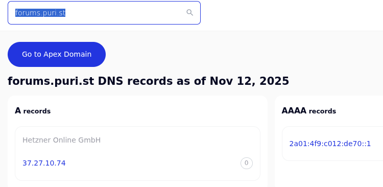

I tried both forums.purismspc.com and forums.puri.st and only the latter one worked. Interestingly it resolves to a different IP
The different IP address is likely attributed to the main domain:
I receive a 301 when attempting to access forums.puri.st, so it is not technically a redundant mirror.
Strange, because that hostname redirects to forums.puri.sm for me.
A 301 is a redirect. And redirecting to a URL that contains a hostname does not provide any protection against domain fail on the domain that is the target of the redirection.
Redundancy (for domain fail) would be provided by configuring both domains to resolve to the same IP address and configuring the web server on that IP address simply to accept requests targeted at either domain and to respond identically regardless of which of the two domains the client uses. (That could end up being painful though if any absolute links ended up embedded in content in the forum where the link identifies content within the forum itself. That it, the forum software would need to replace those absolute links with relative links.)
That would not provide as much redundancy as a full mirror - but a full mirror would be harder work.
It is basically a limitation of discourse. If discourse can support aliases, this would be easier.
