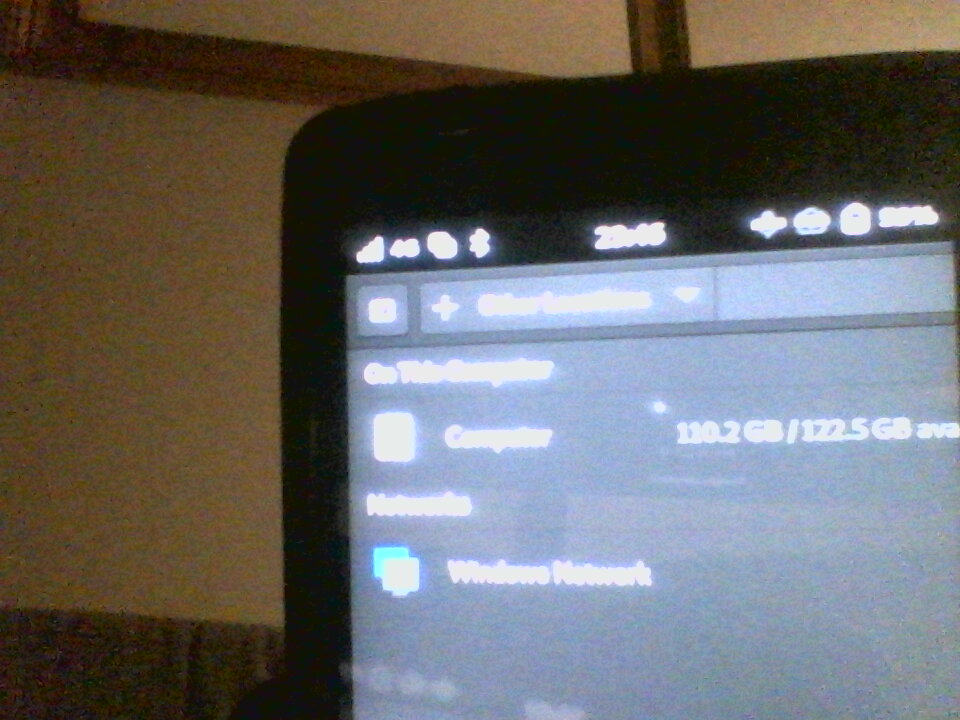

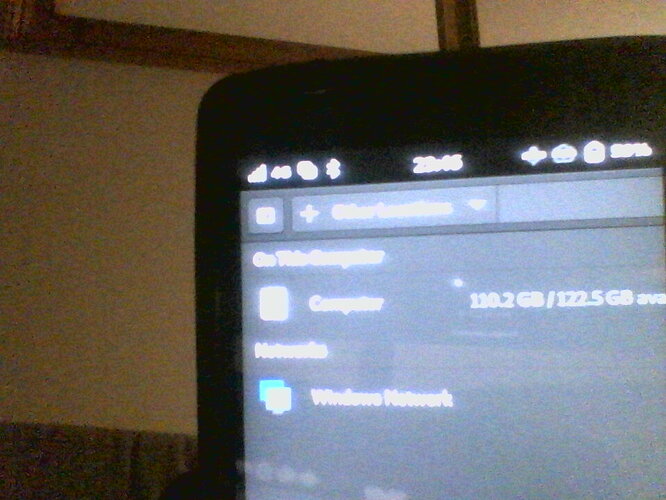

I have just received the LibertyPhone to replace the L5 which had received quite a few impacts… Texting does not work. It only works if I close and open the modem, with the kill switch. I’ll get one immediately. But if I try to send another one, it doesn’t work… I still have to open and close the kill switch… If I text something that’s been copied and pasted, it doesn’t work. And the terminal tells me “no sms found”.
Translated with DeepL.com (free version)
Can you please share your Librem 5 Liberty photos here?
Please. :pray:
