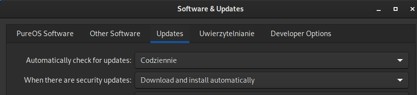

it’s worth to run Software & Uptades app, and in updates set:
automatically check for updates: daily
when there are security updates: download and install automatically
