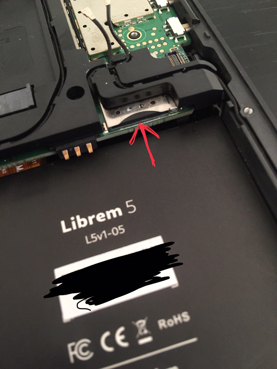

I accidentally pushed a micro-SD card into the SC slot instead of putting it onto the SIM tray, and now I can’t remove it anymore. It has no spring mechanism.

thanks for the replies but nothing works and the micro-SD is so deep inside that it barely has any grip to get it taken out

Is it possible to remove the black plastic part, so you have better access to the cardslot?
Do you mean that the card is pushed in beyond the 4 holes you see in the picture?
If you can see the card through the 4 holes, you should be able to use a pin to pull it out.

No, it was in the same deep as shown in picture but your idea with the pin was the solution! I had to push the pin very hard, and repeat the procedure multiple times, to make a noticable move by the micro-SD card
