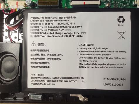

I found this battery photo at tuxphones(.com), which they seem to refer to as the 4-cell: Purism Librem 14 review (part 2): The ethical flagship
proxy-image
You’ll need to verify, of course.

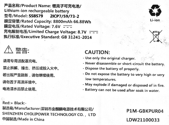

I still have my balooned L14 4-cell battery. Here are the detaills:
I want to thank everyone for their help. I got the following reply from Support. Maybe it will be helpful to someone in the future:
Hello Walid,
Thank you for reaching out to us and for being a Purism customer! I’m sorry to hear your battery is no longer functioning properly.
The information about the 4-cell battery we can share is:
  • Model: SSBS79
  • Manufacturer: Shenzhen Cholipower Technology Co., Ltd
We are able to ship standalone batteries internationally, however, this comes with an expensive Dangerous Goods fee of USD $155.00 on top of the normal shipping fee and possible customs and import taxes. Please let us know if you would like to proceed with this.
