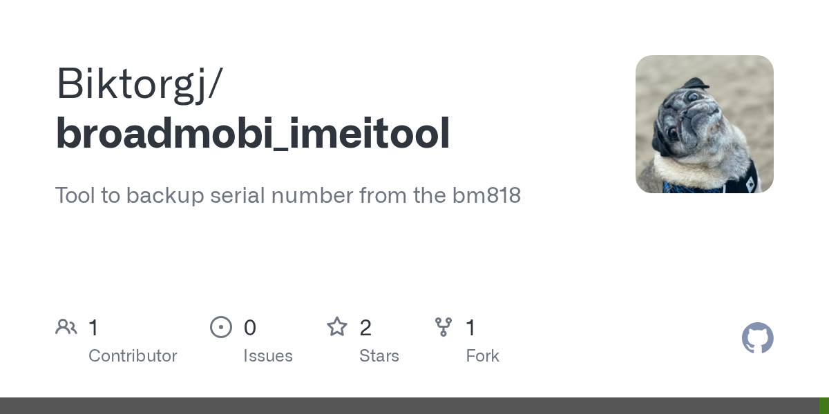

This may or may not be useful for changing the IMEI:

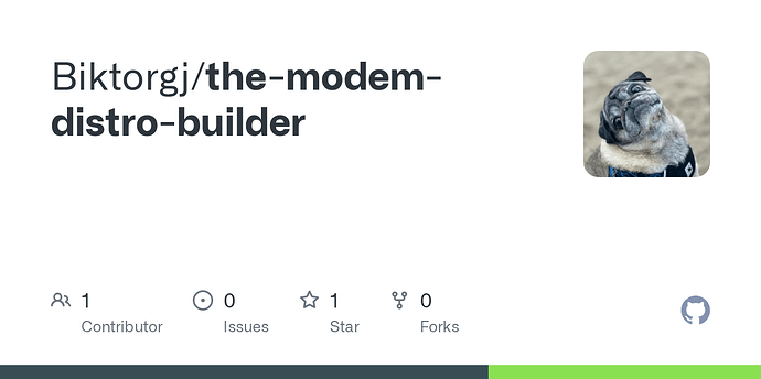

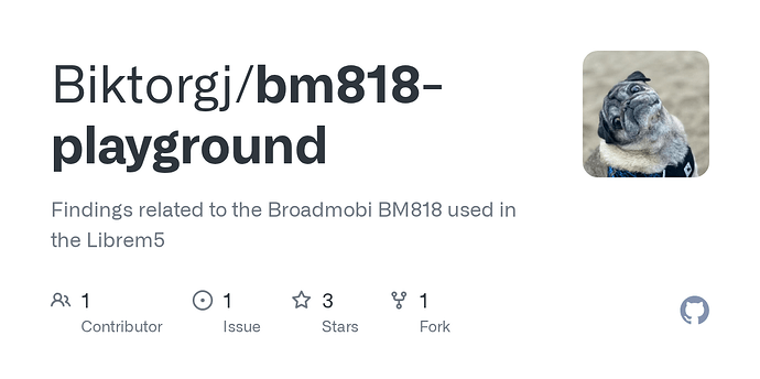

There’s also these I stumbled upon:
This person is apparently on the Fediverse here:
… including a) does it work at all on the modem side in a Librem 5 and b) does it cause other unrelated problems either on the phone side or on the carrier side.
It seems that the modem OS hacker biktorgi has dropped out of the pine and pure project’s hardware around late last winter.
Strangely, that project comments
The BM818 wipes its EFS when you update the firmware, setting your IMEI to 0000000.
(which seems like a bit of a weird design)
Anecdotally, there are some Librem 5 customers who have already updated their modem firmware (directions here: Reflashing modem firmware - Purism user documentation), so Purism must know all this already. Possibly though the backup and restore discussed there is more comprehensive than just the IMEI and the SN.
