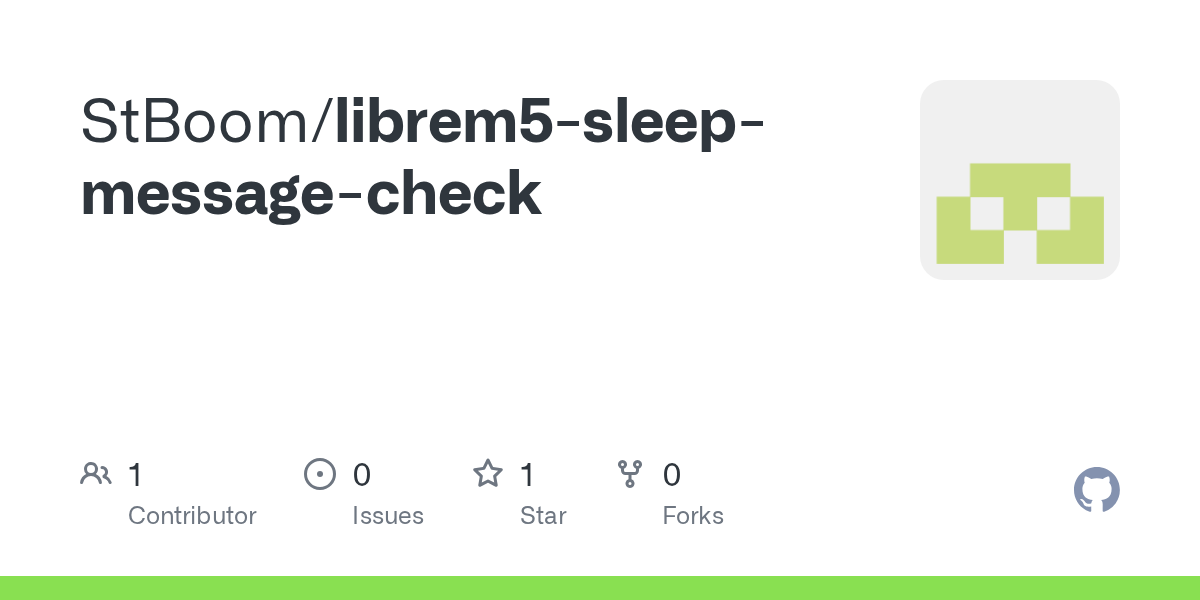

Do you have a way to get notifications about Signal messages without having the Signal Desktop app running all the time?
No, I leave Signal Desktop running all the time, but I also do use suspend when not connected to power. I wake the Librem 5 now and then to see if there are Signal messages. And I tell people to phone call or SMS me if I have to respond immediately.
I use a small scrpt to wakeup the phone and check for messages. And goto sleep if there a none.
How? What does your script look like?
I use the rtc to wake up every x minutes or so.
Wait until internet is working, and then check if there are new messeges on dbus.
If not go back to sleep, if there are new ones enable display and play sound.
