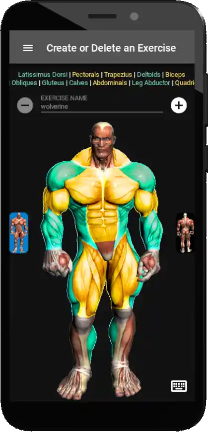

Just for context, this is the app I am trying to submit to the PureOS store for the Librem 5.

CPython3.12, Kivy 2.3.0, KivyMD 1.1.1. This framework uses OpenGL as the render target. The ascetic is quite different from the other apps as it is similar to a game. An install from the yet to be released Beta-3 AppImage takes up 290M on my Librem 5.
Do you think that if I took the time to make the flatpak for the Librem 5, I would be wasting my time since the ascetic is alien when compared to the other apps in the PureOS store? It does take 20+ seconds to load, so you have to be patient for it to spin up. It is intended to be used for about an hour once a day by itself as you focus on your lifts.
Is there someone I can direct to the web site and ask if the app would be accepted if I submitted it before I go through the work? The Muscle Buddy videos page has 16 demo/tutorial videos. A reviewer could get a pretty good idea of the ascetic of the app by watching the videos.
