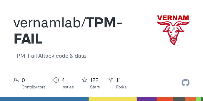

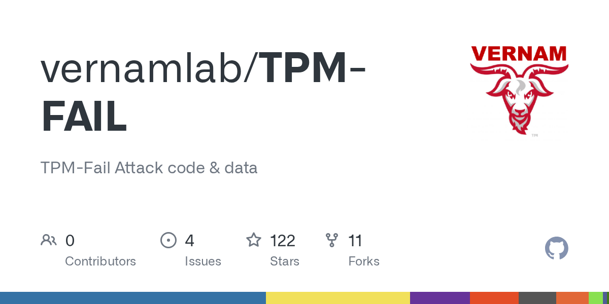

Here’s a link to their GitHub where they apparently will release code you can test.
