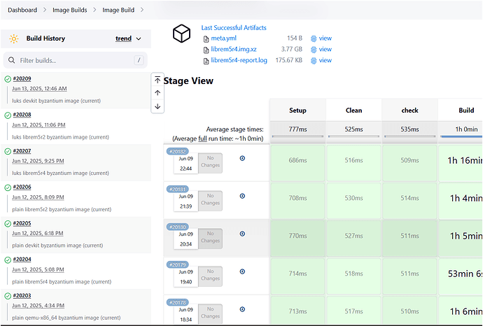

On Jenkins (Image Build [Image Builds] [Jenkins]) select the build number that you want and download the .xz file. In your case, it would be either #20207 or #20204

Ok, so: downloaded the #20207 image build from Jenkins, burnt it onto the 256GB SD-card, replaced it in my powered-off phone, turned it on whilst pressing Vol Down, green LED lit and Librem 5 splash page displayed; then, was asked for password, gave the default ‘123456’, and the Encrypting Filesystem Please Wait screen appeared. The phone has now been on it for the past 10 minutes. How long should this take?
OK, sorry, jumped the gun. I’m in-- update to follow!
Aaand it worked!
