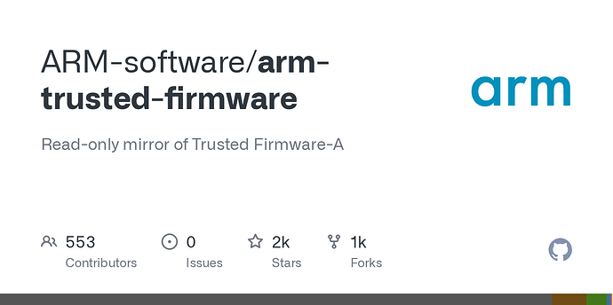

ATF:

ATF (and NXP firmware) is part of u-boot image, so you’ll have to build it by yourself. And that’s pretty much it, there’s nothing more to it. Of course, since I don’t think anybody has tested the latest upstream releases on the L5 you’ll have to test it and deal with possible regressions on your own, should there be any.
Note that the used ATF is NXP’s fork. I don’t remember whether mainline ATF is supposed to be fully operational.
