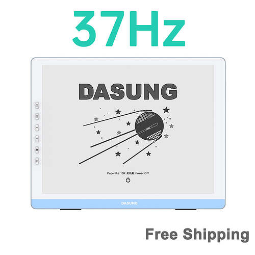

Specific use case: When not a phone, I’d love for my Liberty Phone to be a dedicated writing platform (LibreOffice Writer, sync via P-Cloud). My Monitor is a Dasung 13” e-Ink monitor and the random hub I have laying around from Amazon isn’t doing the trick); however, neither is plugging the monitor directly into the phone doing it.

Thank you, @irvinewade . Even knowing that hub exists on Puri.sm I can’t find it, except via your link. I edited my post to include the link to the monitor.
The product description seems to be ambiguous about Linux compatibility. That could be in part due to “lost in translation”. Are you using this monitor successfully with Linux at all?
It doesn’t spell out what HDMI version is required (if using the HDMI port).
The combination of resolution (“3K”) and refresh rate (37 Hz) is somewhat demanding. I guarantee you that some USB-C to HDMI adapters (which by extension includes some USB-C docks) will not support that. So you would verify 4K/60Hz support in the video source and in any intervening adapter or hub/dock.
Yes, it works with Pop!_OS.

Puri.sm support replied that the Dasung monitor does not support DisplayPort alt-mode 1.3, which the Liberty phone requires.
