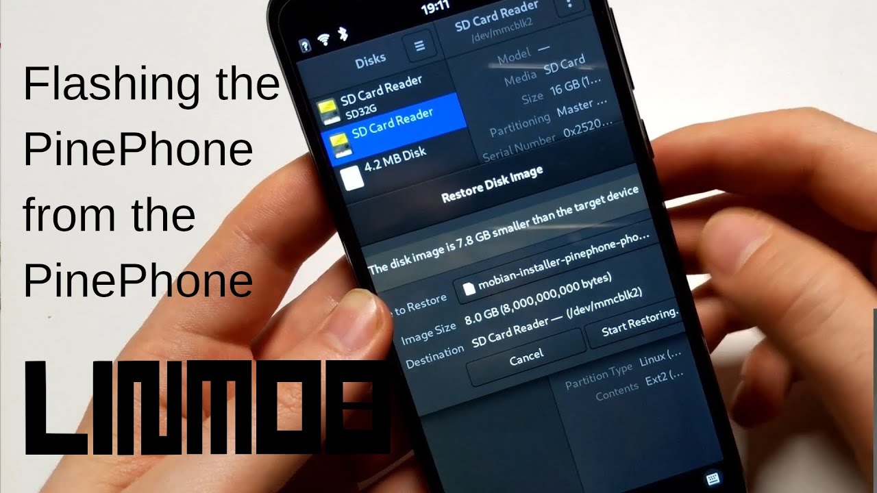

@prolog You can probably do everything!
Thx but this video doesn’t show PP USB interconnection. It shows using a PP to flash an on OS to an SD card and then booting the new OS from the same PP from the SD card. Then downloading another OS and flashing it to the PP’s internal eMMC and booting it.
Edit: there is a video from Purism showing an L5 that connects to PCs via USB OTG as USB storage and let the PC boot live OSs directly from the L5 and other very cool stuff. I don’t know in which state this development is, but will use it when its there and I have the phone. :slight_smile:
