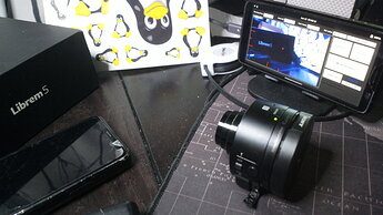

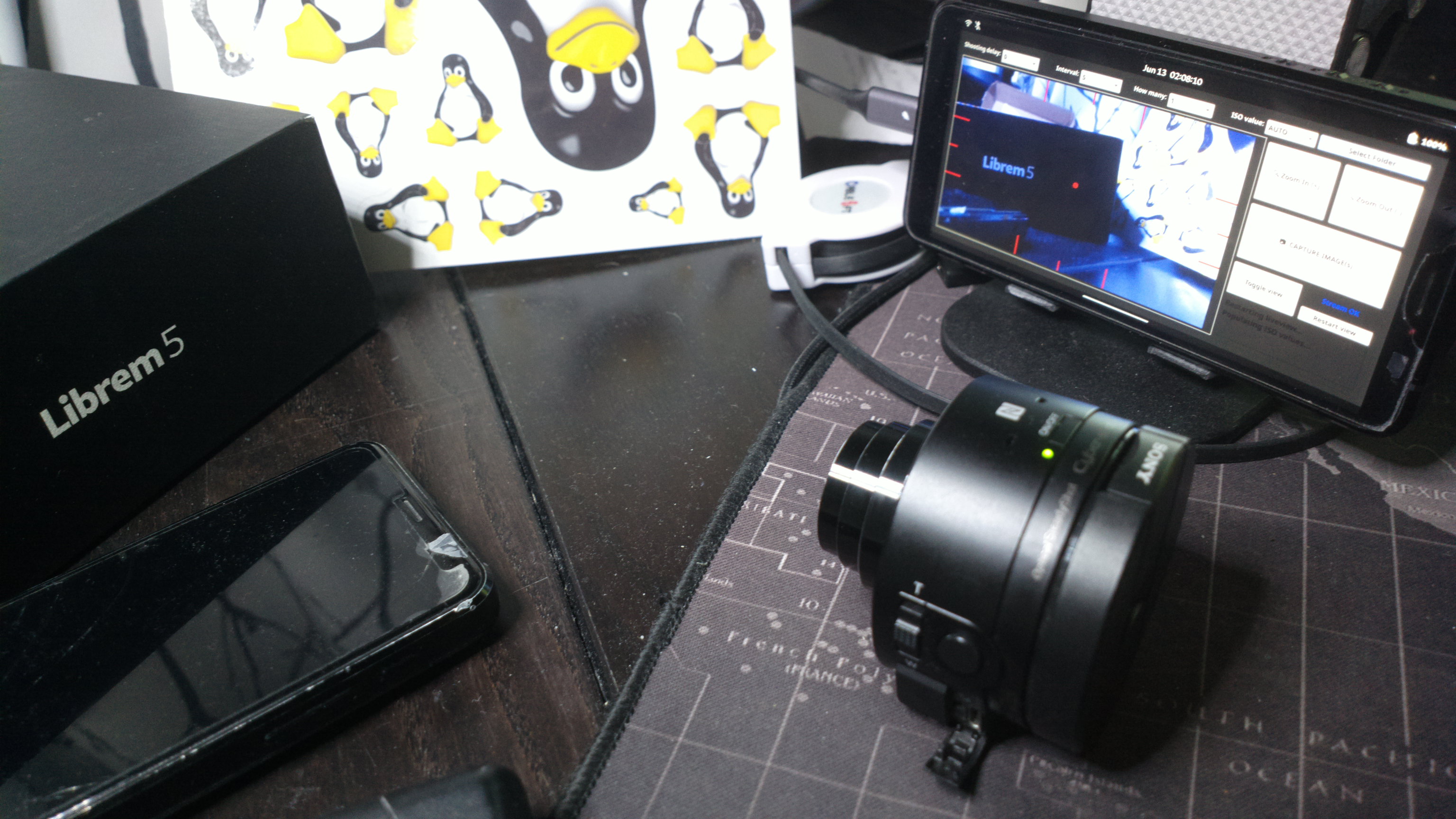

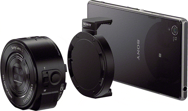

Using a SONY QX10 (and QX100) lenscamera with L5 possible!
I played around with that old PoC for a while but not got some time in my hands and polished the script enough to dare paste it for anyone to use (the polishing part was an interesting one as I’ve never worked with python and now it’s gone from 381 lines and 15729 characters to 1158 and 51250 with comments). If anyone wants a camera user interface that’s made for and tested to work with Librem 5 (testing is ongoing and it’s likely I’ll edit and tweak this post in the coming days), here’s one, although it should run in other (linux) phones too. It’s easy to run when you set up a .desktop and an icon to sun it like any normal GUI app, you just have to have the camera connected via wifi first and preferably set zoom to 150% and use Mobile-Settings compositor setting on it.

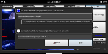

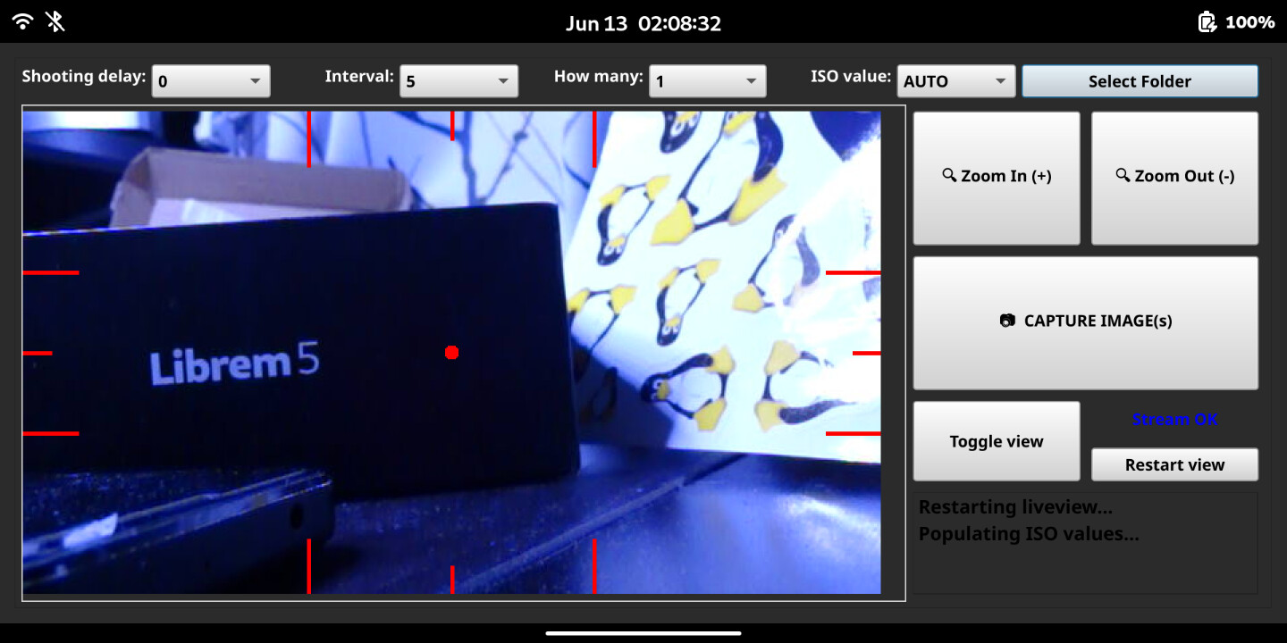

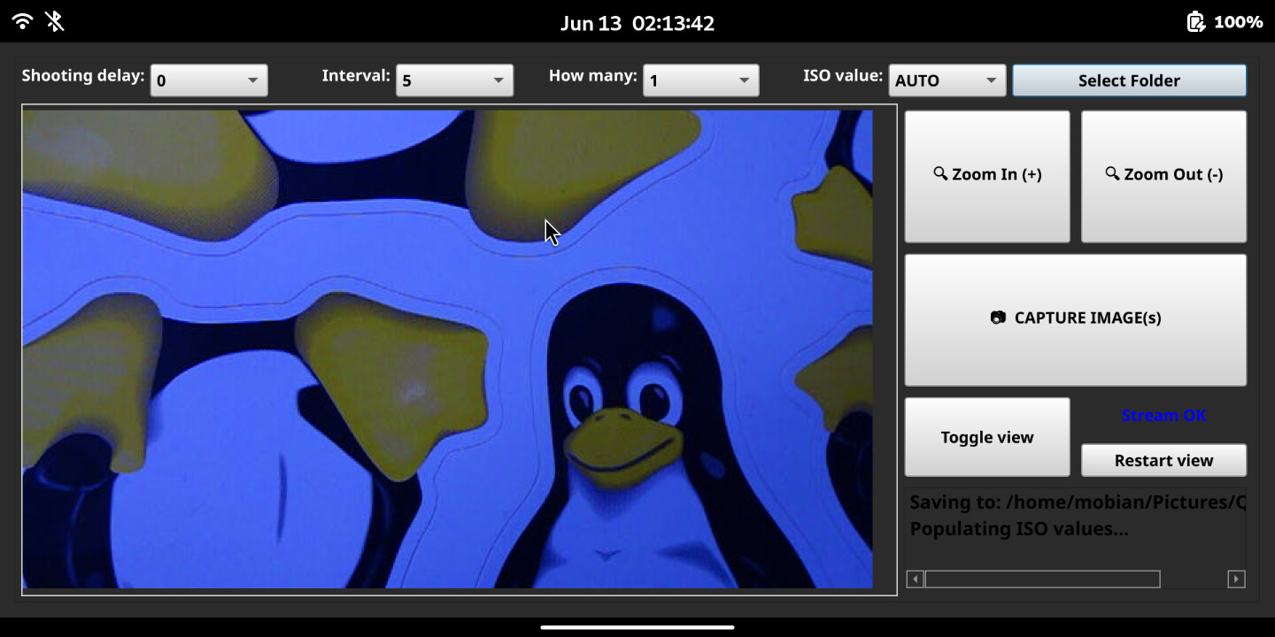

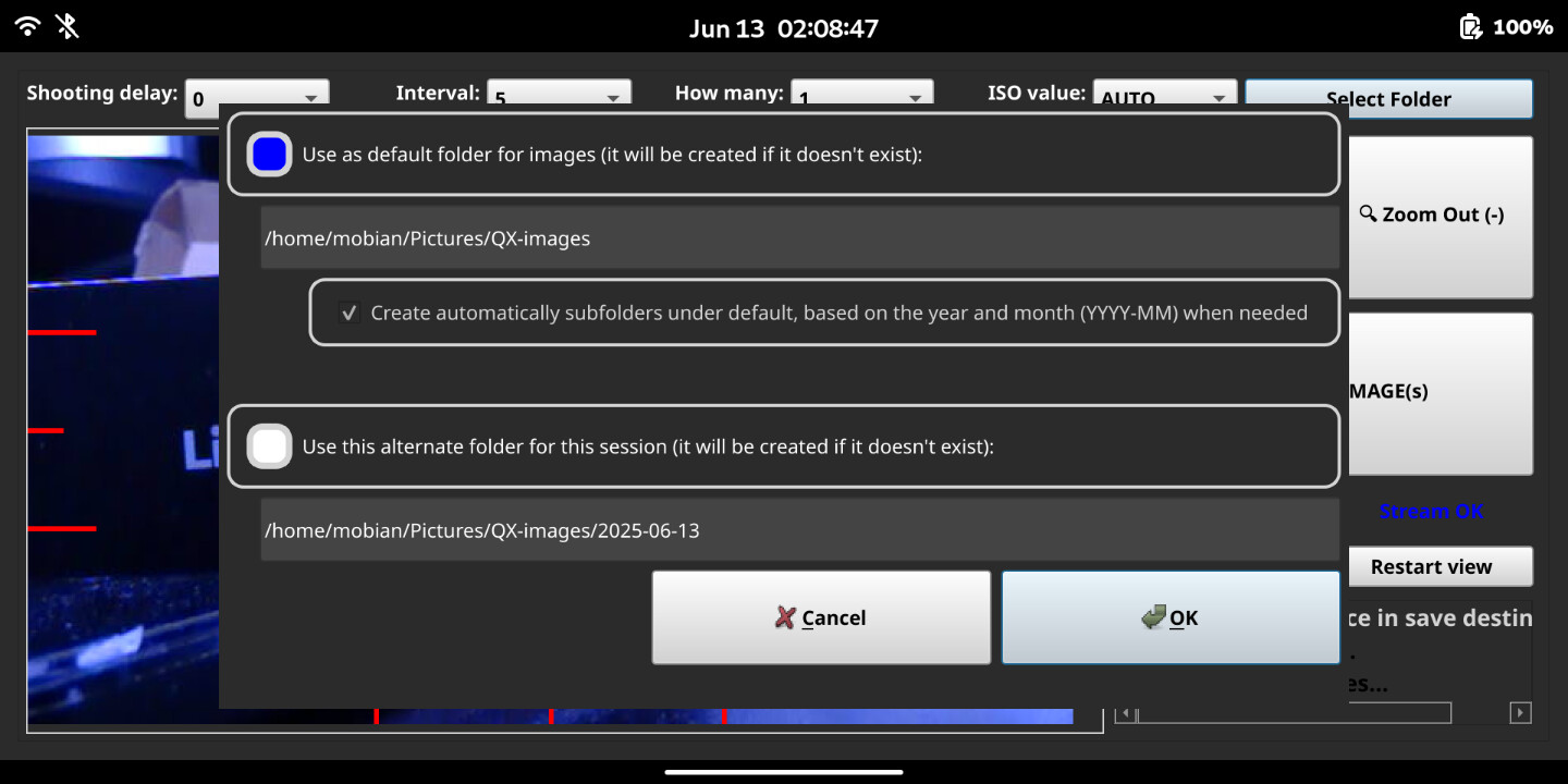

This QX-Cam script got zooms and ISO values. I added a toggle for helper sights and center dot. There are options for timedelays, intervals and and how many pics you want the camera to take (while you go for some tea or something). And based on some old thread here, I even made a more complicated save folder setting dialog and file renaming to my liking. And a bunch of checks and warnings, so you get feedback from it. Script code is at the end fo this post.
It’s definitely better quality cam than the one in the phone, but it’s a bit slow due to the wifi/http-based connection (5m between cam and phone seems possible). I may start a “fork” of this later on to explore alternatives. This is intentionally just a straight forward camera with a layout that has buttons that adult fingers should easily use. It’s just for landscape use (havent’ implemented portrait mode rotation or anything like that).
(the lighting on my desktop was bad, that’s why it looks a bit blue)
ZUR_LENSMOUNT-1
Script code here

        self.takePicBtn = QPushButton("📷  CAPTURE IMAGE(s)")
        zoomInBtn = QPushButton("🔍 Zoom In (+)")
        zoomOutBtn = QPushButton("🔍 Zoom Out (-)")
        self.connIndicator = QLabel("NO stream")
        self.connIndicator.setAlignment(Qt.AlignCenter)
        self.connIndicator.setStyleSheet("color: blue; font-weight: bold; font-size: 1.2em;")
        self.ISOComboBox = QComboBox(self)
        # livestream view
        self.imgDisplay = ImageDisplay()
        self.imgDisplay.setStyleSheet("border: 1px solid lightgrey;")  # for debugging
        self.imgDisplay.setSizePolicy(QSizePolicy.Expanding, QSizePolicy.Expanding)
        # Overlay toggle
        self.overlayToggleBtn = QPushButton("Toggle view")
        self.overlayToggleBtn.setStyleSheet("background-color: lightgray; color: black; font-weight: bold; font-size: 1.2em;")
        self.overlayToggleBtn.setMinimumHeight(self.ISOComboBox.sizeHint().height())
        self.overlayToggleBtn.clicked.connect(self.imgDisplay.toggleOverlay)
        for btn in [self.takePicBtn, zoomInBtn, zoomOutBtn, self.overlayToggleBtn]:
            btn.setStyleSheet("background-color: lightgray; color: black; font-weight: bold; font-size: 1.5em;")
        # Restart view button
        self.restartViewBtn = QPushButton("Restart view")
        self.restartViewBtn.setStyleSheet("background-color: lightgray; color: black; font-weight: bold; font-size: 1.2em;")
        self.restartViewBtn.setMinimumHeight(self.ISOComboBox.sizeHint().height())
        self.restartViewBtn.clicked.connect(self.restartLiveview)
        # Message list
        self.messageList = QListWidget(self)
        font = QFont()
        font.setPointSizeF(self.font().pointSizeF() * 1.2)
        self.messageList.setFont(font)
        self.messageList.setStyleSheet("color: lightgray; font-weight: bold;")
        self.messageList.setVerticalScrollBarPolicy(Qt.ScrollBarAsNeeded)
        self.messageList.setHorizontalScrollBarPolicy(Qt.ScrollBarAsNeeded)
        self.messageList.setMinimumHeight(self.messageList.sizeHintForRow(0) * 4 + 8)
        # Layout
        controlLayout = QGridLayout()
        controlLayout.setSpacing(8)
        controlLayout.setContentsMargins(5, 5, 5, 5)
        controlLayout.addWidget(zoomInBtn, 0, 0)
        controlLayout.addWidget(zoomOutBtn, 0, 1)
        controlLayout.addWidget(self.takePicBtn, 1, 0, 1, 2)
        controlLayout.addWidget(self.overlayToggleBtn, 3, 0, 2, 1)
        controlLayout.addWidget(self.connIndicator, 3, 1)
        controlLayout.addWidget(self.restartViewBtn, 4, 1)
        controlLayout.addWidget(self.messageList, 5, 0, 1, 2)
        # Timed capture controls with labels
        self.startDelayLabel = QLabel("Shooting delay:")
        self.startDelayCombo = QComboBox(self)
        self.startDelayCombo.addItems(["0", "5", "10", "30", "60", "600", "1800"])
        self.intervalLabel = QLabel("Interval:")
        self.intervalCombo = QComboBox(self)
        self.intervalCombo.addItems(["5", "10", "30", "60", "120", "300", "600"])
        self.howManyLabel = QLabel("How many:")
        self.howManyCombo = QComboBox(self)
        self.howManyCombo.addItems(["1", "3", "5", "7", "10", "20", "30", "60", "120", "250", "500"])
        # Apply consistent style
        for combo in [self.startDelayCombo, self.intervalCombo, self.howManyCombo]:
            combo.setStyleSheet("background-color: lightgray; color: black; font-weight: bold; font-size: 1.2em;")
            combo.setMinimumHeight(self.ISOComboBox.sizeHint().height())
        for label in [self.startDelayLabel, self.intervalLabel, self.howManyLabel]:
            label.setAlignment(Qt.AlignRight)
            label.setStyleSheet("color: white; font-weight: bold; font-size: 1.2em;")
        # Main layout
        mainLayout = QGridLayout()
        mainLayout.setSpacing(0)
        mainLayout.setContentsMargins(4, 4, 4, 4) # Reduce outer margins
        # Row 0: All label-dropdown pairs in a single row
        timingLayout = QGridLayout()
        timingLayout.setContentsMargins(0, 0, 5, 5)
        timingLayout.setSpacing(4)
        # Add label-dropdown pairs side by side
        timingLayout.addWidget(self.startDelayLabel, 0, 0)
        timingLayout.addWidget(self.startDelayCombo, 0, 1)
        timingLayout.addWidget(self.intervalLabel, 0, 2)
        timingLayout.addWidget(self.intervalCombo, 0, 3)
        timingLayout.addWidget(self.howManyLabel, 0, 4)
        timingLayout.addWidget(self.howManyCombo, 0, 5)
        # Add ISO label and dropdown (initially styled as background)
        self.isoLabel = QLabel("ISO value:")
        self.isoLabel.setAlignment(Qt.AlignRight)
        self.isoLabel.setStyleSheet("color: white; font-weight: bold; font-size: 1.2em;")
        self.ISOComboBox.setStyleSheet("background-color: #2b2b2b; color: #2b2b2b; font-weight: bold; font-size: 1.2em;")
        self.ISOComboBox.setMinimumHeight(self.startDelayCombo.sizeHint().height())
        timingLayout.addWidget(self.isoLabel, 0, 6)
        timingLayout.addWidget(self.ISOComboBox, 0, 7)
        self.setFolderBtn = QPushButton("Select Folder")
        self.setFolderBtn.setStyleSheet("background-color: lightgray; color: black; font-weight: bold; font-size: 1.2em;")
        self.setFolderBtn.setMinimumHeight(self.ISOComboBox.sizeHint().height())
        self.setFolderBtn.clicked.connect(self.openFolderDialog)
        timingLayout.addWidget(self.setFolderBtn, 0, 8, 1, 2)
        # Add the full row to the main layout, spanning both columns
        mainLayout.addLayout(timingLayout, 0, 0, 1, 2)
        # Add image display, updated v3-3
#        mainLayout.addLayout(self.modeGrid, 0, 0, 1, 2)    # Top row removed
        mainLayout.addWidget(self.imgDisplay, 1, 0)        # Below mode buttons
        mainLayout.addLayout(controlLayout, 1, 1)          # Controls beside image
        # Stretch factors to balance space
        mainLayout.setColumnStretch(0, 4)  # Image display
        mainLayout.setColumnStretch(1, 1)  # Controls
        mainLayout.setRowStretch(1, 1)  # Image row, updated v3-3
#        self.setLayout(mainLayout)  # replace to try scrollable window to use keyboard safely to layout
        from PyQt5.QtWidgets import QScrollArea
        # Wrap the main layout in a scrollable container
        scroll_area = QScrollArea()
        scroll_area.setWidgetResizable(True)
        scroll_area.setVerticalScrollBarPolicy(Qt.ScrollBarAsNeeded)
        scroll_area.setHorizontalScrollBarPolicy(Qt.ScrollBarAsNeeded)
        # Create a container widget to hold the main layout
        container = QWidget()
        container.setLayout(mainLayout)
        container.setContentsMargins(0, 0, 0, 0)  # Ensure no extra padding
        # Set the container as the scroll area's widget
        scroll_area.setWidget(container)
        # Create a new top-level layout and add the scroll area to it
        outer_layout = QVBoxLayout()
        outer_layout.addWidget(scroll_area)
        # Set the outer layout as the main layout of the dialog
        self.setLayout(outer_layout)
        self.resize(1440, 680)  # Librem5 screen size is width: 720 height: 1440, about 5% is used by top and bottom bars when horizontal, so the window is a bit smaller (couldn't find the valueso had to estimate it)
#        self.setFixedSize(1440, 680)  # prevents rotation changing the layout (not really)
        self.setStyleSheet("background-color: #2b2b2b;")
        # Signal connections
        self.takePicBtn.clicked.connect(self.takePic)
        zoomInBtn.pressed.connect(self.zoomIn)
        zoomInBtn.released.connect(self.zoomInStop)
        zoomOutBtn.pressed.connect(self.zoomOut)
        zoomOutBtn.released.connect(self.zoomOutStop)
        self.startDelayCombo.currentTextChanged.connect(self.checkBatteryReminder)
        self.intervalCombo.currentTextChanged.connect(self.checkBatteryReminder)
        self.howManyCombo.currentTextChanged.connect(self.checkBatteryReminder)
        self.howManyCombo.currentTextChanged.connect(self.checkDiskSpaceEstimate)
        #Button height limits
        # Row 0: Zoom buttons
        zoomInBtn.setMinimumHeight(100)
        zoomOutBtn.setMinimumHeight(100)
        zoomInBtn.setMinimumWidth(125)
        zoomOutBtn.setMinimumWidth(125)
        # Row 1: Take Picture button (spans both columns)
        self.takePicBtn.setMinimumHeight(100)
        self.takePicBtn.setMinimumWidth(250)
        # Row 2: ISO controls
        self.isoLabel.setMinimumHeight(20)
        self.ISOComboBox.setMinimumHeight(20)
        # Row 3: Overlay toggle and connection indicator
        self.overlayToggleBtn.setMinimumHeight(self.restartViewBtn.sizeHint().height() * 2 +10)
        self.connIndicator.setMinimumHeight(20)
        self.ISOComboBox.currentTextChanged.connect(self.handleISOChange)
        QTimer.singleShot(3100, self.tryPopulateControls)
        self.monitorConnection()

    def openFolderDialog(self):
        from PyQt5.QtWidgets import QButtonGroup, QMessageBox
        from PyQt5.QtCore import QStandardPaths
        import re
        dialog = QDialog(self)
        dialog.setWindowTitle("Select Save Folder")
        dialog.setGeometry(self.imgDisplay.geometry())
        layout.setAlignment(Qt.AlignTop)
        layout.setContentsMargins(5, 5, 5, 5)  # or (0, 0, 0, 0)
        layout.setSpacing(5)
        # Load config or fallback
        fallback_folder = QStandardPaths.writableLocation(QStandardPaths.PicturesLocation)
        config = {}
        try:
            if os.path.exists(self.config_path):
                with open(self.config_path, "r") as f:
                    config = json.load(f)
        except Exception:
            self.logMessage("Failed to read config. Using fallback folder.", is_error=True)
        user_defined_default = config.get("saveFolder", self.defaultSaveFolder)
        auto_subfolder_enabled = config.get("autoSubfolder", False)
        # Radio group
        radio_group = QButtonGroup(dialog)
        # Default folder option
        default_radio = QRadioButton("Use as default folder for images (it will be created if it doesn't exist):")
        default_radio.setStyleSheet("""
            QRadioButton::indicator {
                width: 20px;
                height: 20px;
                border-radius: 10px;
                border: 4px solid lightgray;
                background-color: white;
            QRadioButton::indicator:checked {
                background-color: blue;
            QRadioButton {
                font-size: 2.5em;
                color: white;
                border: 2px solid lightgray;
                padding: 10px 10px;
        default_radio.setChecked(True)
        radio_group.addButton(default_radio)
        default_path_input = QLineEdit(user_defined_default)
        default_path_input.setStyleSheet("font-size: 2.5em; color: white; background-color: #444; margin-left: 20px;")
        default_path_input.setMinimumHeight(40)
        # Auto-subfolder checkbox
        add_subfolder = QCheckBox("Create automatically subfolders under default, based on the year and month (YYYY-MM) when needed")
        add_subfolder.setStyleSheet("font-size: 2.0em; color: lightgray; margin-left: 50px; border: 2px solid lightgray; border-radius: 10px; padding: 10px 16px;")
        add_subfolder.setMinimumHeight(30)
        add_subfolder.setChecked(auto_subfolder_enabled)
        # Session folder option
        session_radio = QRadioButton("Use this alternate folder for this session (it will be created if it doesn't exist):")
        session_radio.setStyleSheet("""
                width: 20px;
                height: 20px;
            QRadioButton {
                font-size: 2.5em;
                color: white;
                padding: 10px 10px;;
        radio_group.addButton(session_radio)
        session_suggestion = os.path.join(user_defined_default, time.strftime("%Y-%m-%d"))
        session_path = QLineEdit(session_suggestion)
        session_path.setStyleSheet("font-size: 2.5em; color: white; background-color: #444; margin-left: 20px;")
        session_path.setMinimumHeight(40)
        # Layouts
        layout.addWidget(default_radio)
        layout.addWidget(default_path_input)
        layout.addWidget(add_subfolder)
        layout.addSpacing(30)
        layout.addWidget(session_radio)
        layout.addWidget(session_path)
        # Buttons
        buttons = QDialogButtonBox(QDialogButtonBox.Ok | QDialogButtonBox.Cancel)
        buttons.setStyleSheet("QPushButton { background-color: lightgray; color: black; font-weight: bold; font-size: 2.0em; min-height: 50px; min-width: 200px; }")
        layout.addWidget(buttons)
# check and prevend recursive nesting of dated folders
        def is_recursive_folder(path):
            parts = os.path.normpath(path).split(os.sep)
            date_pattern = re.compile(r"\d{4}-\d{2}(-\d{2})?$")
            # Only check the parent folders, not the last one
            for part in parts[:-1]:
                if date_pattern.fullmatch(part):
                    return True
            return False
        def on_accept():
            base = user_defined_default
            try:
                if default_radio.isChecked():
                    base = default_path_input.text().strip()
                    if not base:
                        raise ValueError("Default folder path cannot be empty.")
                    if add_subfolder.isChecked():
                        if is_recursive_folder(base):
                            raise ValueError("Recursive folder name error")
                        base = os.path.join(base, time.strftime("%Y-%m"))
                    self.saveFolder = base
                    os.makedirs(self.saveFolder, exist_ok=True)
                    if not os.access(self.saveFolder, os.W_OK):
                        raise PermissionError("Selected folder is not writable.")
                    # Save config
                    with open(self.config_path, "w") as f:
                        json.dump({
                            "saveFolder": default_path_input.text().strip(),
                            "autoSubfolder": add_subfolder.isChecked()
                        }, f)
                elif session_radio.isChecked():
                    session = session_path.text().strip()
                    if not session:
                        raise ValueError("Session folder path cannot be empty.")
                    if is_recursive_folder(session):
                    self.saveFolder = session
                self.logMessage(f"Saving to: {self.saveFolder}")
                dialog.accept()
            except Exception as e:
                self.logMessage(f"{e}\nUsing fallback folder: {fallback_folder}", is_error=True)
                self.saveFolder = fallback_folder
                dialog.reject()
        buttons.accepted.connect(on_accept)
        buttons.rejected.connect(dialog.reject)
        dialog.setLayout(layout)
                # Show available disk space in selected folder
        try:
            check_path = default_path_input.text().strip()
            if default_radio.isChecked() and add_subfolder.isChecked():
                check_path = os.path.join(check_path, time.strftime("%Y-%m"))
                check_path = session_path.text().strip()
            if os.path.exists(check_path):
                _, _, free = shutil.disk_usage(check_path)
                free_mb = free // (1024 * 1024)
                color = "orange" if free_mb < 200 else "lightgray"
                item = QListWidgetItem(f"{free_mb}MB empty space in save destination.")
                item.setForeground(QColor(color))
                self.messageList.insertItem(0, item)
            self.logMessage(f"Disk space check failed: {e}", is_error=True)
        dialog.exec_()
