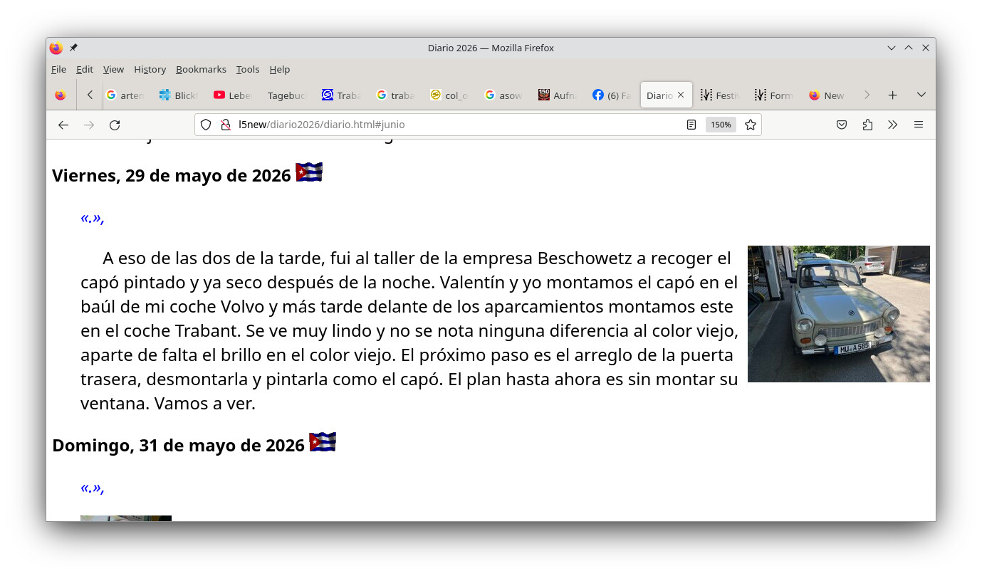

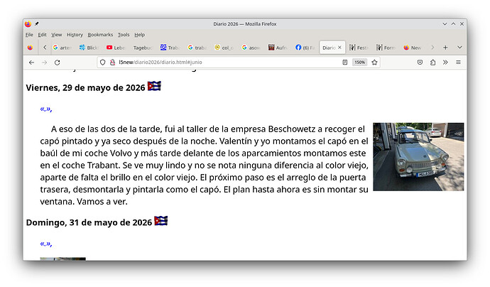

   From the FF browser in my laptop use:
   http://192.168.178.59/diario2026/diario.html
