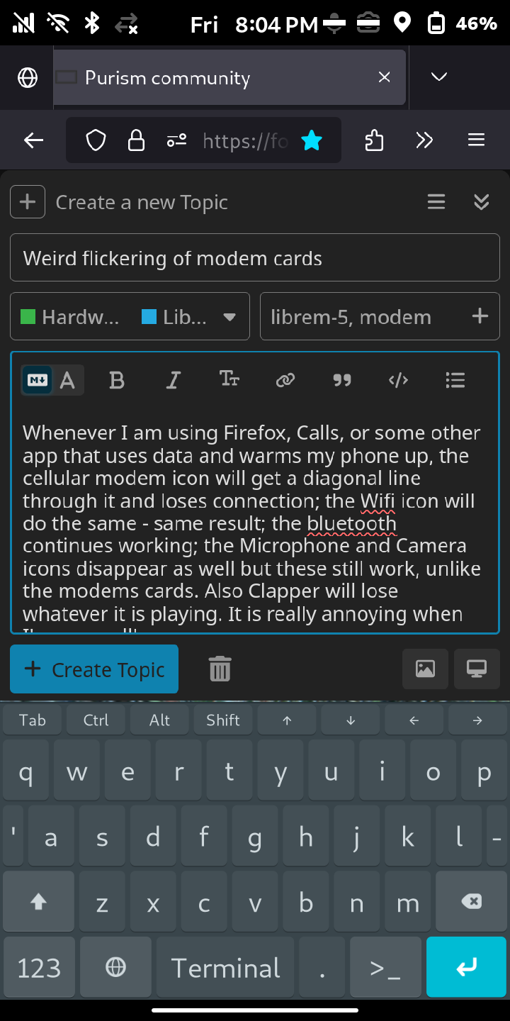

Whenever I am using Firefox, Calls, or some other app that uses data and warms my phone up, the cellular modem icon will get a diagonal line through it and loses connection; the Wifi icon will do the same - same result; the bluetooth continues working; the Microphone and Camera icons disappear as well but these still work, unlike the modems cards. Also Clapper will lose whatever it is playing. It is really annoying when I’m on a call!
The software switches do not work, power cycling the kill switches sometimes work, sometimes not.
Any thoughts?
