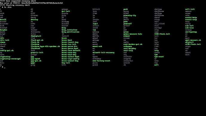

Given that I’m in a Gentoo LiveUSB environment (that took recovery shell in Heads because apparently /dev/sdb alone wasn’t detected) and it took some finagling to get here, I’m averse to tweaking things and rebooting in the dark and am hoping someone can clarify the boot process the Librem 14 uses out of the box with default Heads.

Yes, that’s right. Heads reads the GRUB configs to identify boot options, including the kernel, initrd, and command line, then kexecs into that kernel without invoking GRUB.
Your OS should still provide an initramfs. Heads loads it when kexec’ing into the OS kernel, and that initramfs needs to do its usual job of mounting root and continuing to boot from it.
