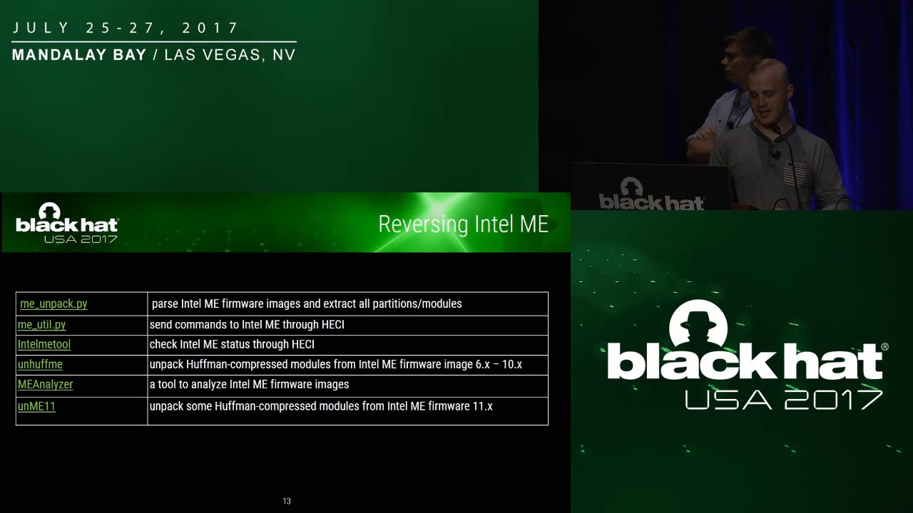

Flashing a malicious ME payload, such as one that will allow remote access is one of the scenarios.
Watch what you can do, as:
