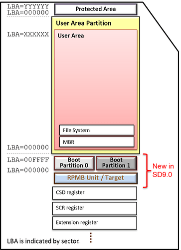

If you have a spare SD card that you don’t mind trashing, you could see whether it supports the actual SD card authenticated write security feature (RPMB), which would remove the need to bother to write-protect the disk with a switch .. but then for actually booting from it the boot firmware would need to support RPMB.

Very interesting! Sounds like you can permanently write-protect an SD card this way. As you said, you’d need to trash it if the ISO got stale, but at least then you probably don’t need to carry it with you 24/7.

Yes, that is one option within the functionality of an SD card - and for the cost of an SD card if holding an ISO, that might be perfectly feasible.
However RPMB is different. RPMB means that you can forever alter the contents provided that you possess the secret key (presumed to be strongly randomly generated and actually kept, you know, secret). It is a relatively small area (e.g. 4MB). It could form part of a secure boot solution e.g. hold a hash of the contents of the boot area, providing that the firmware knows to read the hash from the RPMB and then calculate the hash of the boot area and compare the two hashes before transferring control to the boot area.

Cool! 4MB is more than enough to at least store the hash. Granted you would need some special way to read the storage area, as presumably it’s not part of the normal storage. Probably I can find some tool to do this. (Then I have to authenticate the tool against supply chain attacks. Infinite rabbit hole but at least this is an improvement!)

Or you want something cryptographically strong, which solves both the write protect problem and the evil maid problem.
