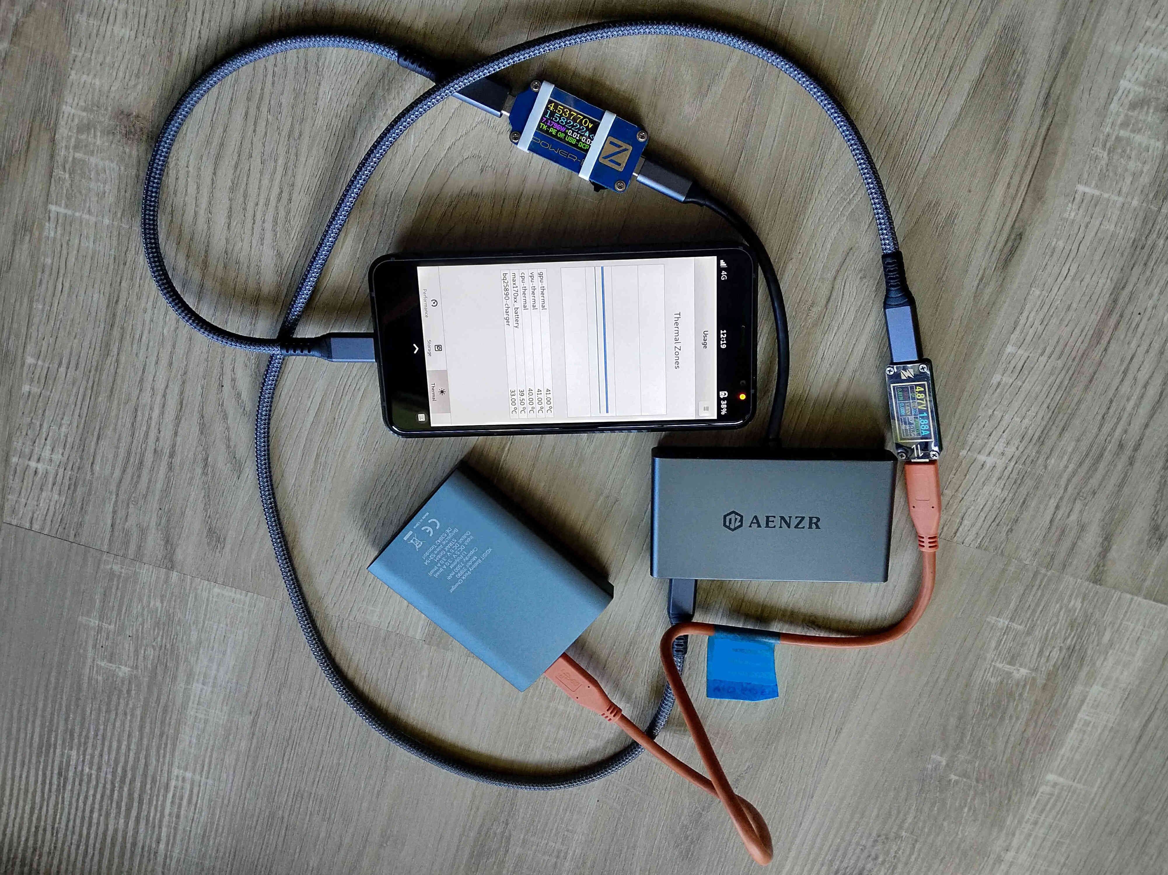

I think that might be expected. If the dock has HDMI out then I think it will forward the video to HDMI when the input USB-C is in DisplayPort altmode. Of course I could be wrong. You could find a dock that has enough functionality to forward the video via a USB-C output. However it is not only about the dock’s handling of video, it is also about how the dock reports things to the host.
If you want to investigate then you will need to use lsusb with a non-working dock and with a working dock - and for us you will need to clarify whether the docks have HDMI out.

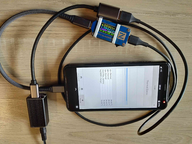

You are having right as, IMHO, having lower voltage and lower amperage during charging keeps overheating down (actually there is none). 4.8V/1400mA might serve as some orientation, especially when battery already above 50% (anything negotiated above 5.00V I actually and simply do not use), therefore I’d recommend using power supply (or power bank) providing 5.00V/1700mA, at least (actually cannot confirm or have no evidence that more than 5.00V/1900mA needed with the Librem 5, for any usage, although I recall seeing bursts with over 2.1A). With screen off (please note that Wi-Fi is not on, not consuming any power, therefore it is already achievable to have Librem 5 on standby with under 5.00V/0.2A, another guess of mine as just do not have time to proof this, but things are already looking good to me anyway):
If you turn off the L5 and plug it into the charger that came with the phone, then the L5 will trickle charge at 5V x 0.5A (2.5W). If you turn on the phone and plug it into a USB 2.0 port, then the current will also be 5V x 0.5A (2.5W), but the battery hardly charges at all at that level of current when the L5 is turned on, so I assume that all the current is being used to operate the device.
If you want to trickle charge the L5 while it is turned on, I would assume that you want it to use 5V x 1.0A (5W), because the L5 reduces the current to that level when it gets too hot while charging and the status light starts blinking. However, I don’t know how to manually set the charging level.
I would not assume nor try to use any power supply (charger) with max. output of 5V/1.5A or less (5V/1.0A) because those will overheat within relatively short time and probably catch fire ASAP (it might all of a sudden turn into very dangerous game). Please avoid such experiments if not familiar with power supply in usage, rather use compliant docking station in between of … or at least consider usage of at least 3A compliant converter (if about to reduce, from higher value only, power supply provided current for some purpose that is not supported officially): https://www.assmann.com/product-pdf/4016032468707?PL=en.
Again, please recheck twice which power supply connecting toward any smartphone and confirm your expectations with the expert opinion/address (open other relevant review, many very relevant ones present there):
My idea was to change a setting in the L5 to change the charging level to 1.0A, but as I said, I haven’t investigated how to do it.
Yes, any charger can be dangerous, if the L5 tries to pull more amps from the charger than it is designed to output, so people who are experimenting with other chargers should be monitoring the amperage to make sure that the L5 is negotiating the correct amperage limits with the charger. In my tests with other chargers, I watched the amps using a USB multimeter and checked the surface temperature of the charger to make sure it wasn’t overheating. I tried several different chargers with the L5 that were limited to a max of 0.5A, 2.0A and 3.0A at 5V, and they all stayed inside their limits. I didn’t try any chargers that supported higher amperage, because I was afraid that the L5 wouldn’t correctly negotiate to use lower amperage.
I cannot explain this (not at this moment) but I think that overheating belongs to the higher voltage that some power supply initially sends out toward the Librem 5. Meaning if power supply rated (actually measured) as 5.20V I’m not using it as it will increase charging temperature “significantly”.
What is important to me to write now is that I’m looking for (expecting) to get and see that when the charged BPP-L503 battery reached its full capacity at 4.20V (red LED light off) connected power supply should show 5.00V. This means that when charging starts with the Librem 5 battery capacity under, for example, 40% voltage shown/displayed (as connected and current delivered) there, on tester/multimeter used, should be within range between 4.7V and 4.8V, steadily increasing in parallel as the battery capacity increases.
P.S. Might be it is only about my “taste” but I’ll continue to research in this voltage range only (by trying to exclusively use power supplies that do not output voltage higher than 5.00V, the ones that I decide to connect to the Librem 5, but most of them I do not even consider to connect as experimenting much is not my preference either). I already have a very reliable PD power supply for the Librem 5, therefore this post.

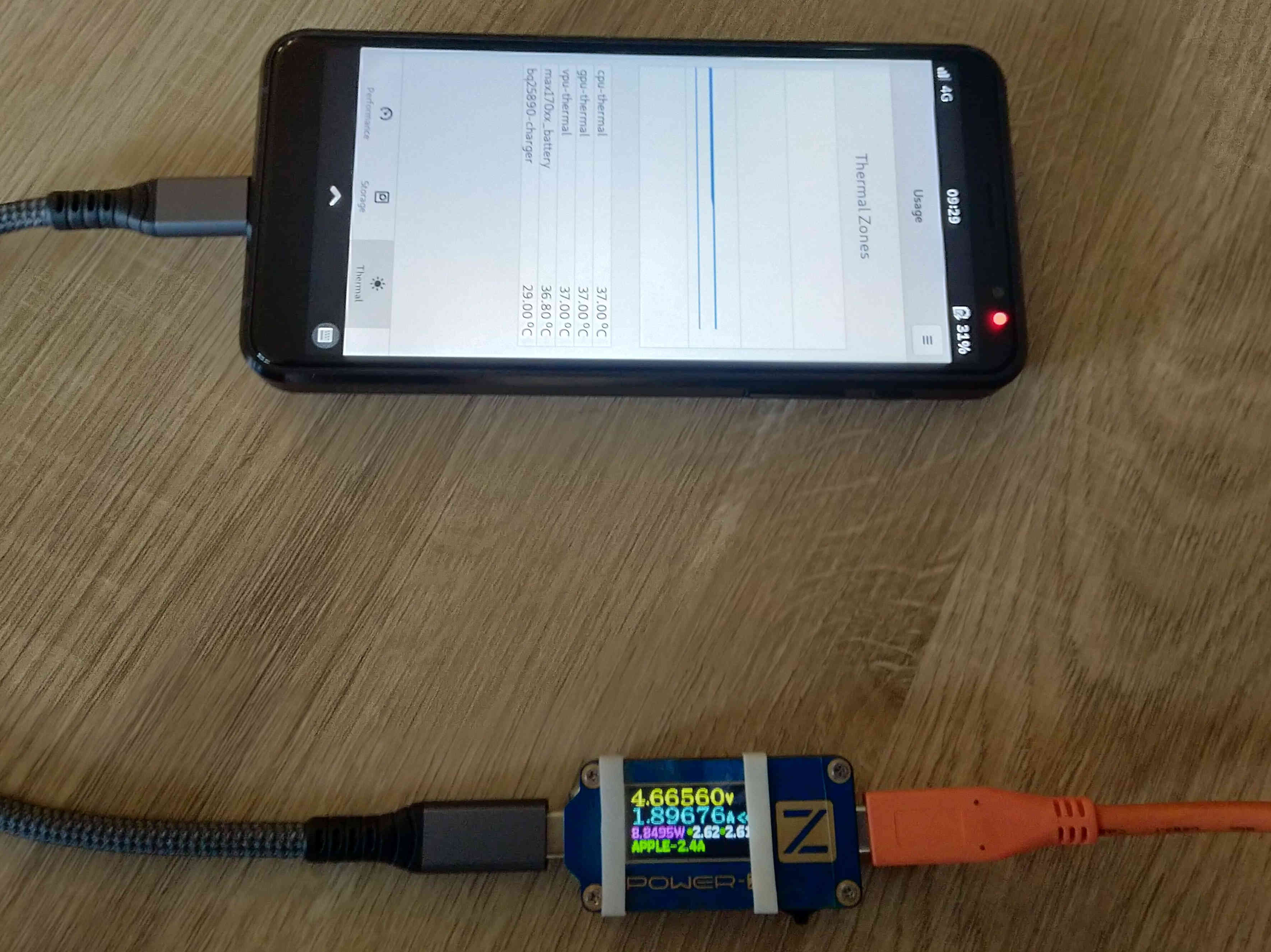

I saw several chargers that had a voltage of 5.20 when charging the L5, and I didn’t observe any overheating, but I wasn’t directly measuring the temperature of the charger and I relied on what the L5 reports as its temperature. My USB multimeter has a temperature function, but it is measuring the temperature of the wire between the charger and the L5.

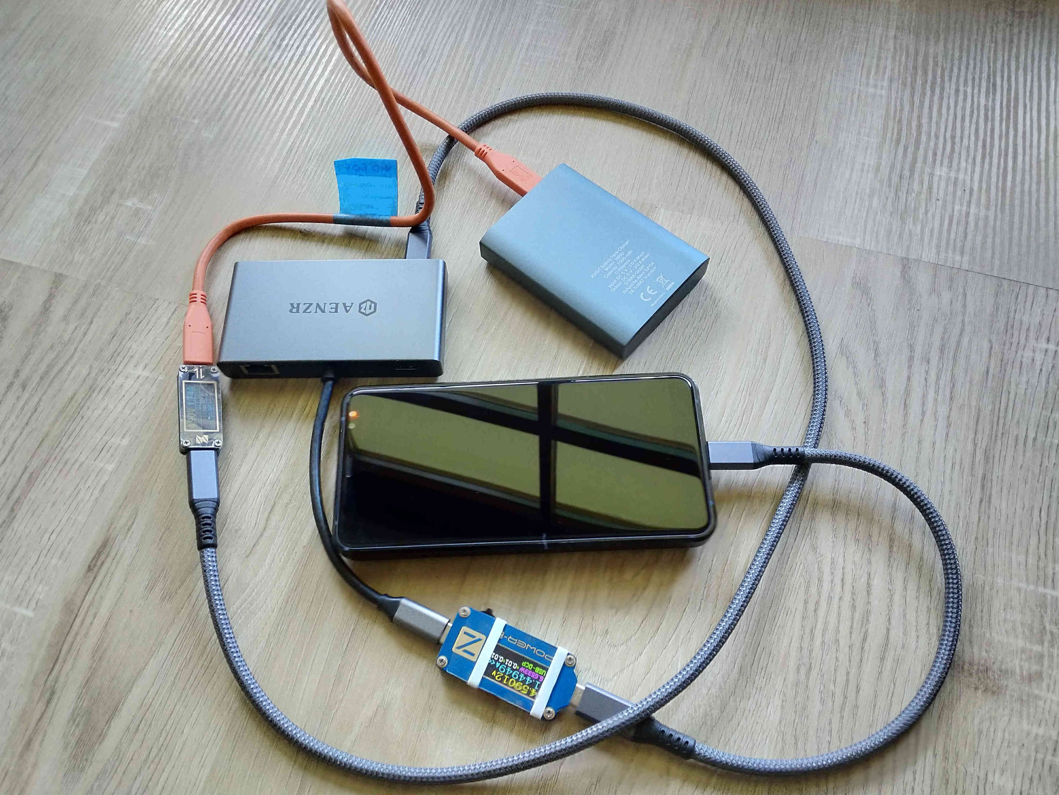

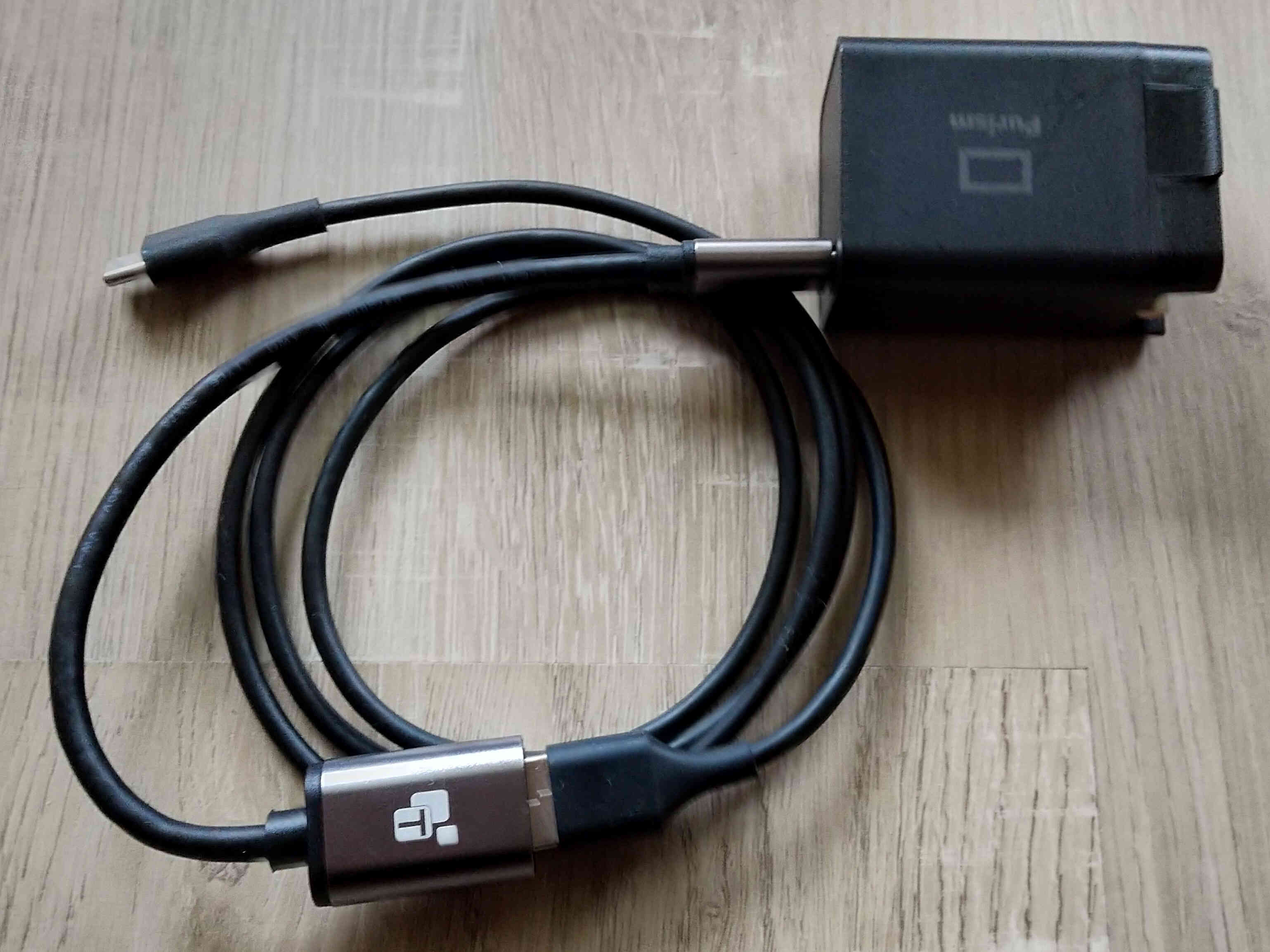

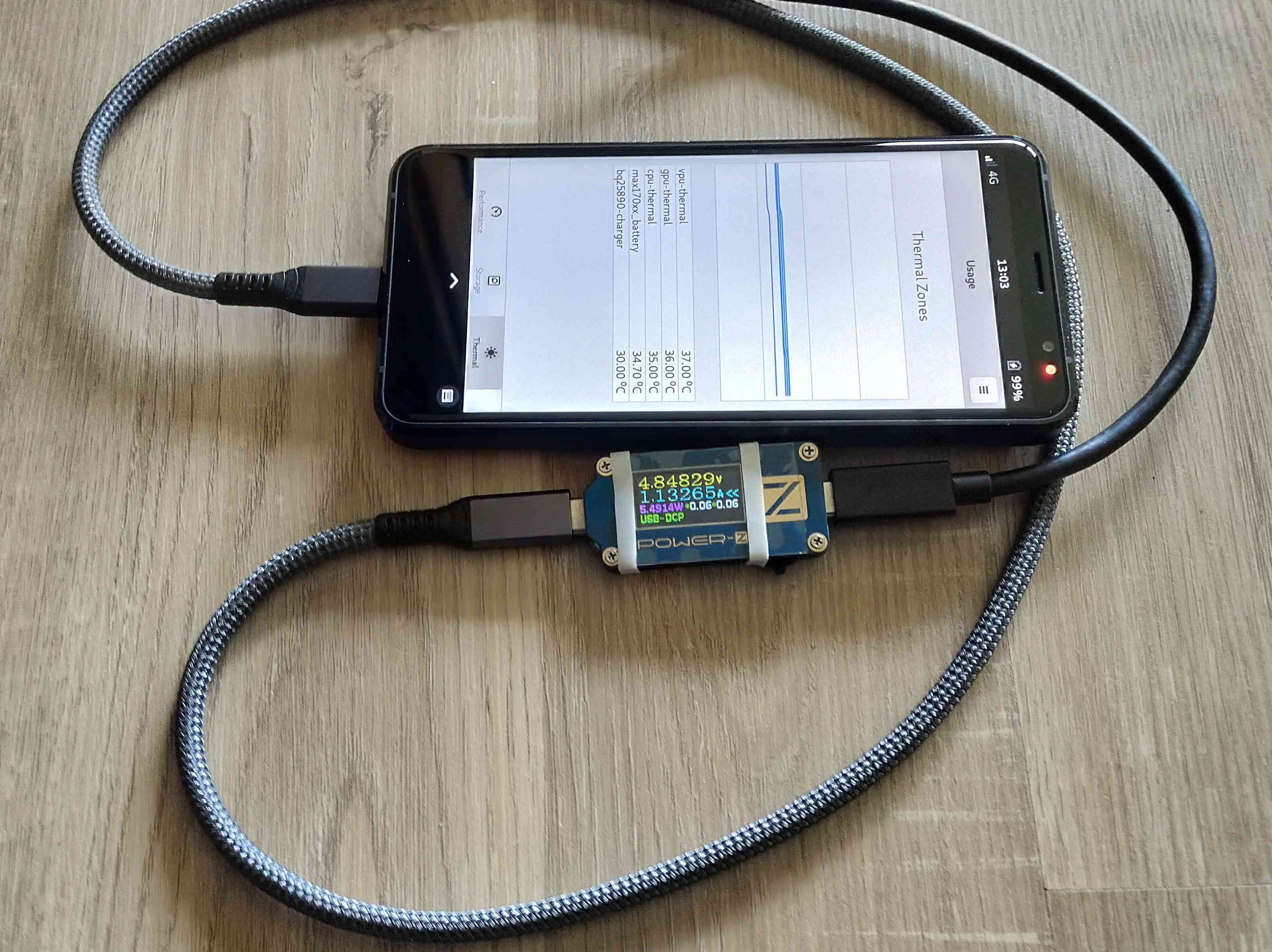

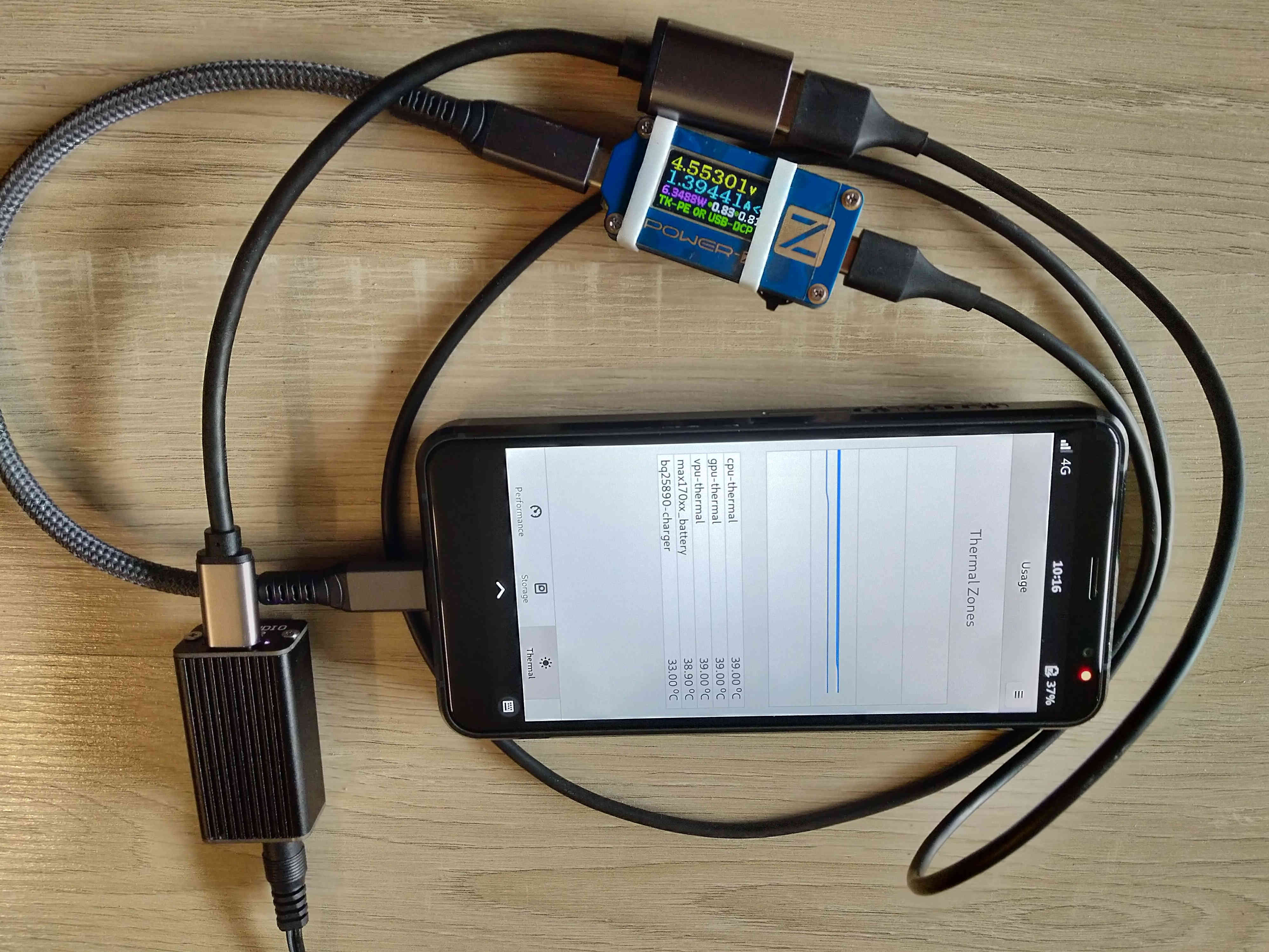

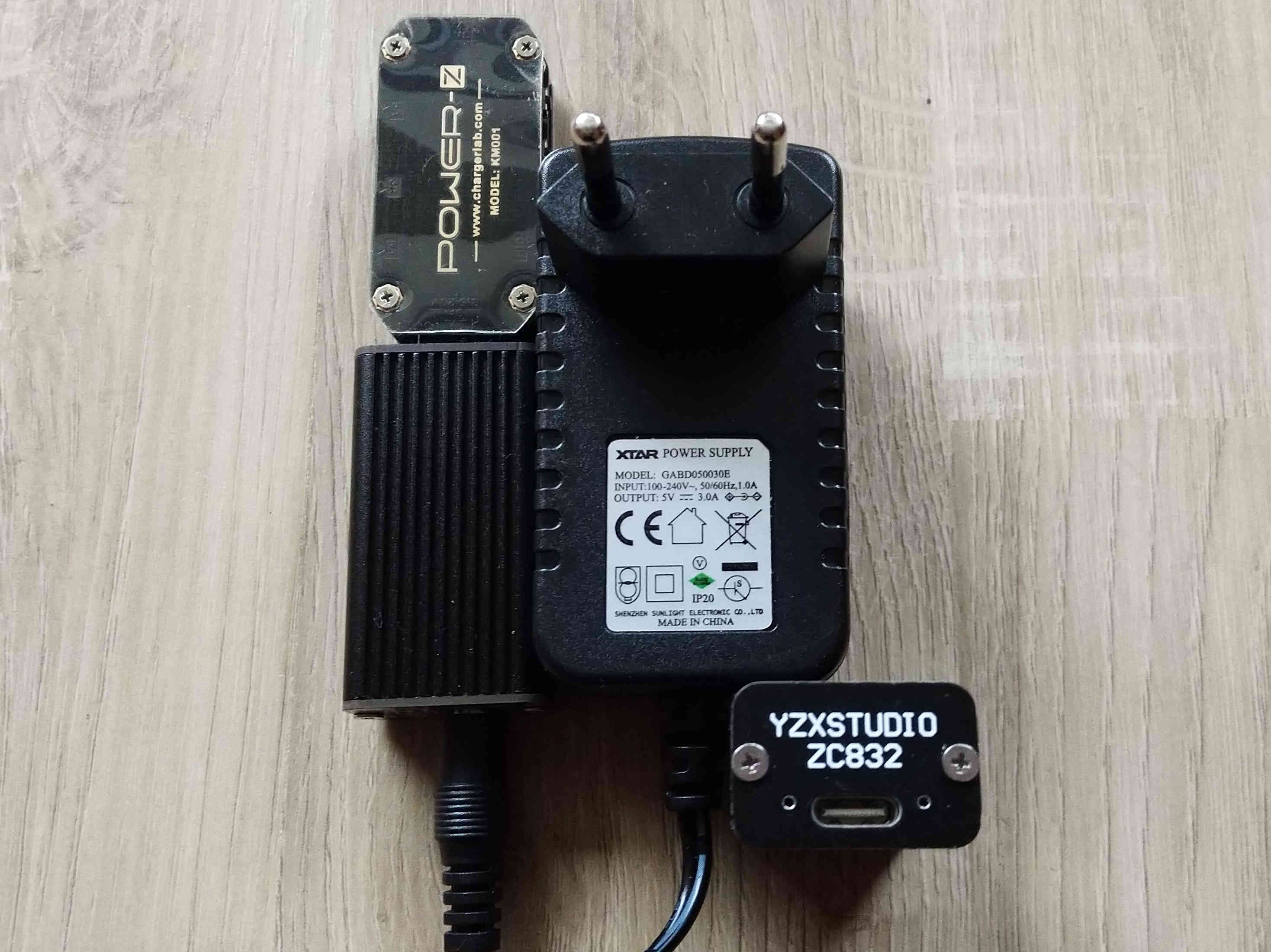

EDIT: For extended overview (ensuring/blocking to get output of 5.00V only), below picture shows small full protocol devices based around SW2305 controller (both of them). Sharing here while it is actually possessing very rare feature: its charging controller can recognize and work from provided 5V input and deliver output of 5.06V (without having any issues on transporting up to 3.0A, yet I do not recall that I tested ZC832 with my Librem 5):
EDIT II: Actually ZC832 (as above pictured power supply combo) charges well but the negotiated protocol isn’t my favorite (and therefore I’m not using it for this purpose, probably just because I cannot help myself in order to simply accept this shown negotiation protocol as some kind of advantage):

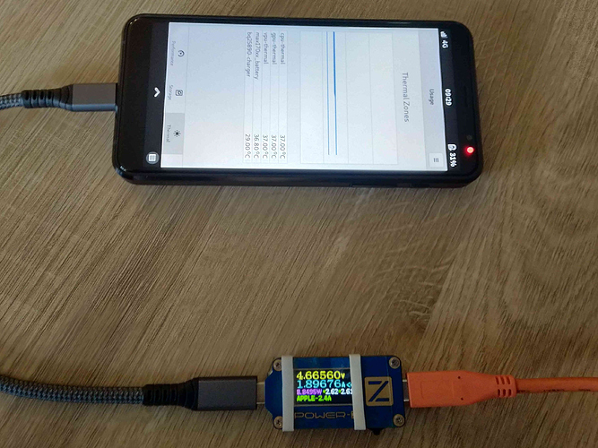

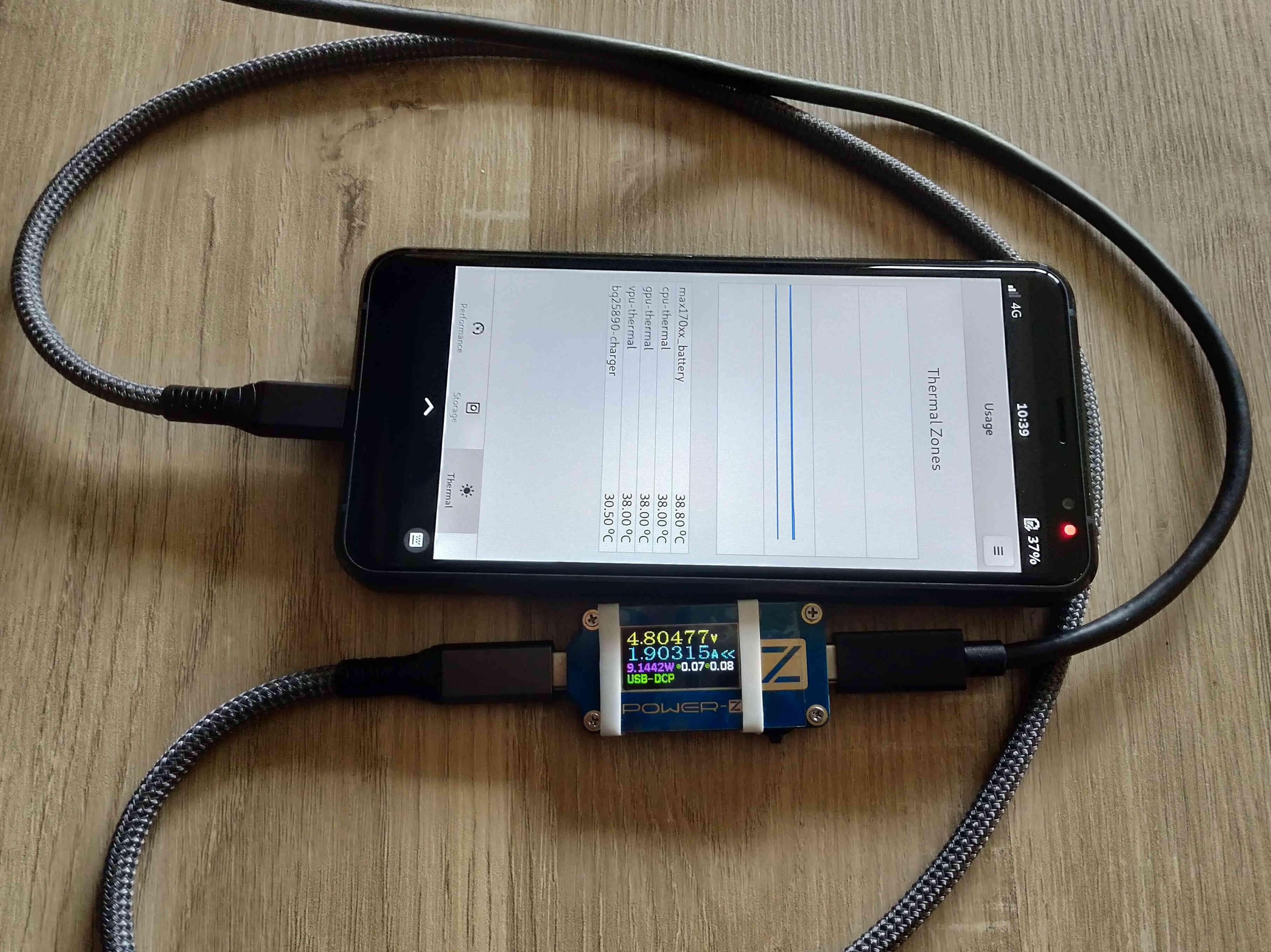

EDIT III: @amosbatto, as somehow “explained” above here is picture showing that charging current (amperage) can be decreased (relating to the same power supply in usage):

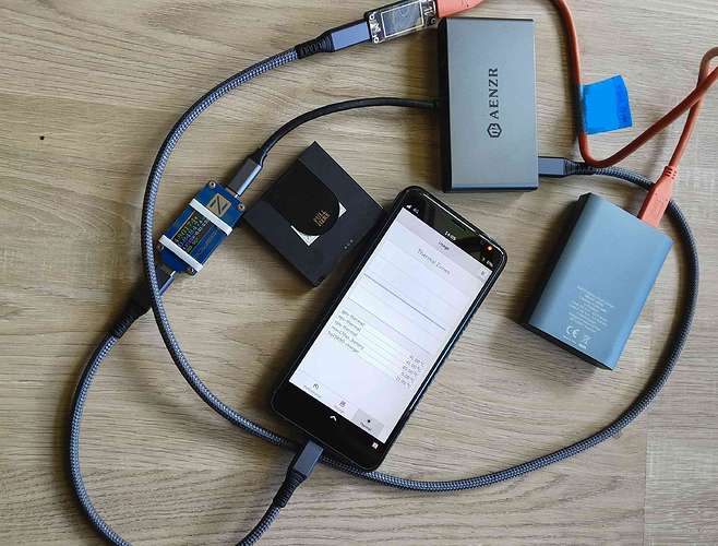

EDIT IV: Concluding here with my main reference numbers (when screen on, the way I like to see things when charging my Librem 5, as and when charging it for real, directly from my favorite power supply):

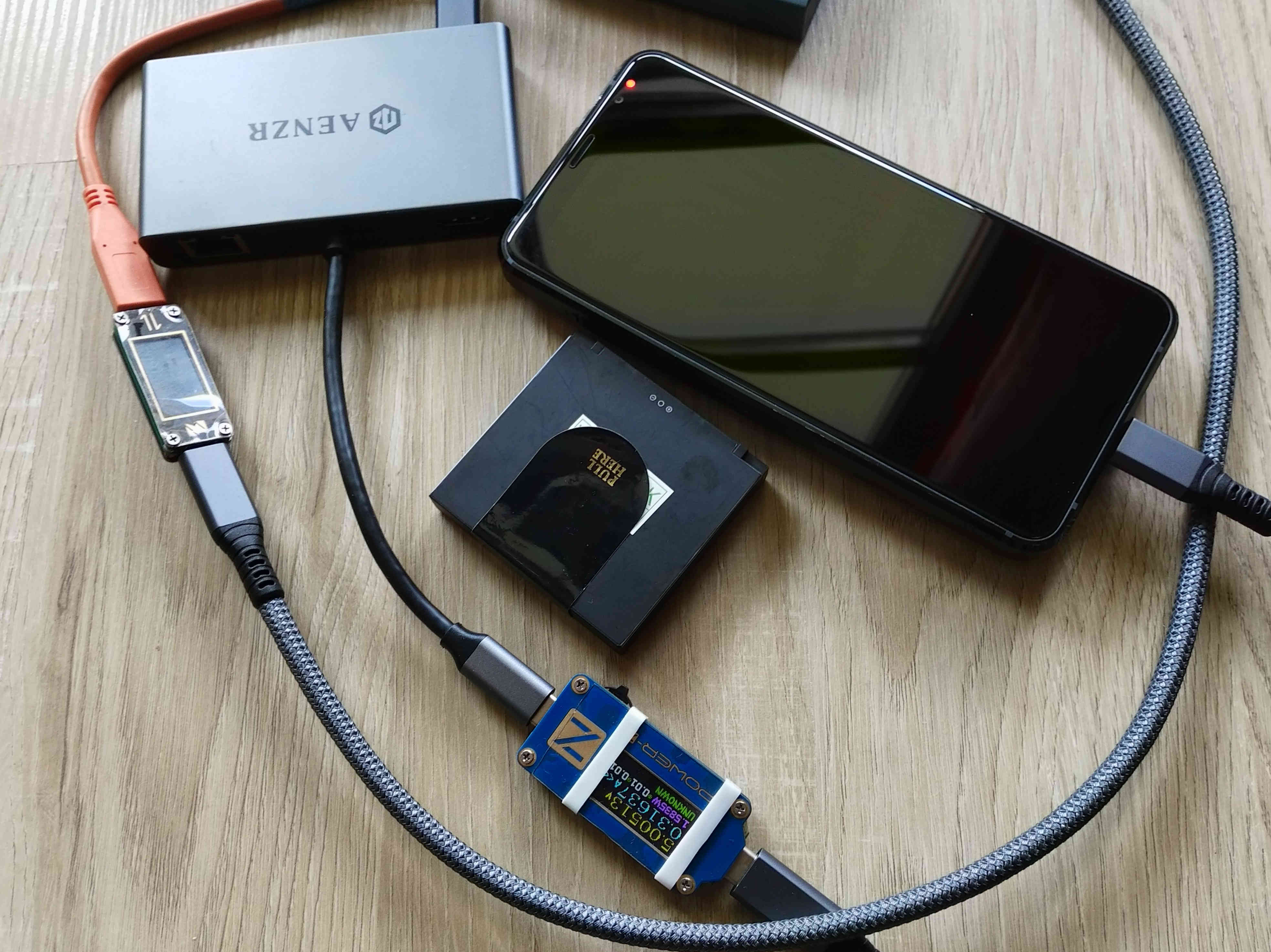

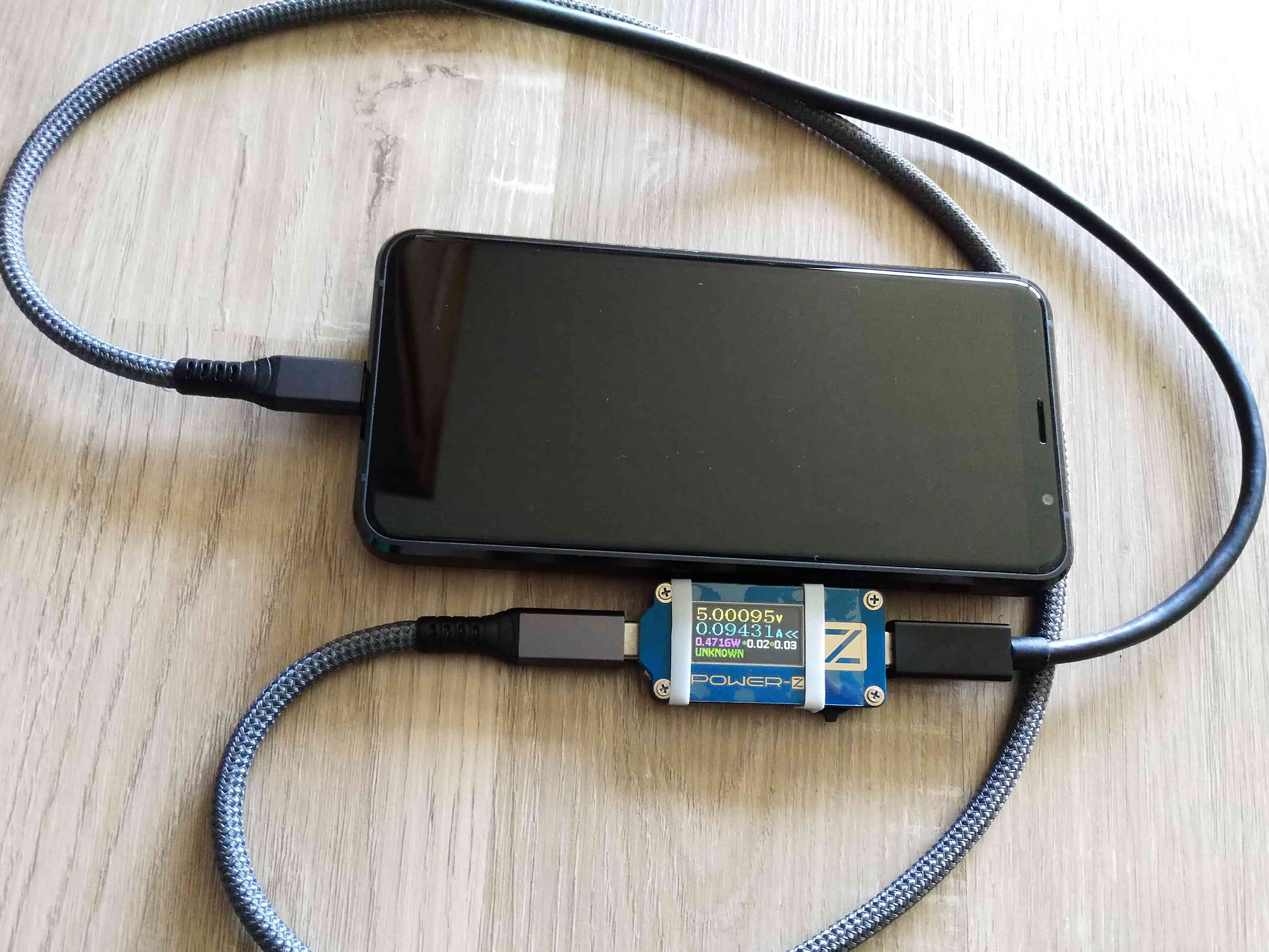

After few hours used PD power supply have gotten there (as mentioned above), reaching 5.00V (with Librem 5 turned off and battery calibrated full at 4.20V, it was just about right time to disconnect used charging cables):
