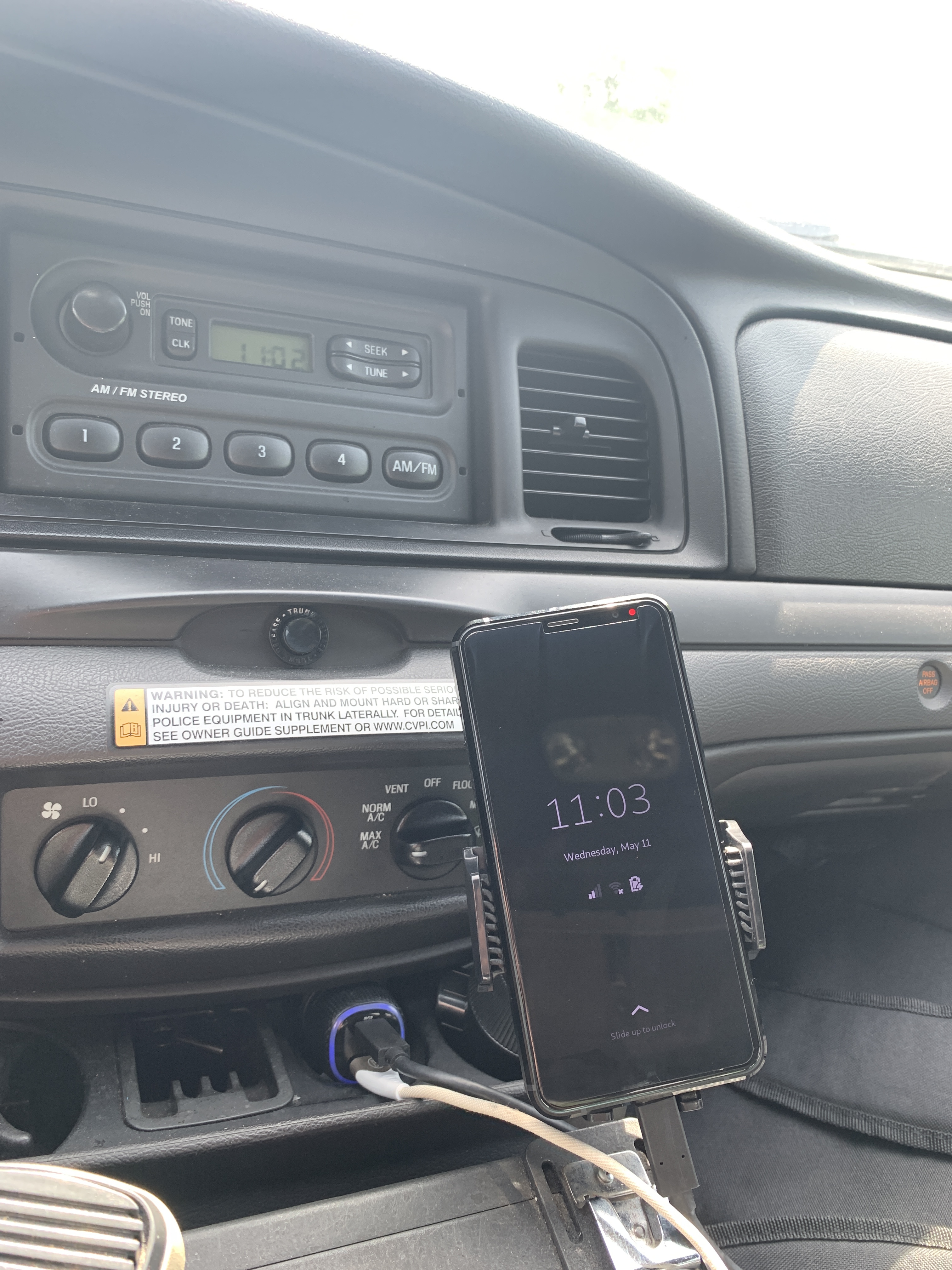

As far as charging, this car charger was recommended to me by another member of the forum. Does really well in providing a quick charge. Thankfully, I spend most of my work day in a vehicle, so I’m never too far from a charger.
Alogic CRCA57 45W 2-Port USB-A Phone Car Charger

I have not experienced any overheating issues in regards to that charger, but I do keep it next to the AC vent. My only overheating issues have come from it staying in my pocket while outside in the sun. I have to turn it off it gets so hot.

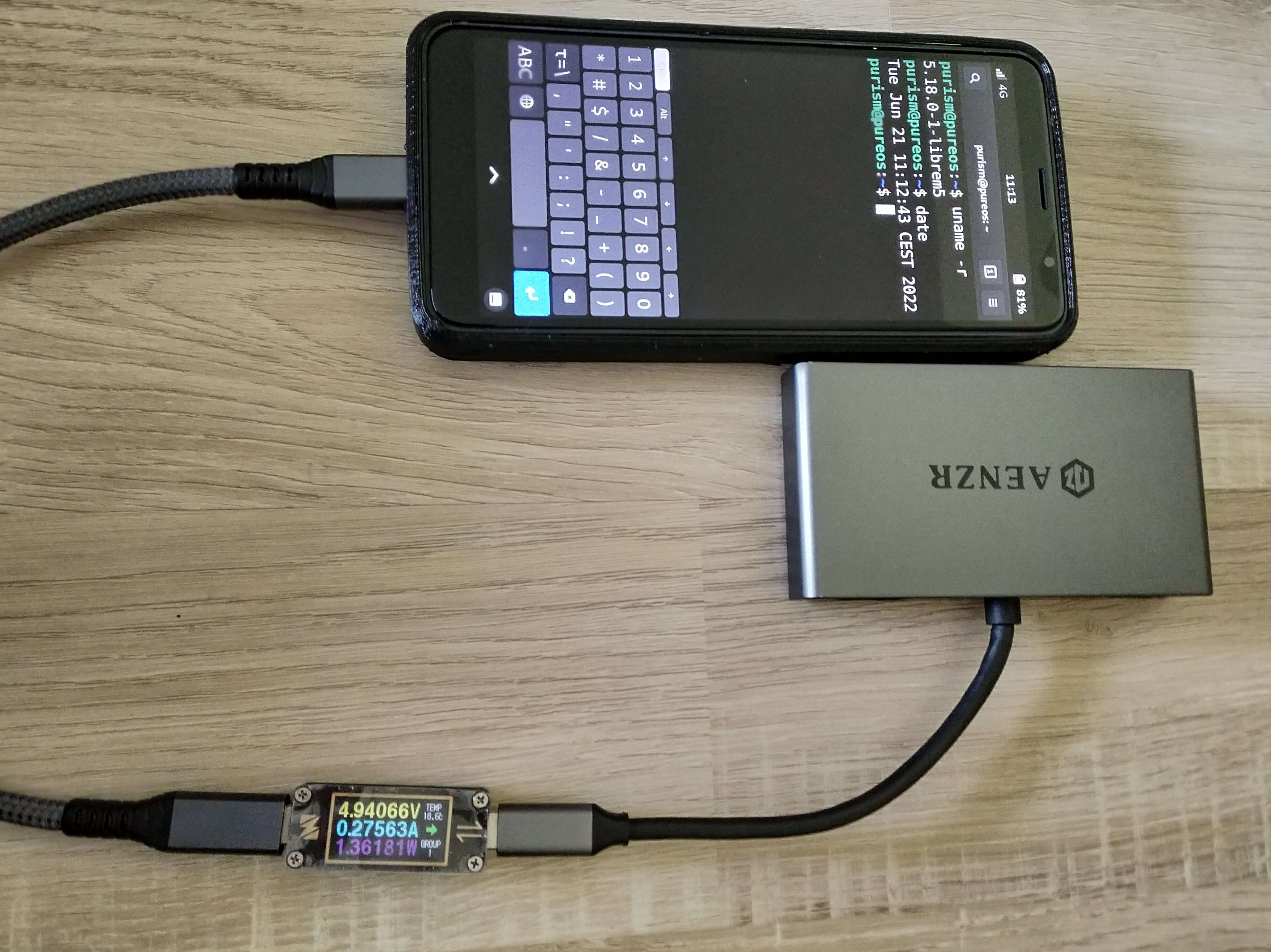

Do you have a link to the forum discussing this dock, or the specific dock that you purchased? I bought an Anker 655 8-in-1 hub. Because it consumed 15 W, I asked anker support for charger advice, and they suggested their Anker 713 45W charger. I’ve had mixed results, however. Sometimes I don’t get a charge to the phone through the dock I have, even with the powerful charging brick.

This post is where I found info on various docking stations. Upon further testing with a higher wattage charger it doesn’t seem to charge while docked.

I tried with a Lenovo 65W charging brick and guess what. At 5V it delivers only 10W making it worse than a 15W smartphone charger.

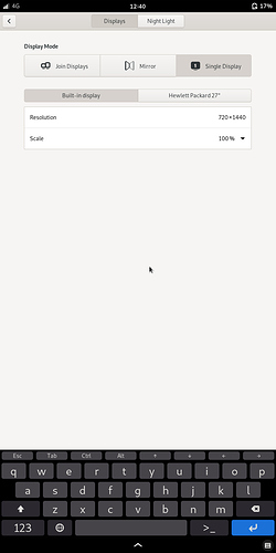

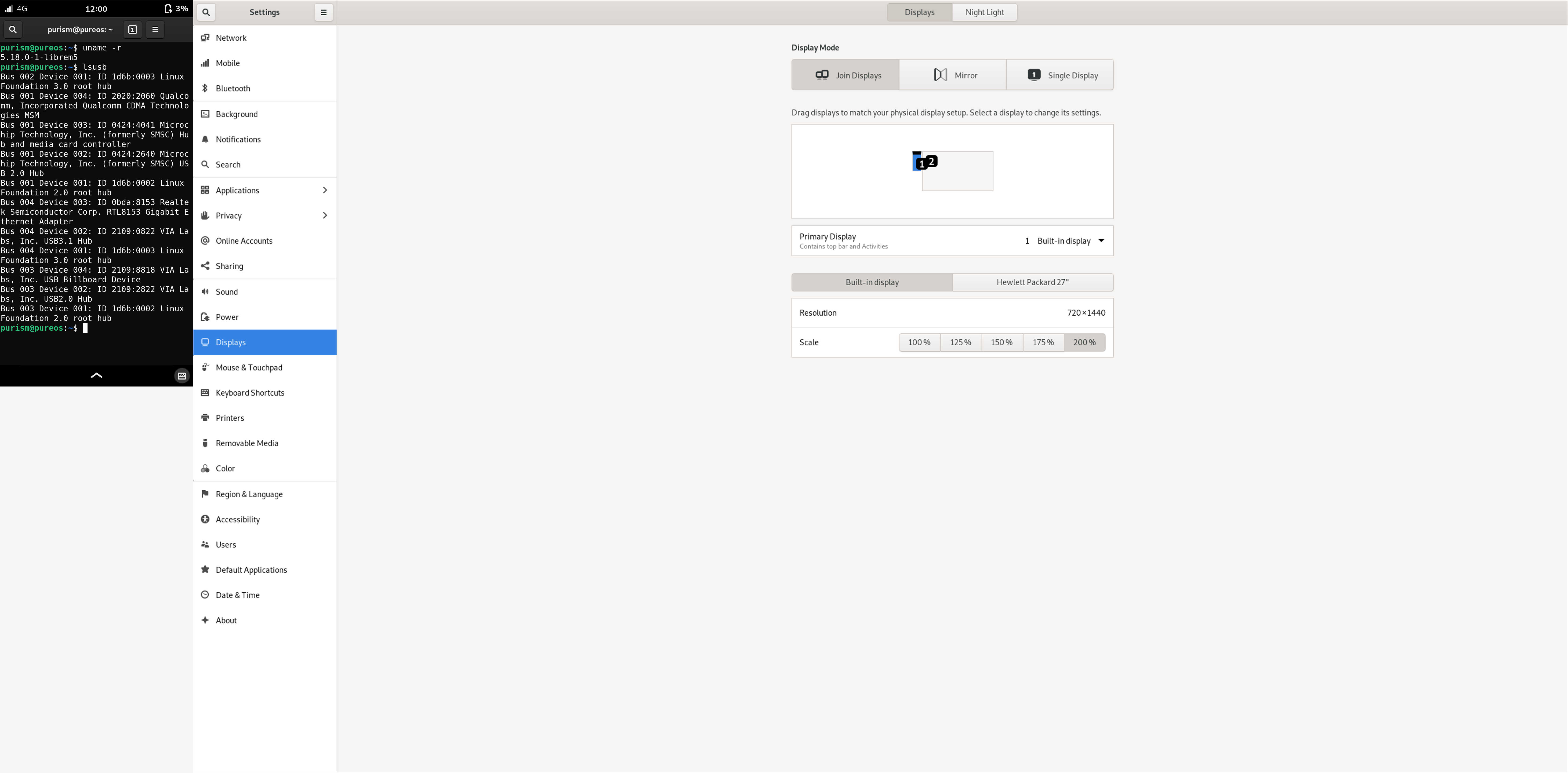

The phone dock question is really interesting. With a Lenovo notebook docking station I got no display connected. With another no name docking station I got display, but there are interruptions in the picture from time to time.

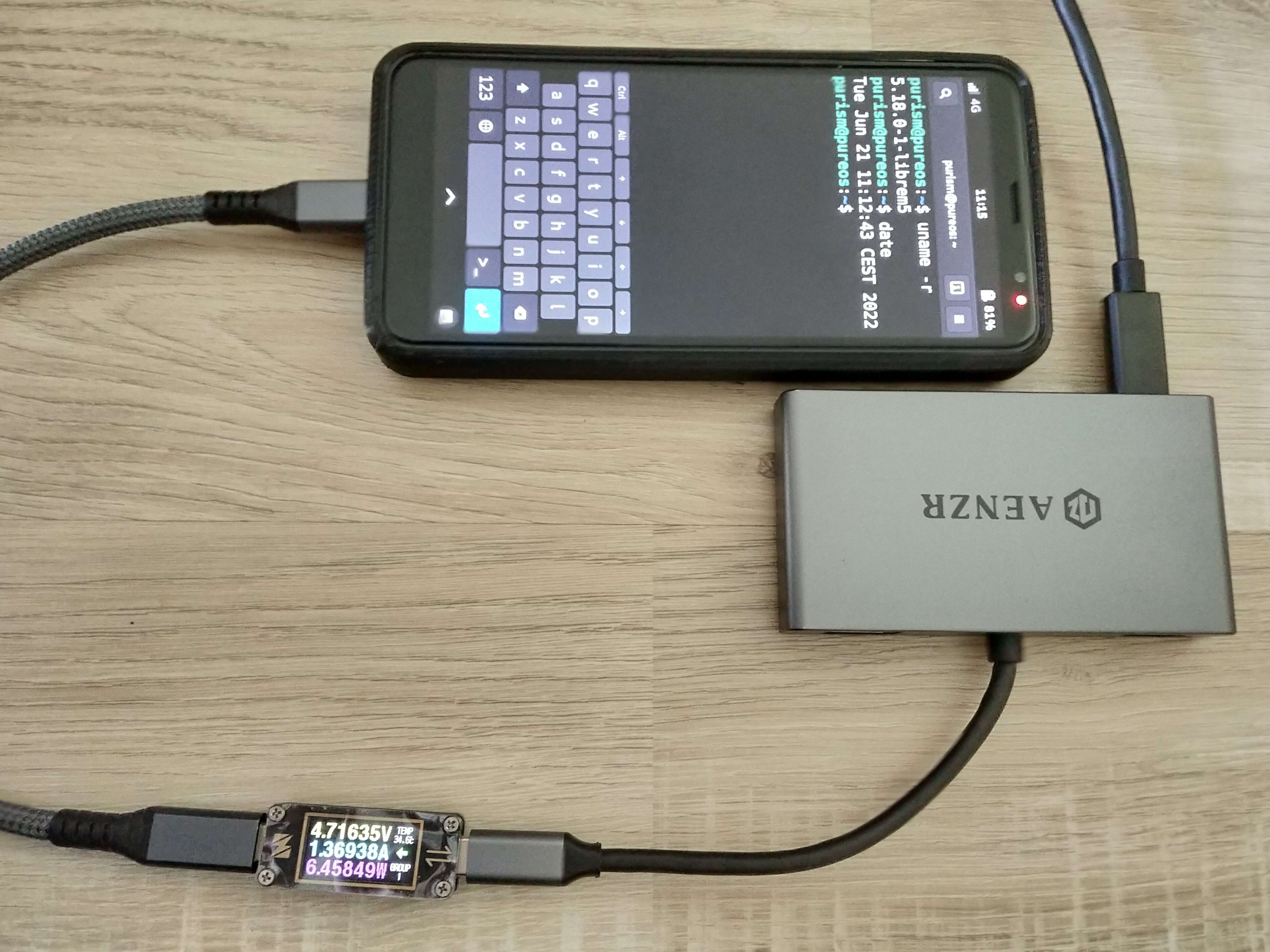

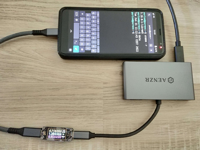

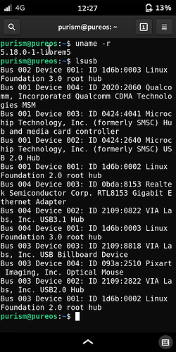

They do have three power supplies (I’m about to test two of them) but the suggested one is not on my list. In addition, small green arrow (on much smaller IPS display) explains a lot (but not everything, note that battery icon is on 81%). Anyway, please enjoy content of those two pictures:
@Hristo, perhaps you are about to buy this USB Type-C Gen2 dock AENZR AZ2406 and test it with your monitor (I’m about to use it with my Librem 5 with some other device, through this reliable Linux HDMI output port as well, but need to settle down some more, do this when more time available)? Please feel free to be able to rely on it (get it work with your monitor) and therefore here is what to expect from AENZR AZ2406 device:
EDIT: VL103R+PS186+VL822+RTL8153

I don’t understand why do you recommend the AENZR if in your tests it delivers only about 1,5A at 5V to Librem 5?
Shouldn’t we look for docking stations that deliver 5V 3A?
