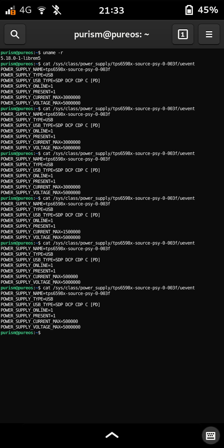

So if you have the Lenovo power supply and you have a docking station, why not just connect it up and ask the Librem 5 what it is getting? With the supplied charger, the Librem 5 reports PD negotiation of 5V 3A max.
So I should run
sudo cat /sys/class/power_supply/max170xx_battery/uevent

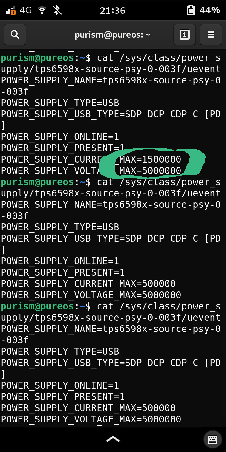

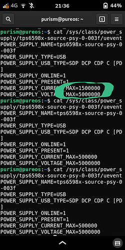

As third Iâm already very tired for today but needed to post at least above screenshot (Ă2):
- SB-AC16-TCUS, USB-PD Type-C 5.0V/3.0A, 15W, DCP based power supply, directly charging L5;
- Anker A2029, USB-PD Type-C, 60W, DCP based power supply, directly charging L5;
- PD-014, USB-PD Type-C, 18W, distributed power supply, directly charging L5;
- AENZR AZ2406, getting power from SB-AC16-TCUS (15W) power pass-through toward L5, all good (post #15 in this thread);
- AENZR AZ2406, getting power from Anker A2029 (60W), power pass-through toward L5 is not usable 0.4790A (not good at all);
- AENZR AZ2406, getting power from PD-014 (18W), power pass-through toward L5 is not usable 0.4790A (not good at all).
Yes, 5. and 6. are having red LED light on but in terms of L5 battery actually meaningless (IMO). Yet, I do think that this is a great finding anyway. Therefore thanks on both of you repeatedly! @Hristo, now is your turn again, please explain what you actually discovered for all of us here (relating to your recent posts). My hint would be: 1500000 (marked green within second screenshot above):
