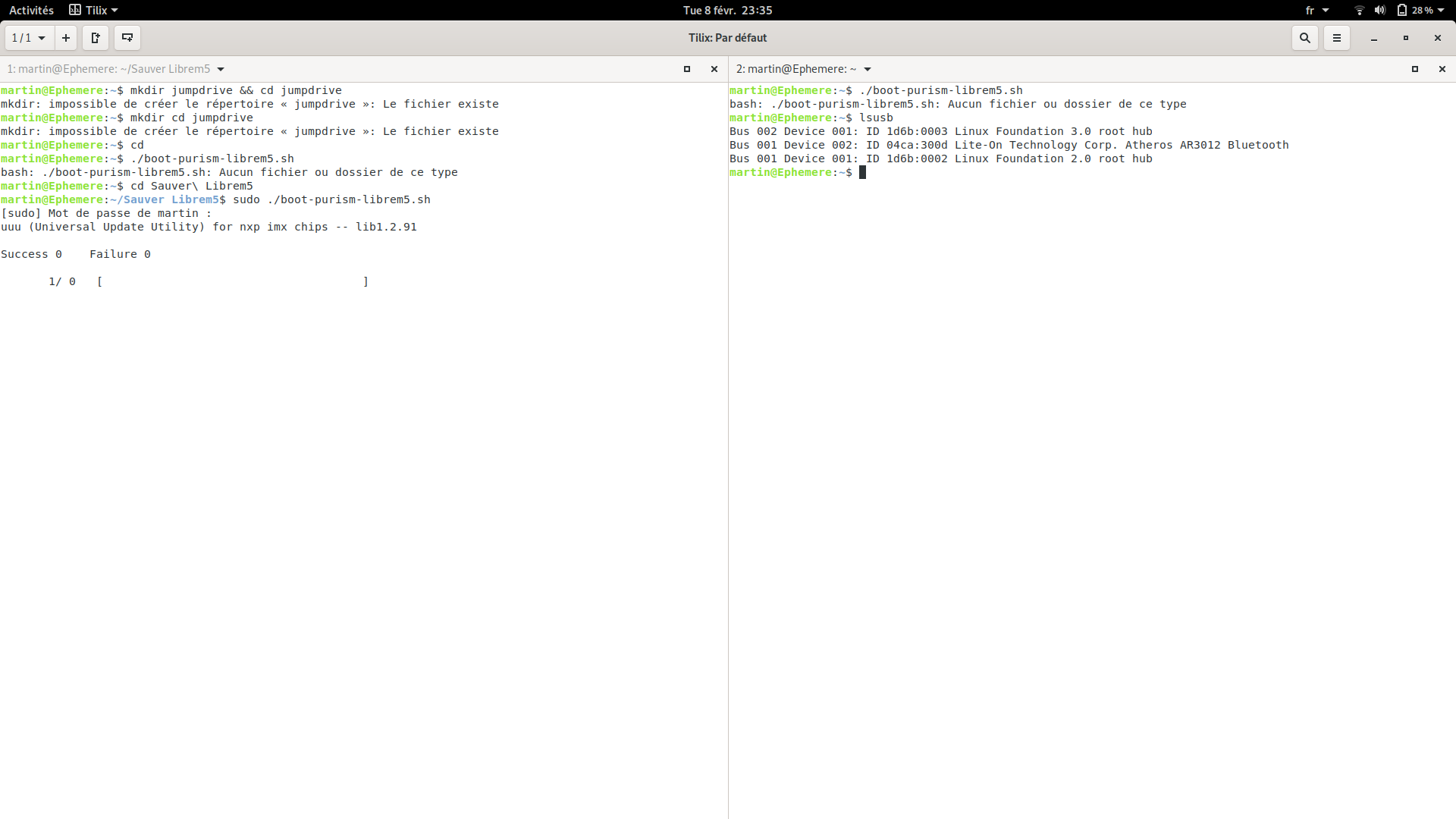

I am a noob. I need to know clearly what I must do to recover all my phone number and all my appointements… my Librem 5. I still can’t do anything. My terminal say that he don’t detect any folder of that type after I try to run the scrip /boot-purism-librem5.sh
martin@Ephemere:~$ lsusb
Bus 002 Device 001: ID 1d6b:0003 Linux Foundation 3.0 root hub
Bus 001 Device 002: ID 04ca:300d Lite-On Technology Corp. Atheros AR3012 Bluetooth
Bus 001 Device 001: ID 1d6b:0002 Linux Foundation 2.0 root hub
martin@Ephemere:~$ /boot-purism-librem5.sh
bash: /boot-purism-librem5.sh: Aucun fichier ou dossier de ce type
martin@Ephemere:~$
You are missing the . at the beginning of the command - but also you may need the sudo (can’t hurt anyway, in this case):
sudo ./boot-purism-librem5.sh
is what you need to type at that point in the process.
Thanks to help me but… terminal say that :
martin@Ephemere:~$ ./boot-purism-librem5.sh
bash: ./boot-purism-librem5.sh: Aucun fichier ou dossier de ce type
martin@Ephemere:~$ sudo ./boot-purism-librem5.sh
sudo: ./boot-purism-librem5.sh : commande introuvable
martin@Ephemere:~$
Here some print screen of what I have done before. Does my folder are correctly unpack and save in a good place?
No.
Assuming that you start in your home directory, then you should have a directory jumpdrive in your home directory (and you cd to that directory) and into that directory you would download the .tar.xz file and then you unpack the .tar.xz file into that same directory.
You’ve created an extra directory (which is probably OK) and jumpdrive within that but everything else has ended up at the same level as jumpdrive and jumpdrive itself is empty.
Still, OK, you can probably make it work.
cd
cd Sauver\ Librem5
cd? How I ask to terminal to write « cd » in blue color?
martin@Ephemere:~$ cd Sauver\ Librem5
martin@Ephemere:~/Sauver Librem5$ sudo ./boot-purism-librem5.sh
[sudo] Mot de passe de martin :
uuu (Universal Update Utility) for nxp imx chips – lib1.2.91
Success 0 Failure 0
   1/ 0   [
The colour is not important. It is an artifact of the forum software being used. (Yes, it annoys me too but …) Ignore the colours.
You do have your Librem 5 plugged in to a USB port on the x86 host computer (and with the Librem 5 in serial download mode)?
Scroll all the way back to post #14 (the detailed procedure). In step 6 it says lsusb should output
001 Device 106: ID 1fc9:012b NXP Semiconductors i.MX 8M Dual/8M QuadLite/8M Quad Serial Downloader
(although the first part - the bus and device numbers - 001 Device 106 - may differ on your host computer - the rest of the output should be as shown)
Librem 5 in serial download mode? I have made all the steps I think. And plug the librem5 holding the volume up and place the battery after… But you can see what the terminal say… :confused:
