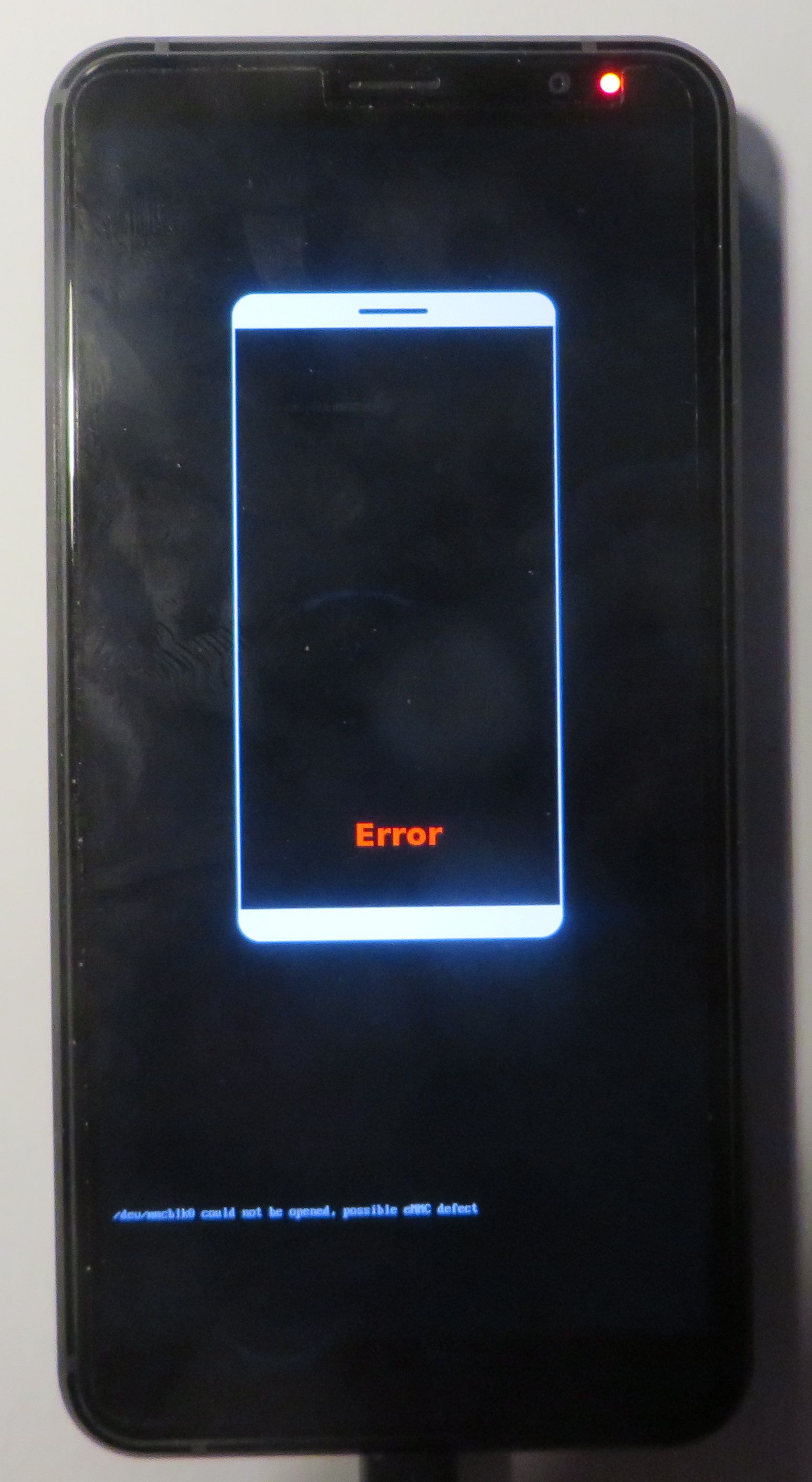

After installing uuu, here’s what happened.
jumpdrive# ./boot-purism-librem5.sh
uuu (Universal Update Utility) for nxp imx chips – lib1.4.77
Success 1 Failure 0
2:1 3/ 3 [=================100%=================] SDPV: jump
3:1 10/10 [Done ] FB: Done
No device on the PC, but on the Librem 5 the image of the smartphone profile with the word error in red. And on the bottom: “/dev/mmcblk0 could not be opened, possible eMMc defect”.
So I unplugged the USB cable and magically the Librem 5 came back on and I was able to log in again. Now I will go to the boot directory and continue with the deletion and renaming. To turn the librem back on I have to use volume-up.
