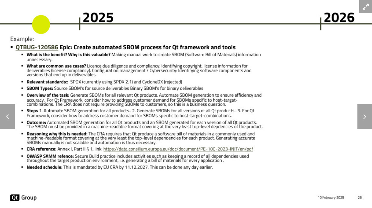

[edit to add: the following image is a screenshot from Qt presentation on how they are working on this (timeline and all) and another about what requirements there are to work on this]

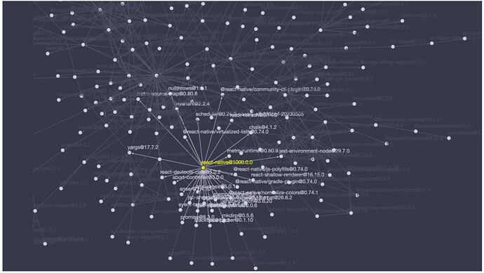

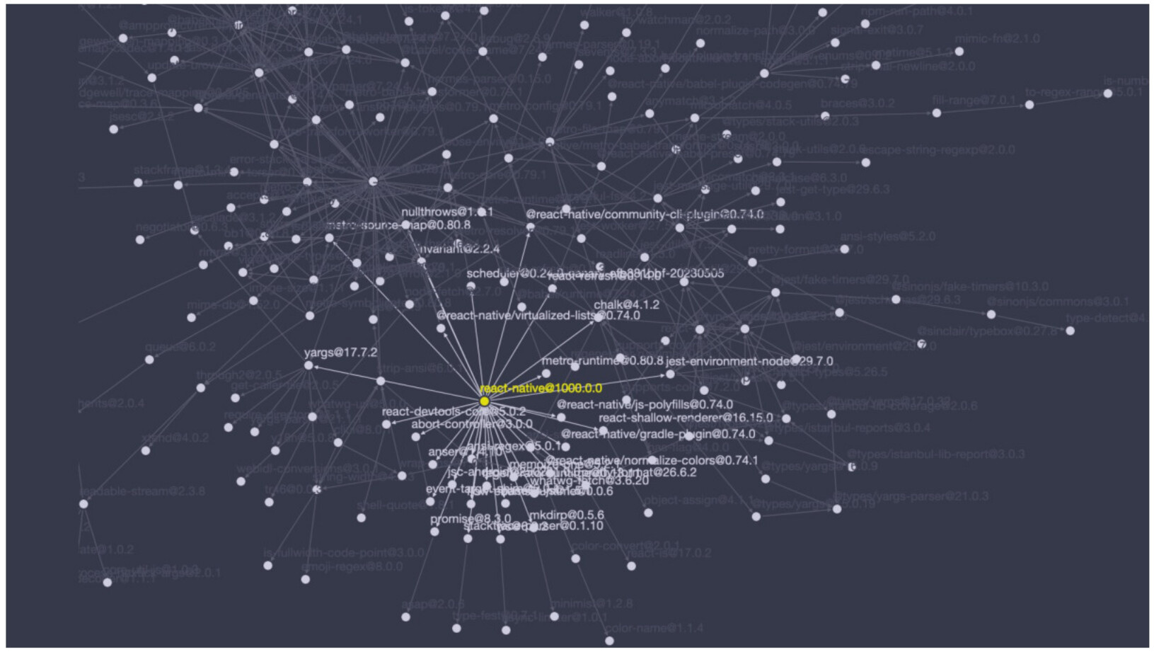

[edit to add: A separate example image of what a modern software looks as graph of components and their versions - reactjs - at one point in time - and SBOM helps to see these links to components which may have vulnerabilities (or be outright malicious/not-private)]

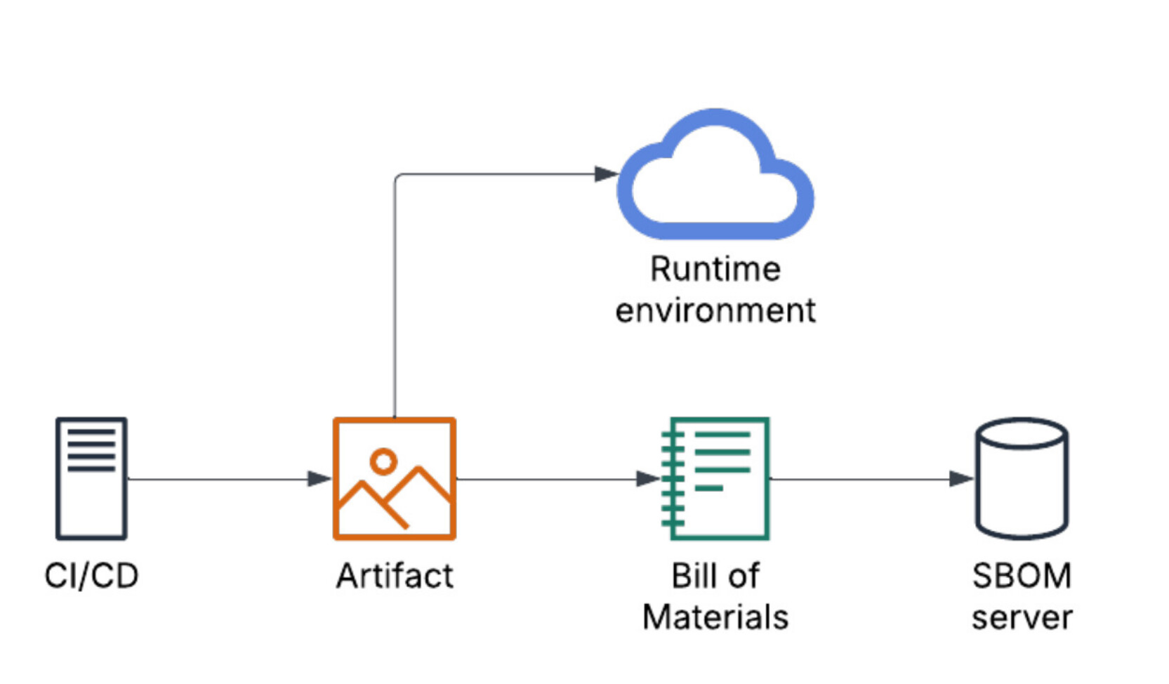

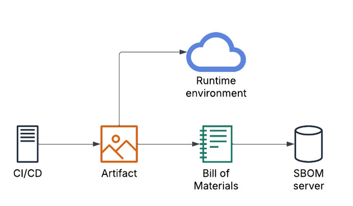

[edit to add: example image]
