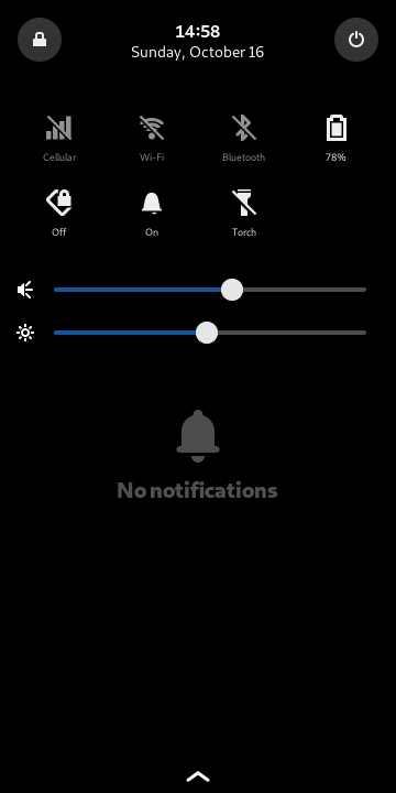

All of these still result in the “Cellular” icon being disabled and no PIN being asked.

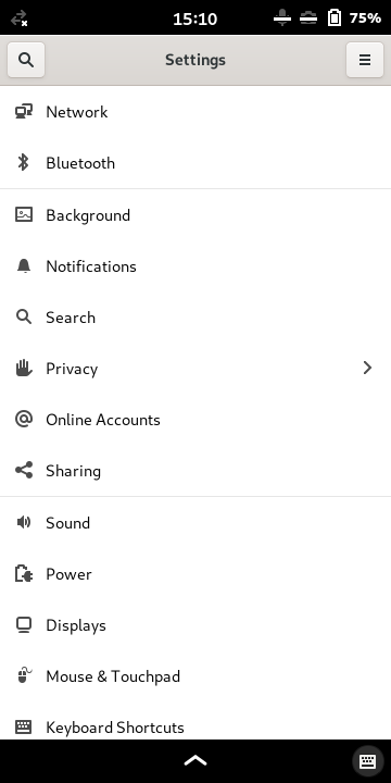

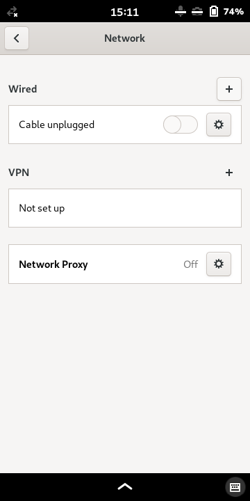

As you can see in my screenshots, I don’t have a “Mobile network”.

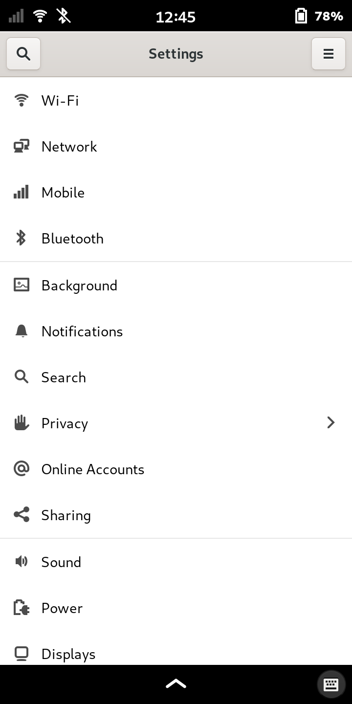

About the mobile option, you have to go the the Settings app, then you can see a Mobile menu, this is where you can fin the APN settings. I can’t screenshot because my L5 is not closed to me, I am sorry
Also, just a reminder - please don’t do that. As noted in the quick start guide, you should remove the SIM tray only when the phone is off.
If, for example, the modem killswitch is activated, then you will not see “Wi-Fi” or “Mobile” in the Settings.

Yep, I don’t see that. Please refer to my screenshots in this thread that were taken with the killswitch off.
