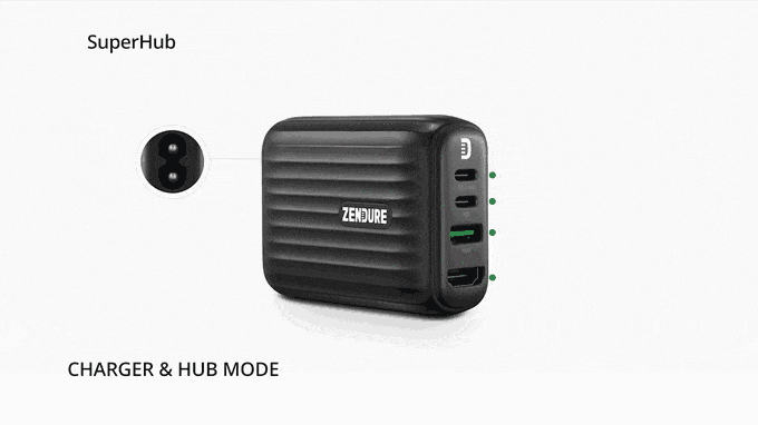

I’m usually carrying a power bank (Mazer EnerG Duo 10C) when expecting to be outside for > 6h (the Evergreen battery lasts longer than that but this leaves me enough safety margin) and a Zendure Super Hub when travelling (instead of a charger) as it has a long connector cable to the hub so I can use about any power socket location and allows me to plug in a HDMI screen, TV or projector (used for giving presentations (e.g. Debconf, FroSCon). When using it as Laptop replacement (e.g. on shorter train rides) I use a Nexdock 360 (but the would like to switch to s.th. with a better touchpad).

Sure, but it is some kind of “direct” approach (both charging and video function well over C1 port, but this is already tested/recommended anyway). Yet it is still like no other (and probably not even available any more) hub:
Wait, I recall now that received message from someone kindly sharing with me that original Steam Deck power supply is charging Librem 5 without any issues. And therefore, as somehow to your question related, let us consider that this hub might be usable as well: https://www.aliexpress.com/item/1005004587864613.html.
P.S. Looks like I’m out of this thread topic here?
Very interesting. Thank you!
Regarding charging: see https://source.puri.sm/Librem5/firmware-tps6598x-nonfree/-/blob/master/dp-alt-mode-adapters.org , regarding flickering: I don’t have that with any adapter I use. The videos linked above were redorded with the zendure hub (this is not a buying recommendation, just what I use).
Do you have an idea what could be the source of flickering?
I have experienced it with different USB-C docks, with 2 different HDMI-HDMI cables and with 2 different monitors.
My assumption was that the source of the problem are the USB-C docks, but if other people don’t experience it, then it might be the Librem 5.
The video signal works. But every several minutes short disruptions happen.

All PD chargers I happen to own are charging Librem 5 without any issues (Steam Deck, Nintendo Switch, Dell XPS 13, some generic 45W charger, several USB-C docks…). Issues only happen when the power supply doesn’t provide enough current at 5V, but according to PD specification every >=15W charger is supposed to provide 3A at 5V. In practice it’s rather docks that can actually be problematic, as quality of those varies a lot and some are outright misconfigured, in which case it’s mostly a matter of luck whether it negotiates something sensible.
