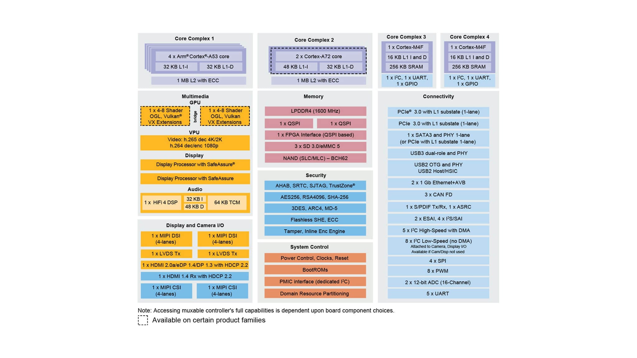

I think it would also be interesting if “i.MX8M Quad 14nm” supports AES. That could also improve the performance of the phone in general when using some kind of fde or encryption in general.
Apart from that more RAM is always good as @2disbetter said for a full desktop replacement
Disk space hm… we have a 2 TB SD-Card slot - why would we bother? :wink:
The existing i.MX8M should already support AES.
I would be glad if you can prove me wrong.
There is nothing here: https://www.nxp.com/docs/en/data-sheet/IMX8MDQLQCEC.pdf
There is a diagram with AES of the i.MX8 family - which does not mean that all i.MX8 have all the functionality listed in the image (https://www.nxp.com/assets/images/en/block-diagrams/IMX8-FAMILY-BD.jpg) and following the wikipedia (https://en.wikipedia.org/wiki/I.MX) AES is only part of the i.MX 8X and not part of the i.MX8 M Quad
