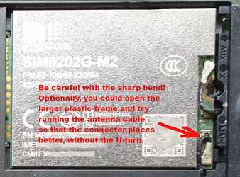

0. Physically install the modem. See some pointers for instance from the disassembly manual or video. Be careful with the antenna connectors, use ANT0 and ANT3.
Doing lsusb should show “1e0e:9001 Qualcom / Option…” somewhere in the list.
