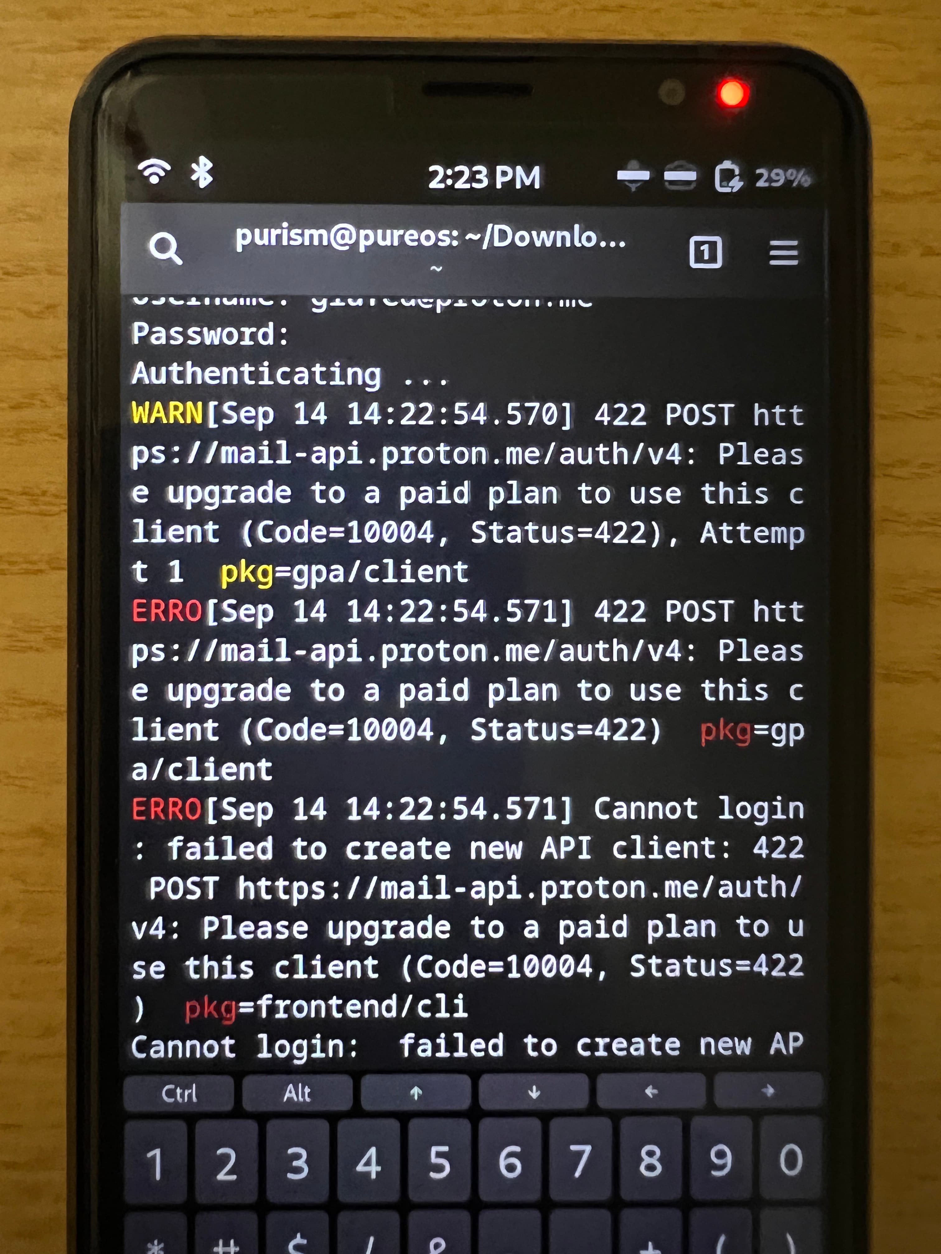

PS: after investigation I found it (please see screenshot), maybe it doesn’t work with free email account? I opened it few days ago so I’m trying the free plan before to buy a subscription! Maybe bridge is forbidden for free plan?
A paid plan with Proton Mail is required in order to make use of the proton-bridge application. I don’t think that is mentioned on the github project page but it is stated on the Proton Mail Bridge product page, of their website, and I’m sure it’s also been mentioned previously in this thread
The paid plans do include a “30-day money-back guarantee” so you could, if happy with the free plan, then upgrade to check out additional features of a paid plan and if it doesn’t meet your needs or expectations, cancel within the 30 day period (I would however, carefully read the terms and conditions to ensure that you’ll meet the 30-day money-back guarantee criteria before upgrading).
